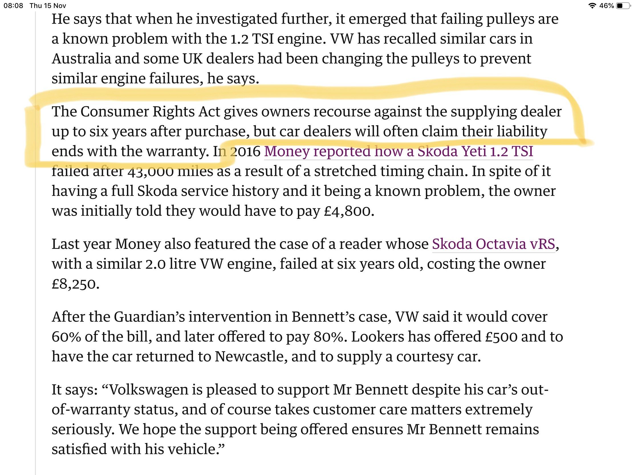

This was in the guardian about a VAG 1.2tsi (no surprise) but relevant to any manufacturer
2 weeks on and nothing from Skoda and no call back from customer service (what service?). Truly the worst car dealership /car experience I’ve ever had. Reference Oldstan, yes I believe you’re right. Social media the only resort. Check out Skoda Uk customer services Facebook page to see if they’ve deleted it today or if they’ve the integrity to leave the post there..
Posted as ‘Kate Simpson’ as I don’t use FB
Edited by Sarah18
