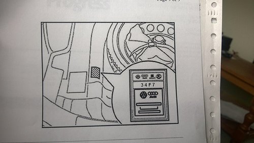

@Sarah18   Problem right there if you are being told nonsense about '34F7',
 The Mineral Oil was put in instead of Synthetic & a Software Update.   So you can not trust a word they are telling you.
It was oil type not quantity.  Because of internal corrosion and a preventative measure.  Plenty Clutch Packs failing was another issue, but the Mechtronic Issue is still their fault.  Fundamental Design, Manufacturing, Materials or Fluids / Software failings, hence they changed the DQ200 and fluid in 2013, and that went wrong as well hence '34H5' required for some DSG's.
http://autocar.co.uk/car-news/new-cars/vw-uk-why-we-dont-need-dsg-recall

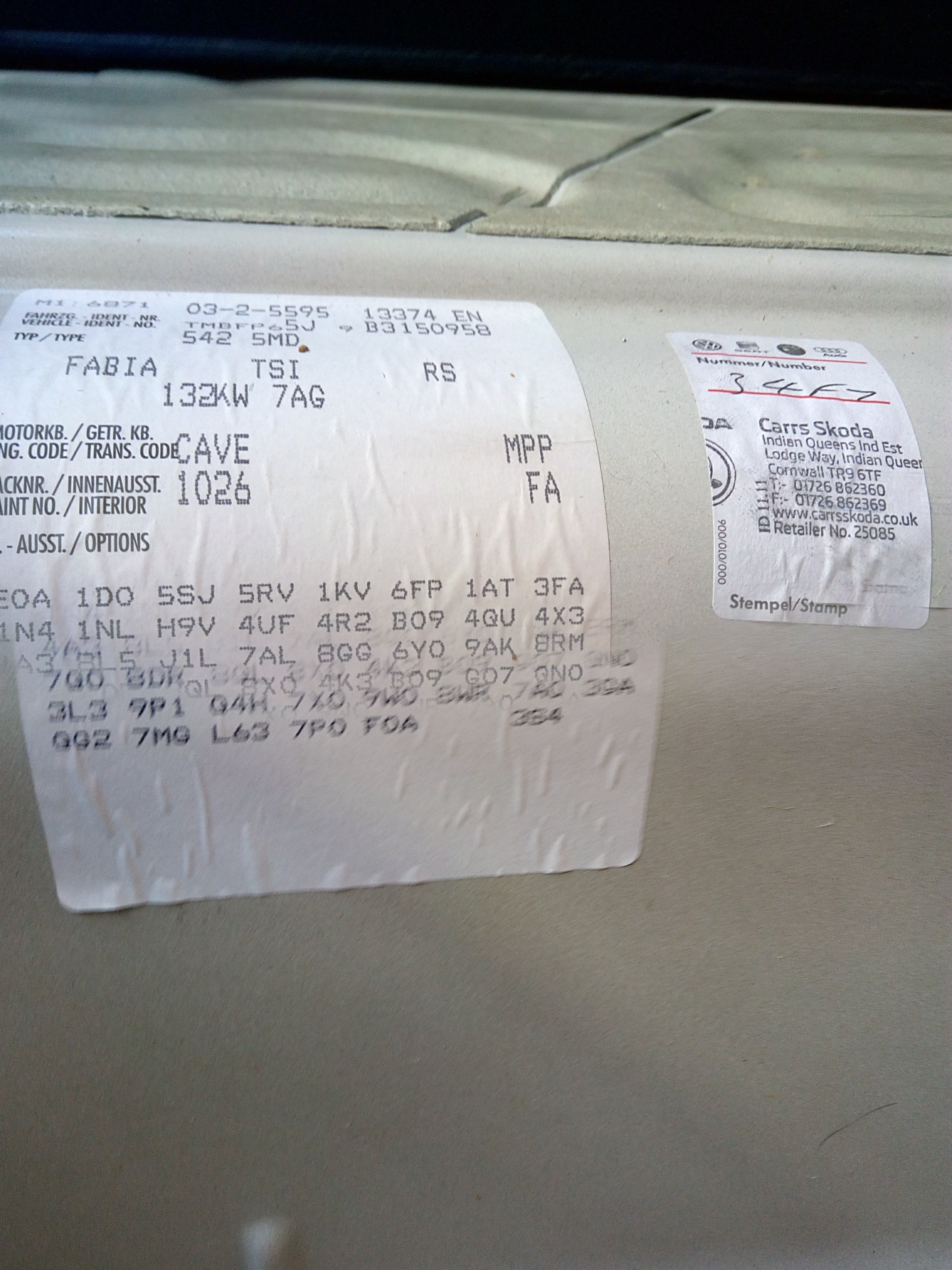

The 7 speed twin dry clutch DSG in your Yeti is a DQ200. Also used in the Superb, Octavia, Fabia, Roomster, VW's, SEAT's & Audi's under 250Nm Torque like 1.2, 1.4, 1.8 TSI's and 1.6TDI's.
'34F7' was needed on ones with Synthetic oil from the factory 2009-2013.
& '34H5' 2013-2015,  not on all though.
Many cars with DQ200's had the Service Campaign done wrongly.
http://briskoda.net/forums/topic/314923-fabia-recall
IMG_20171003_104733.jpg.7973812dd980dd31e9f629b718d24b04.jpg.386f346f8d3c28ce97708628f5ed3539.jpg
imageproxy.jpg.4614ad9ec6bcdd4ff87997e3e6bcacae.jpg.6adc5dc418523109905a3f3d414d63ac.jpg
