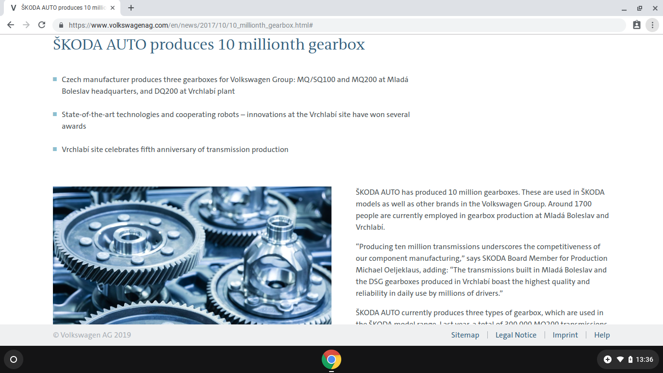

But these are not 1%, 2% or even just 5%, this is failures that even with Skoda producing 2,200 units a day for various models still are having issues in growing numbers.
There is being a fan boy / girl, and then there is just being blind to the obvious.   Fundamental issues.   Ford had to own up with the Power-Shift boxes,
VW Group are hanging on as long as they get away with the problem boxes.
Edited by Skoffski
