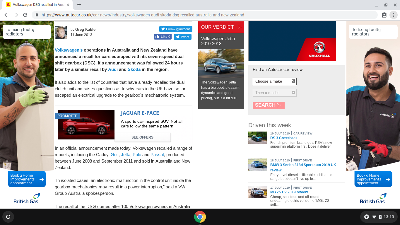

In New Zealand the 'Service Campaign' in 2012 was a Recall and all cars were to get a new MCU, and oil change and the new software.
Australia had a 'Recall'.  and there you can have Skoda / VW Australia act properly.

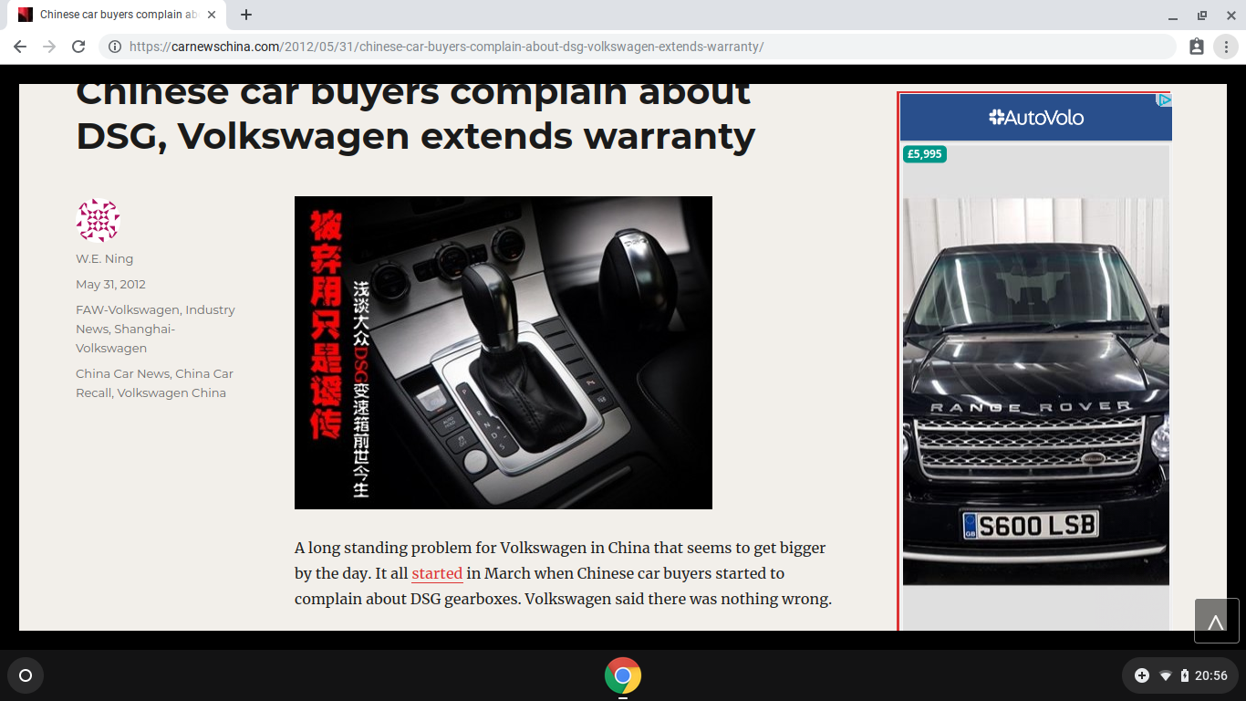

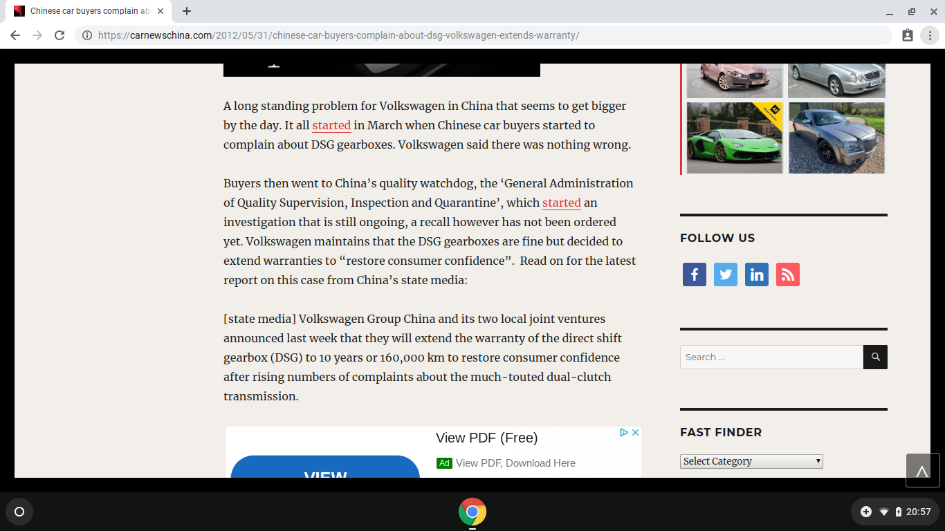

In China and some other countries there was a 'Recall' and an Extended Warranty given.

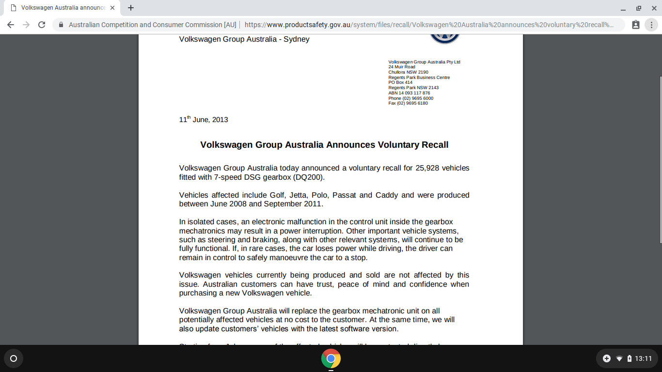

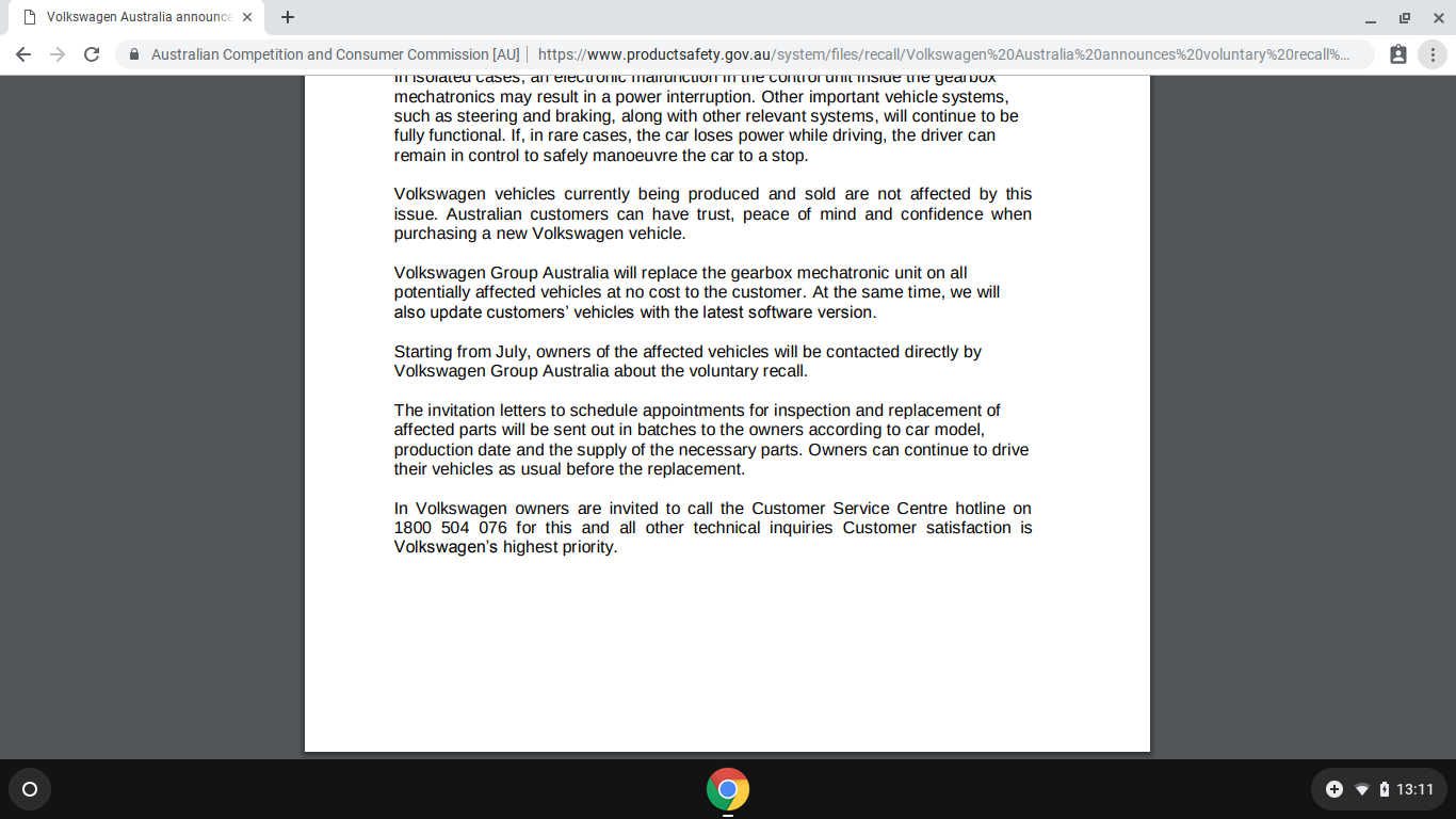

I would check an Australian Government Agency 'Recall site', VIN checker or what ever because there was a recall of DQ200's in VW's, Audi's & Skoda and i would think that included SEAT's.
As it is Skoda Australia can tell you as official Dealerships should be able to.
Duty bound to tell owners.  It was safety critical in Australia and other world regions, just not in Europe because in Europe Governments do what VW tells them they want.
