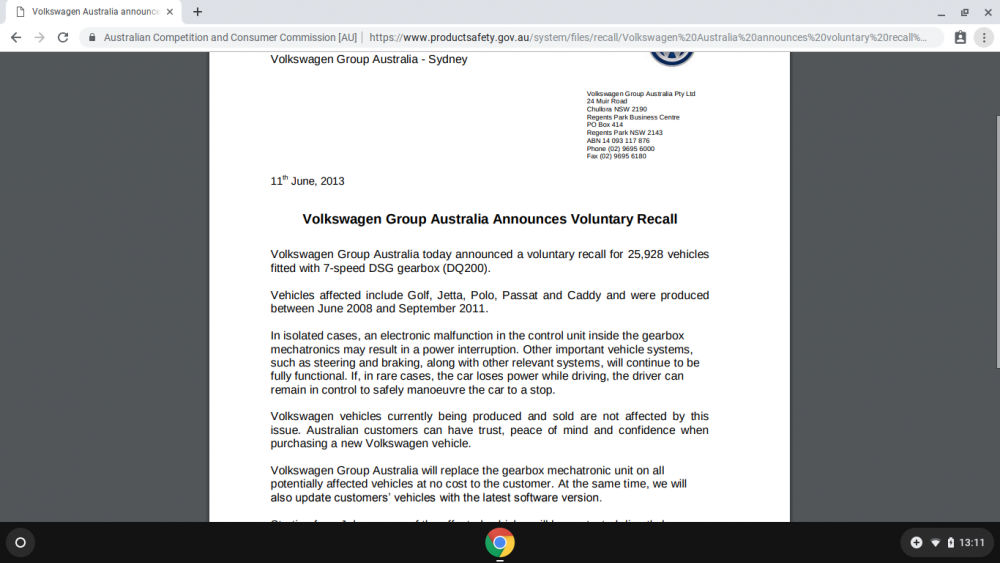

  • http://choice.com.au/transport/cars/general/articles/vw-recall-2013 The VW Australia CEO had to grovel.  Say sorry over the carry on with the likes of Fuel Injectors they had denied were an

Because carried out in 2014 or later in the UK as a 'preventative measure' under a Voluntary Recall Action that VW Group agreed with the DVSA / DfT
this really makes it an issue that VW Group / Skoda can not just wipe their hands of.

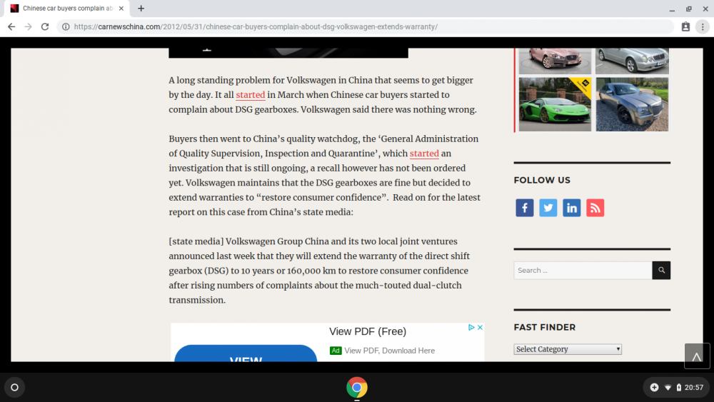

If it is just clutch packs they can be considered as consumables, but with the World Wide Recall in New Zealand where there were only a few hundred DQ200 equipped cars all got new MCU's and the time given for doing that was 4 hours.
The World Wide Recall and European Service Campaign was because of the risk of loss of drive, the issue that is happening here is the early demise of the MCU's.
VW know of this issue, and how many ECU's fail prematurely.
The Clutch Pack early demise with 'poor quality' parts was an issue as well with early Clutch Packs and strangely again later in their production.
A 10 year / 160,000 km extended warranty on DQ200's in some World Regions, the ones where courts would rip them a new one.
