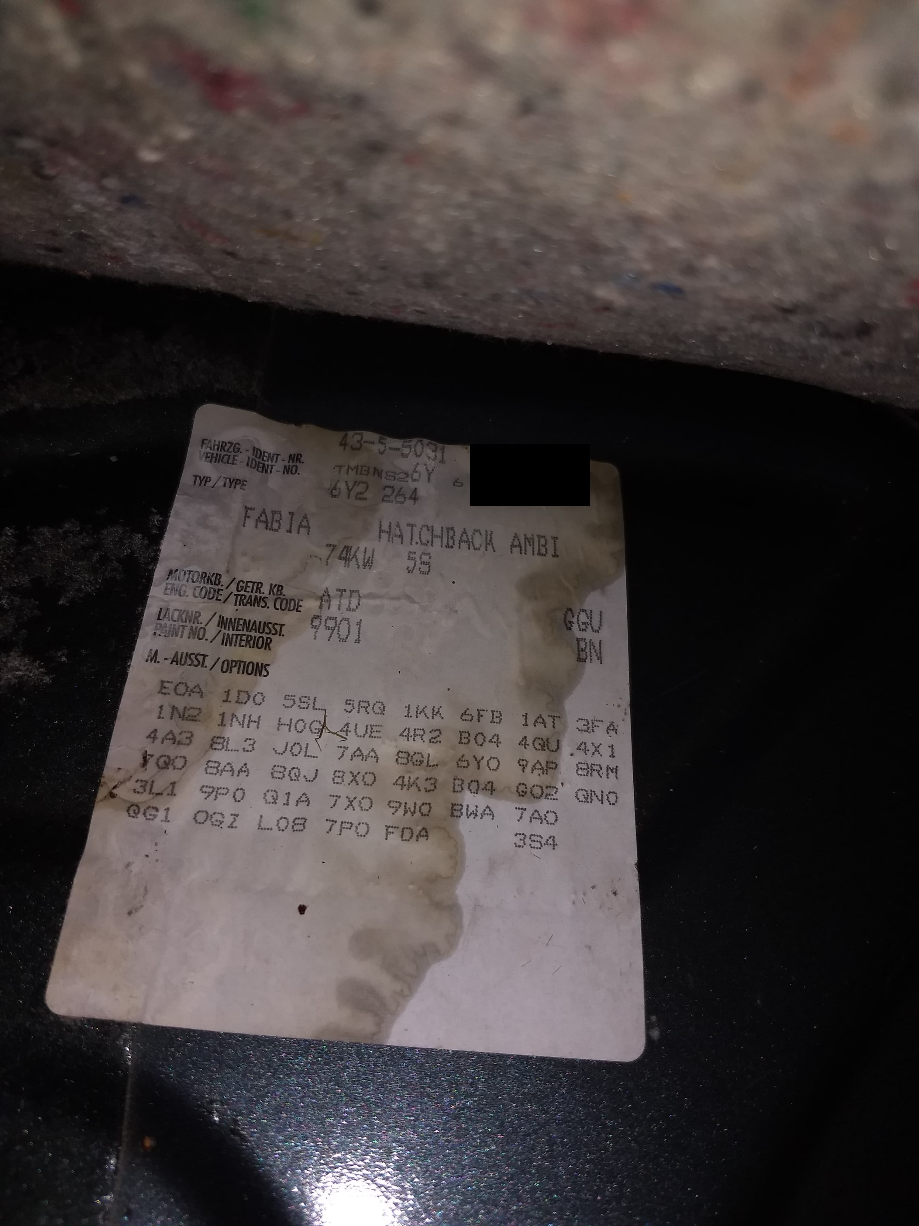

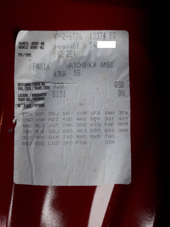

Is there an options sticker on the floor of the boot/trunk area? Or in the service book, if you have one of these to look at, the servicing code will be on there. Post a photo of the codes and we will find the right one.
Alternator may start up at higher engine revs, so may not always cause a problem, even with the wire broken.
Example of options sticker here, service code is QG0, start of last row, but yours may be different and not in the same position:
@Wino I will most definitely make a photo and post it.

@Wino so I have made a photo of the paper, now what does QG1 means?
  • Sponsor
That means you're on variable interval servicing (or at least the car was built with that set) so it will have oil temp/level sensor and brake pad wear indicator.
