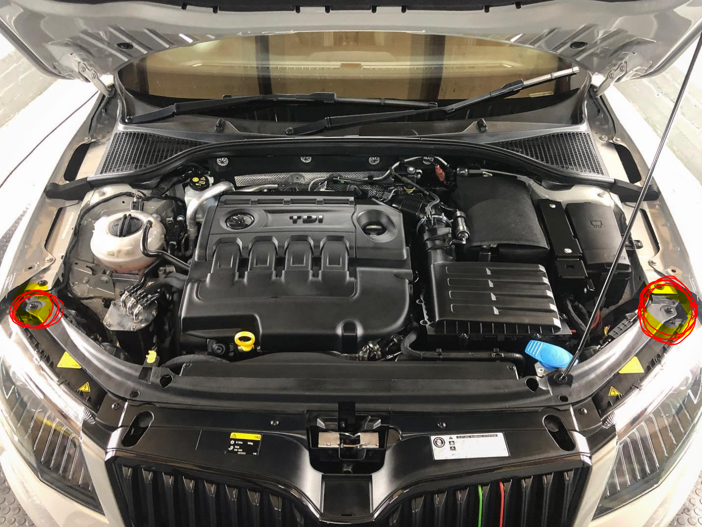

Just for reference and the avoidance of doubt, which bolts/screws do you unfasten to be able to move the headlights forward for a bit more space to work on the indicators? I can only see one big torx bolt looking at the headlights and I am not sure what size it is or if there are any other fasteners.
I tried to highlight the bolt in step 2 of my original post, but to avoid any doubt it's the torx screws shown here that allow you to move the headlamp:
Thanks. I am assuming it is a case of undo the bolts and push the headlights forward. What size of torx driver do you need? Want to make sure I have all the possibly required tools before I even attempt this.
It'll either be T25 or T30, like most other bolts on the car
