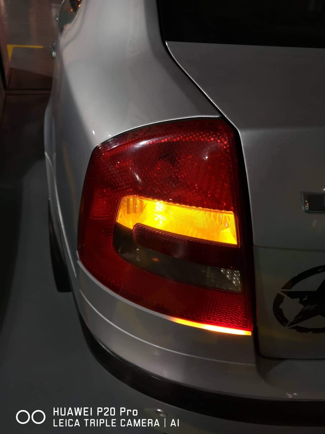

My vehicle is1Z3 Octavia MPI 1.6 2008 and I love to modify my car and make it better, so I cam with an idea for more tail light and back turn signals visibility so I bought the led tube you can see attached in the picture with 2 colors, 1 red for the break and 1 yellow for the signal and the yellow one is sequence light type same like Lexus and some advanced car.
I connect both to my tail light and the red one works perfectly however the yellow one as you can see in the picture work only partially and would work fully only if I break with it.
So far I'm not able to identify the reason to fix so here we are, maybe anybody here can help me out.

They are not canbus friendly for sure however it doesn't really matter because I took a line from the original bulbs and I didn't disconnect the original ones therefore there is no error showing in my dashboard and the lights are working normally.

I tried them directly on the battery and they work fine so faulty is out of the table.
