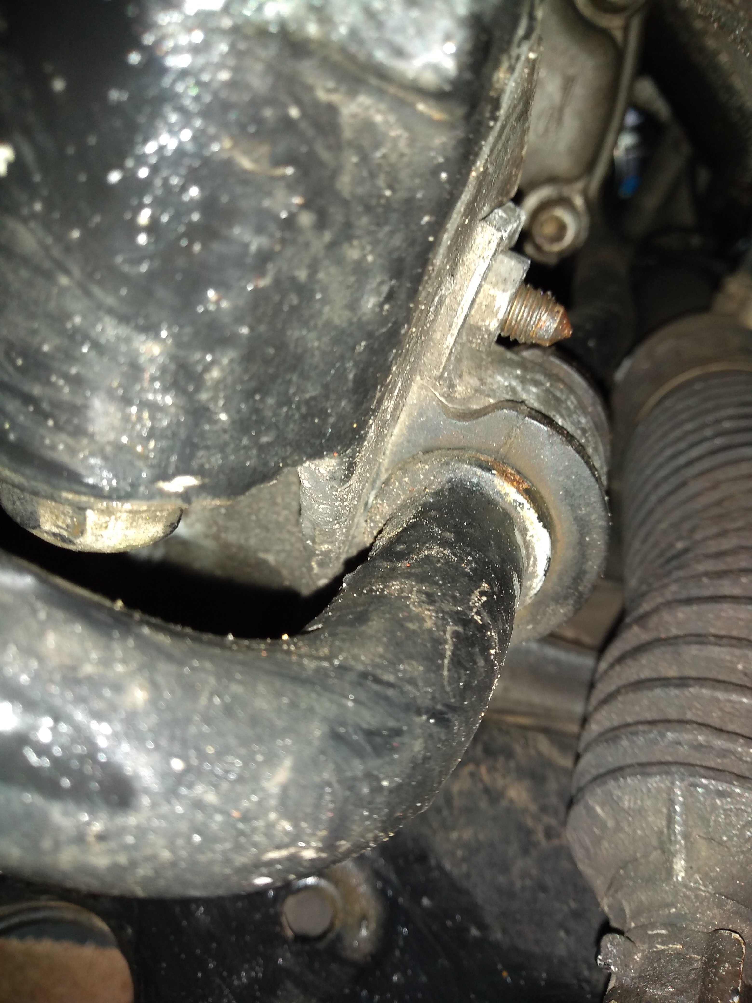

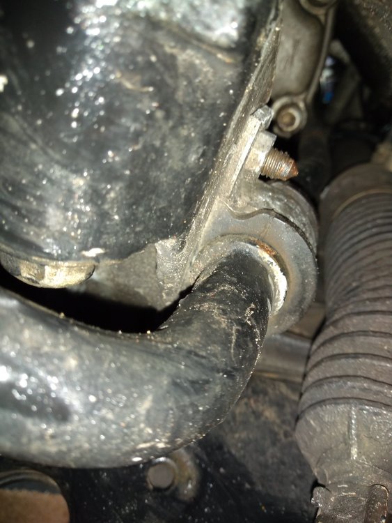

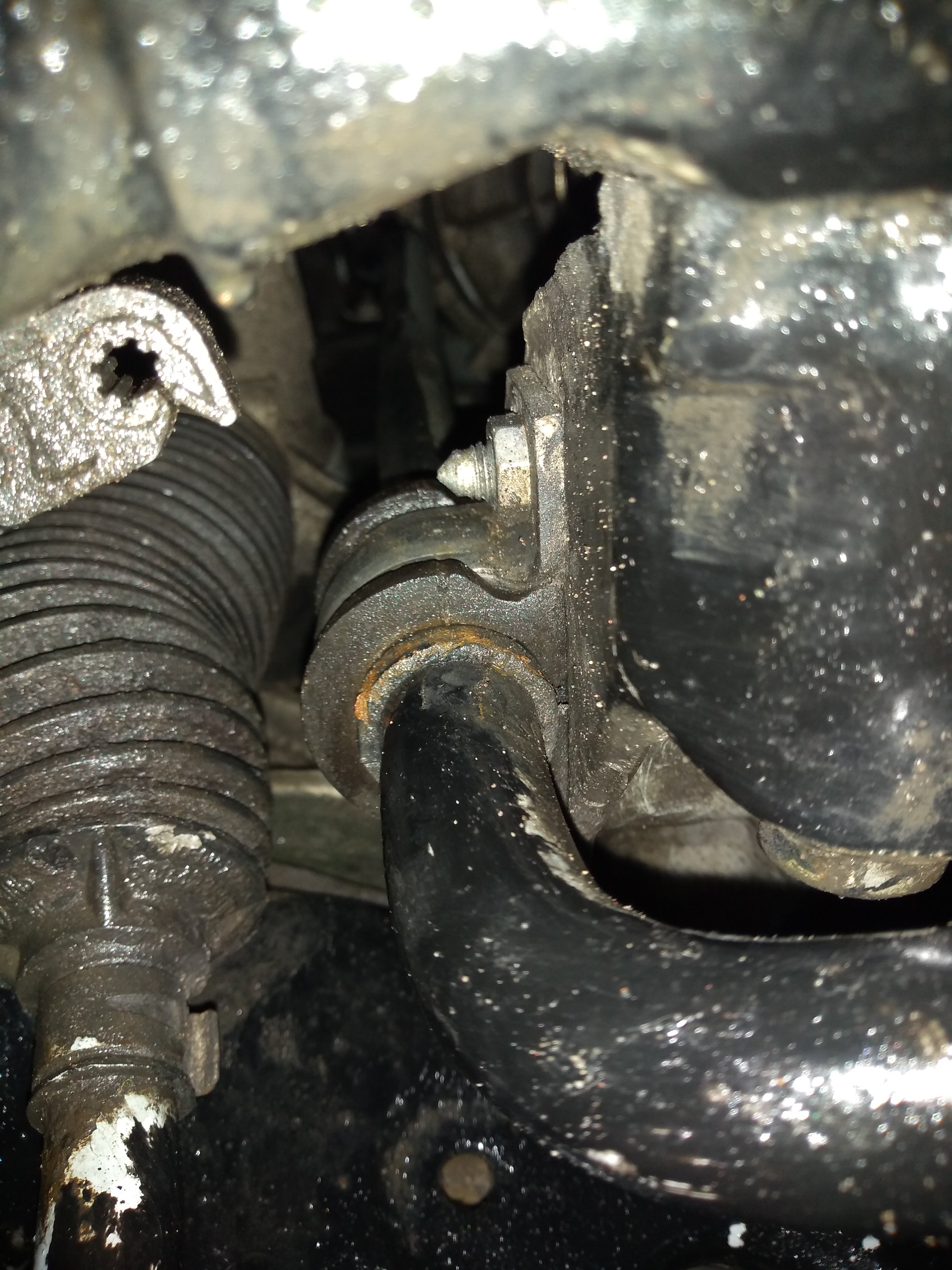

The problem started when ARB bolts were loosened too much and I had to come out to wife at roadside to retighten, which were too tight. The ARB bracket was loose in right, driver's, side of car. When replacing the arbs the right side hole has been made oval by the play in the bar. The opposite side ARB bush, which I have clunk sound looked okay.
When removing ARB bush, the metal collar if arb looked very close to the metal of chassis, 2mm maybe. The right side ARB bush looked further away.
On fitting new ARB the distance was further away. Although no rubbing was evident.
Pic1 left side ARB bush
Pic2 right side ARB bush
Pic3 right side with new ARB bush.
Run out of uploaded space for pic3
FYI regarding choice of ARB bush size I looked at 7month old bushes and found that the bottom number on the ARB bush SBR/BR 19 or 20 does not equate to inside diameter. One of the ARB bushes showed 26. Might be a batch number?
You could use a photo-hosting account and link from it?
