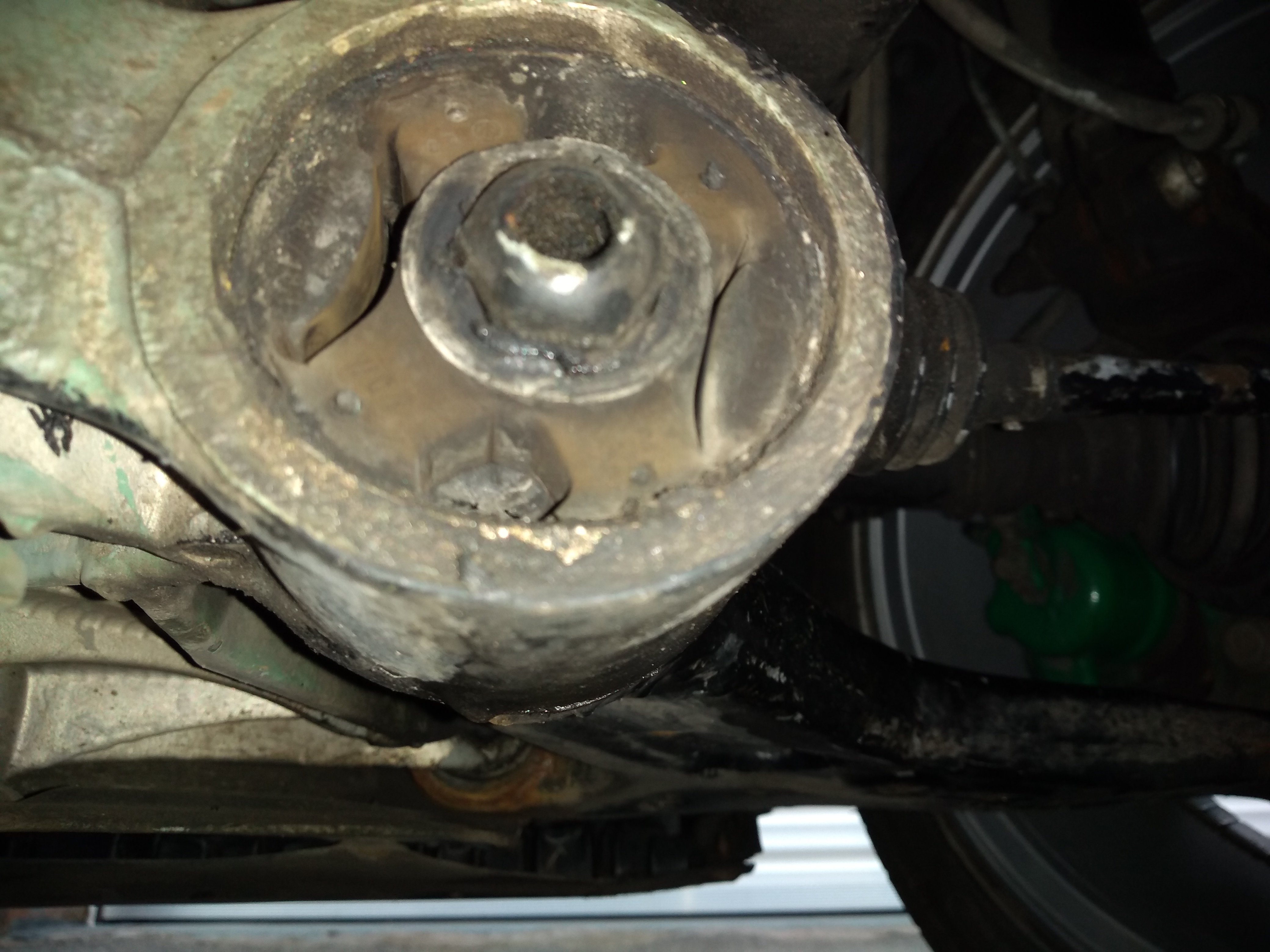

Here are some pics. Left side that might be at fault. Bolt seems offset to one side, not centralised. Pic from behind console bush facing forward

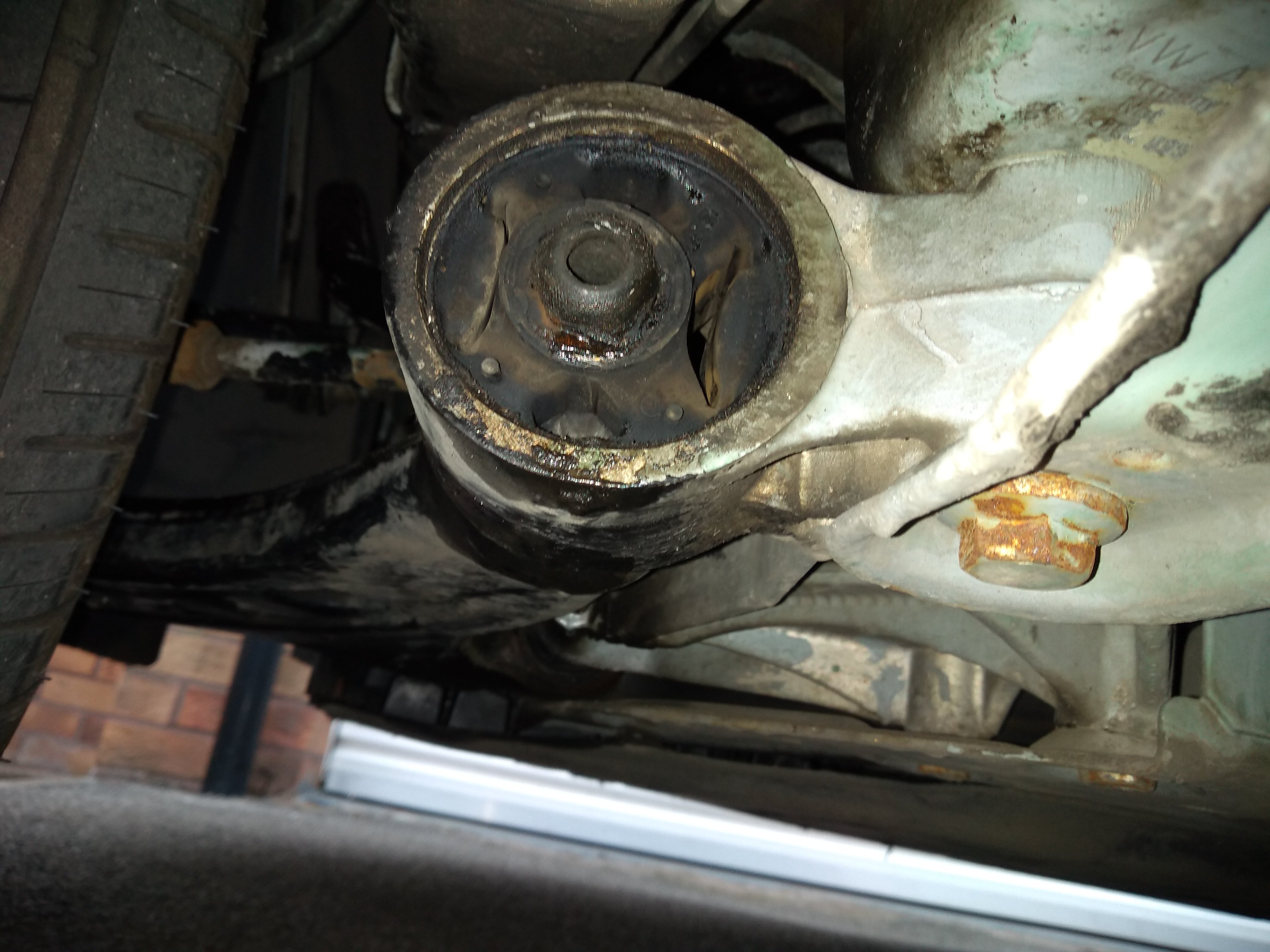

2nd pic. Driver's side from behind. Bolt looks more central.
Only thing is, when the rear console bush went before the symptoms were different, knocking during changes of speed. A vagueness in the steering in the bends, wandering.
Recent mot with shaker plate before fitting powerflex did not reveal anything.
Any advice?
I'm happy to replace on the chance this is the problem.
Ps ball joints, track rods, springs, shocks, were replaced.
Reads these links:
Would people agree to go powerflex or another brand? Upgrade bushes article suggests another brand.
The console bushes look fine to me. They are not torn or perished. The wishbone spigot not being centralised is of no concern as it's just the way it's settled at that particular time due to normal bush flex. The general design of those OEM bushes isn't very good though, and people usually fit better ones when replacing them. I have Meyle HD ones on mine and they are fine.
