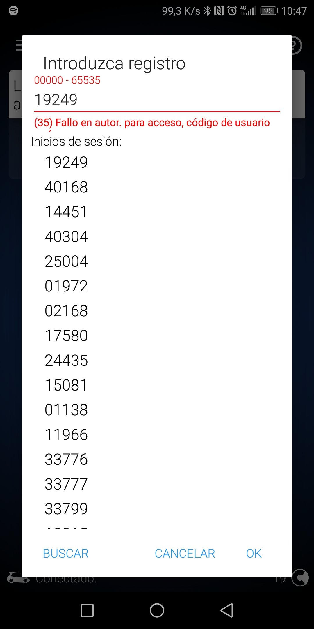

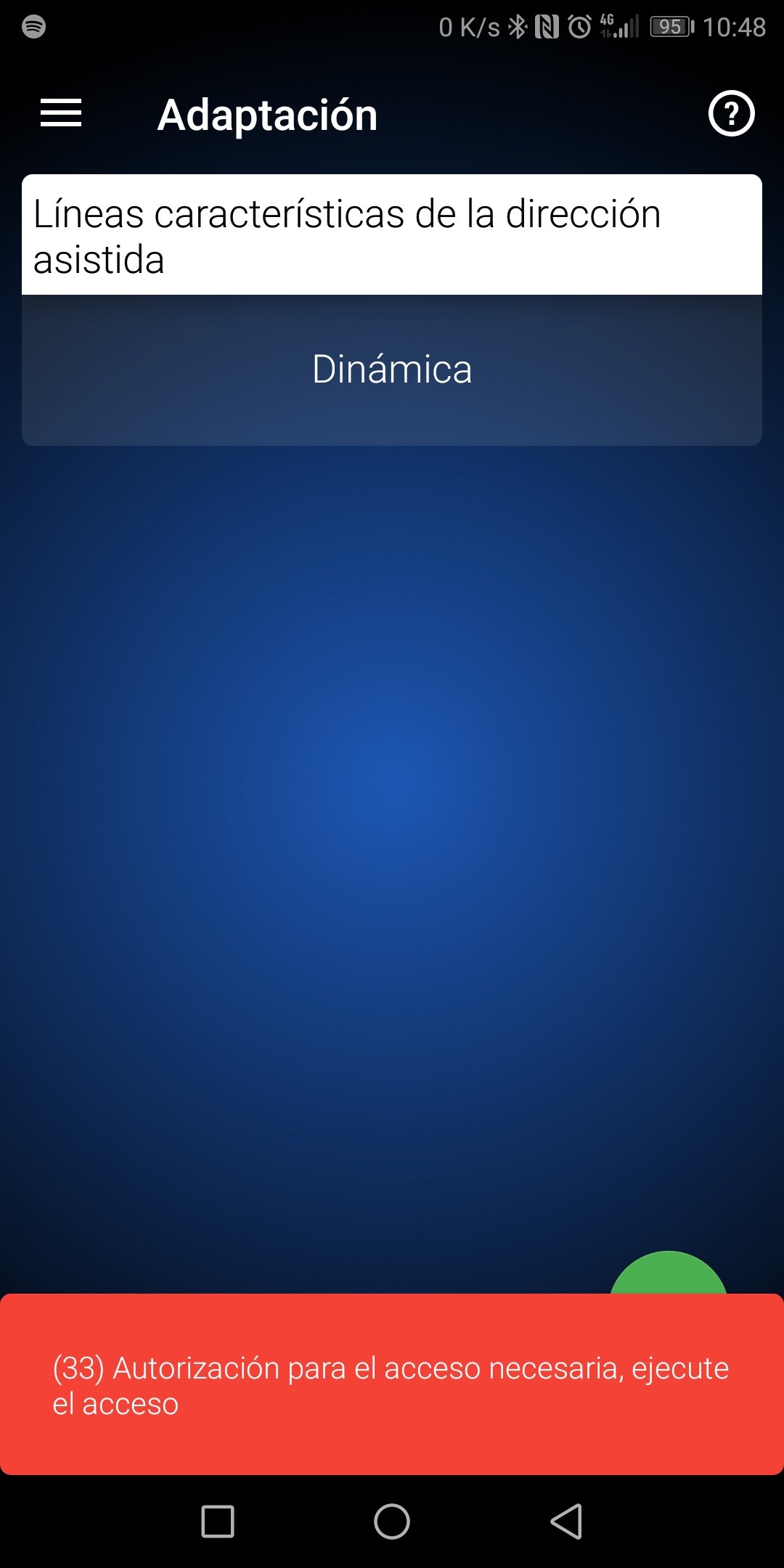

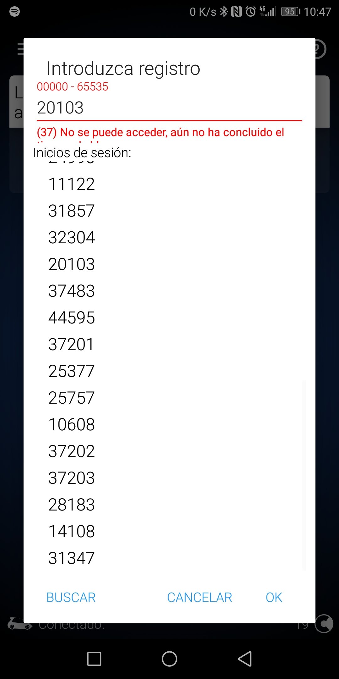

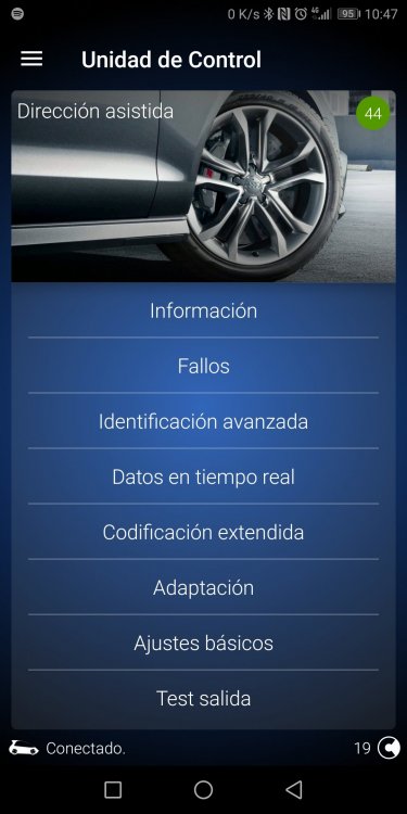

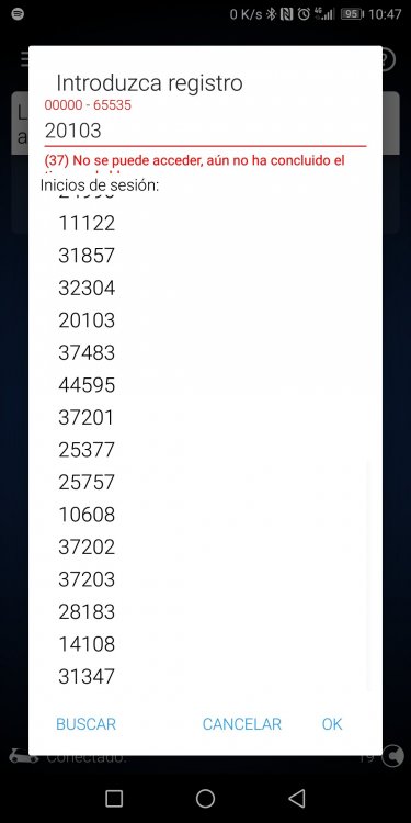

I have a problem with OBDEleven in my skoda fabia montecarlo 2017. When I enter the menu 44 (steer or power assistant) when trying to save an adaptation, I can not validate any login code, it gives me errors 35, 37 and 33. Attached screenshots about the error. I have already made modifications to other modules and there has not been any problem.

Luckily for me, the windows version of vag-com software somehow suggested the code automatically. I was not the one who did it though, and i don't remember the exact number. 27971 springs to mind though, don't take my word for it though.

Try 17580 that worked on mine to access module 44
