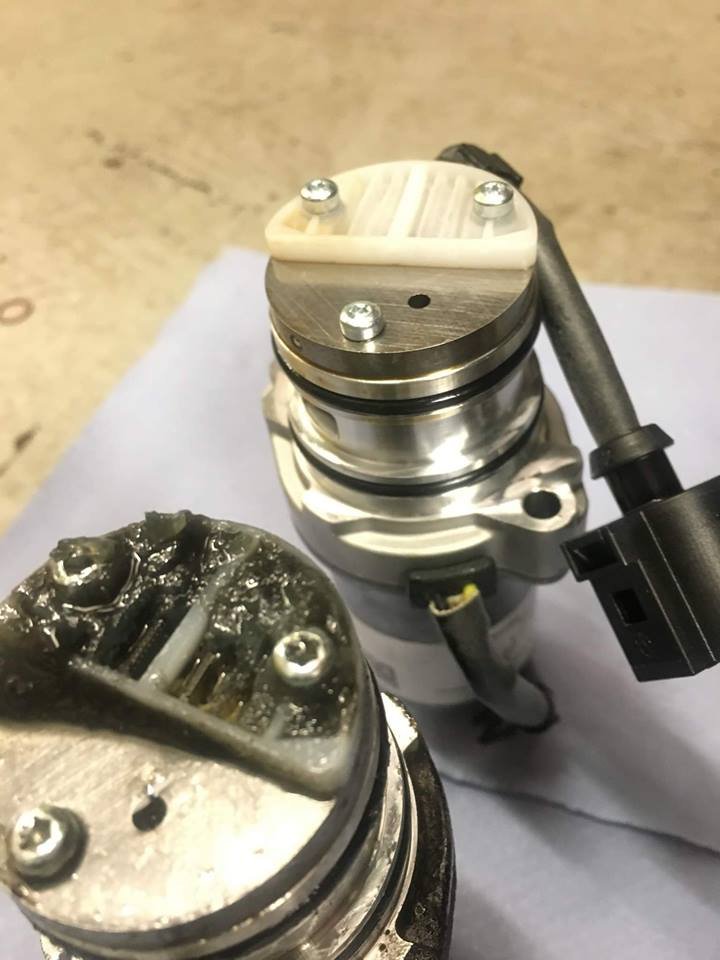

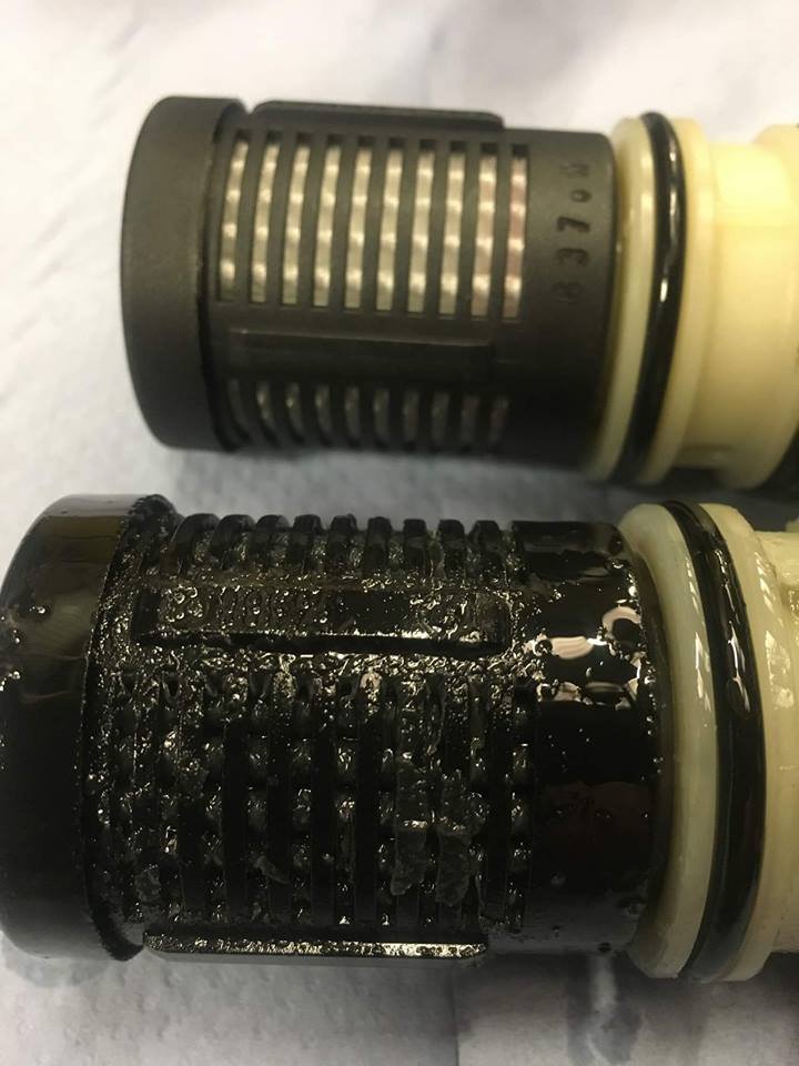

Recently had a Haldex fault on my 2013 Yeti at 38K miles. I'd suspected it for a couple of months but it was confirmed with a diagnostic during a service. The pump was intermittently open circuit.
I took it to The Phirm in Blackwater, really good guys! They found the pump gauze and filter completely clagged up. This is the filter that VAG don't replace or even have a part number for.  Pump and filter replaced and it works a treat now, honestly feels like a different beast to drive, not the slightest bit of slip from the wheels when accelerating hard.
The car has been serviced from new by Skoda and the Haldex Fluid replaced at the correct intervals. I firmly believe the failure is due to the pump gauze and filter not being cleaned or replaced during the service.
If you're in the Hants/Berks/surrey border area and are looking for a good VAG specialist then get in touch with The Phirm www.thephirm.co.uk

The pump strainer was clogged solid, and the filter was the same.  It's been serviced to Skoda specs since day 1.

Going by the pictures, mine had no metal fragments but was covered in a thick sludge, and now seemingly the 4x4 kicks in a lot smoother than before, not the shove it had been.

I've just done the Tiguan Haldex this weekend. It's done 36k miles since new and I'll upload pics later of the pump. The oil which came out was black and full of lumps, sort of like milk which is a week out of date and been out of the fridge (but black coloured) . I'd certainly have it changed and pull the pump. It takes he half an hour on my back on the drive, so should be dead easy on a ramp.
