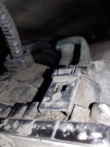

So, I have only just got around to this (a few months' later than planned...) and I am having trouble with geting the connector off. It probably didn't help that access was a bit tight as I was doing it under a trolley jack. I couldn't feel the what I assumed to be the latch moving at all. I am not sure if it is a 2 stage connector (although why it would be, I don't know) but it's probably more likely just filled with crap?
I also thought about removing the whole control panel thing it was on but it seemed again annoying that I couldn't quite get a socket or spanner on the lower 10mm head in order to at least maybe rotate it.
And even if I do get it disconnected, looks like I am going to have mess around with the clipping points. Shame I don't have access to an inspection pit or 4-poster as that would no doubt make life easier!

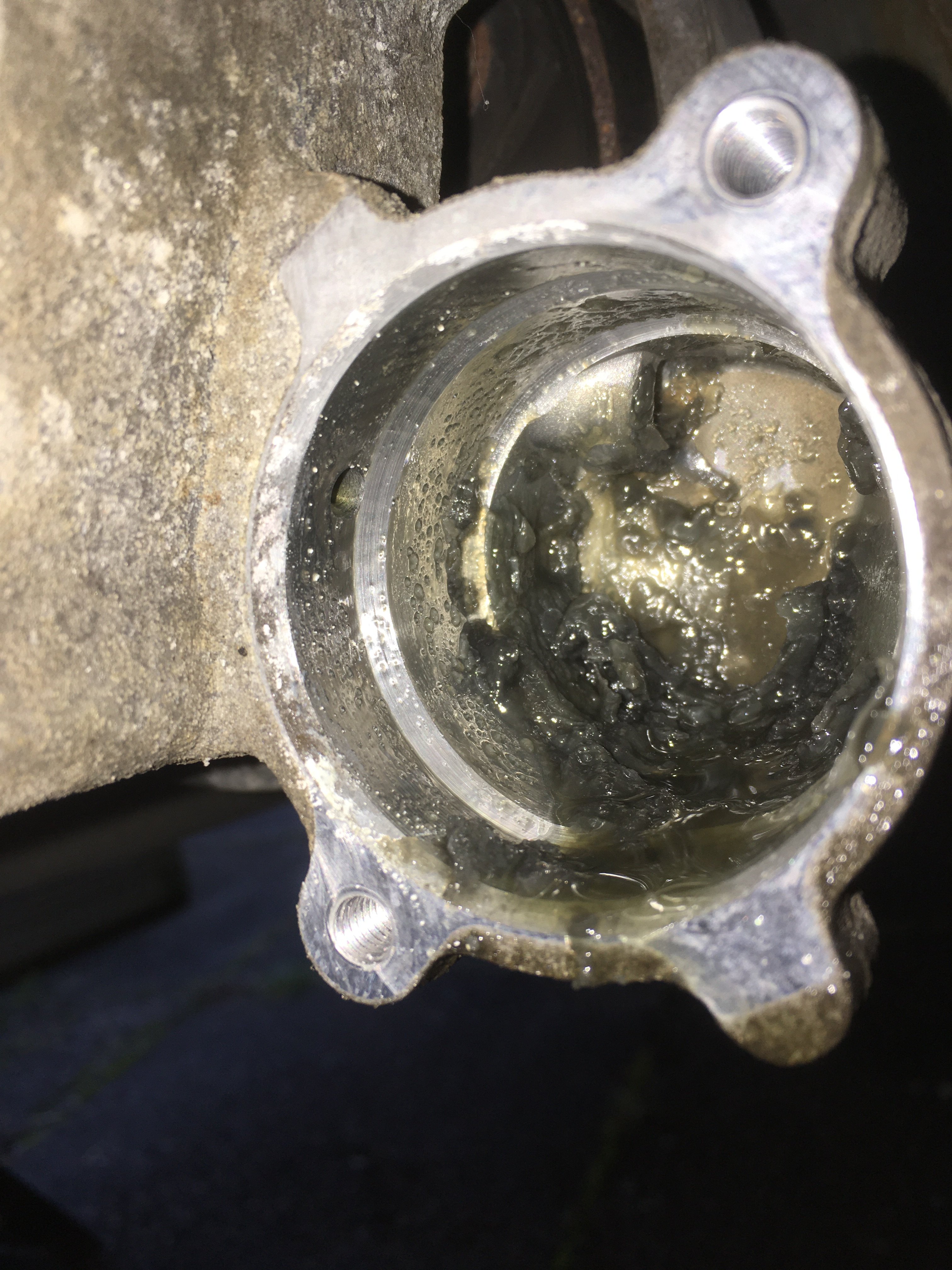

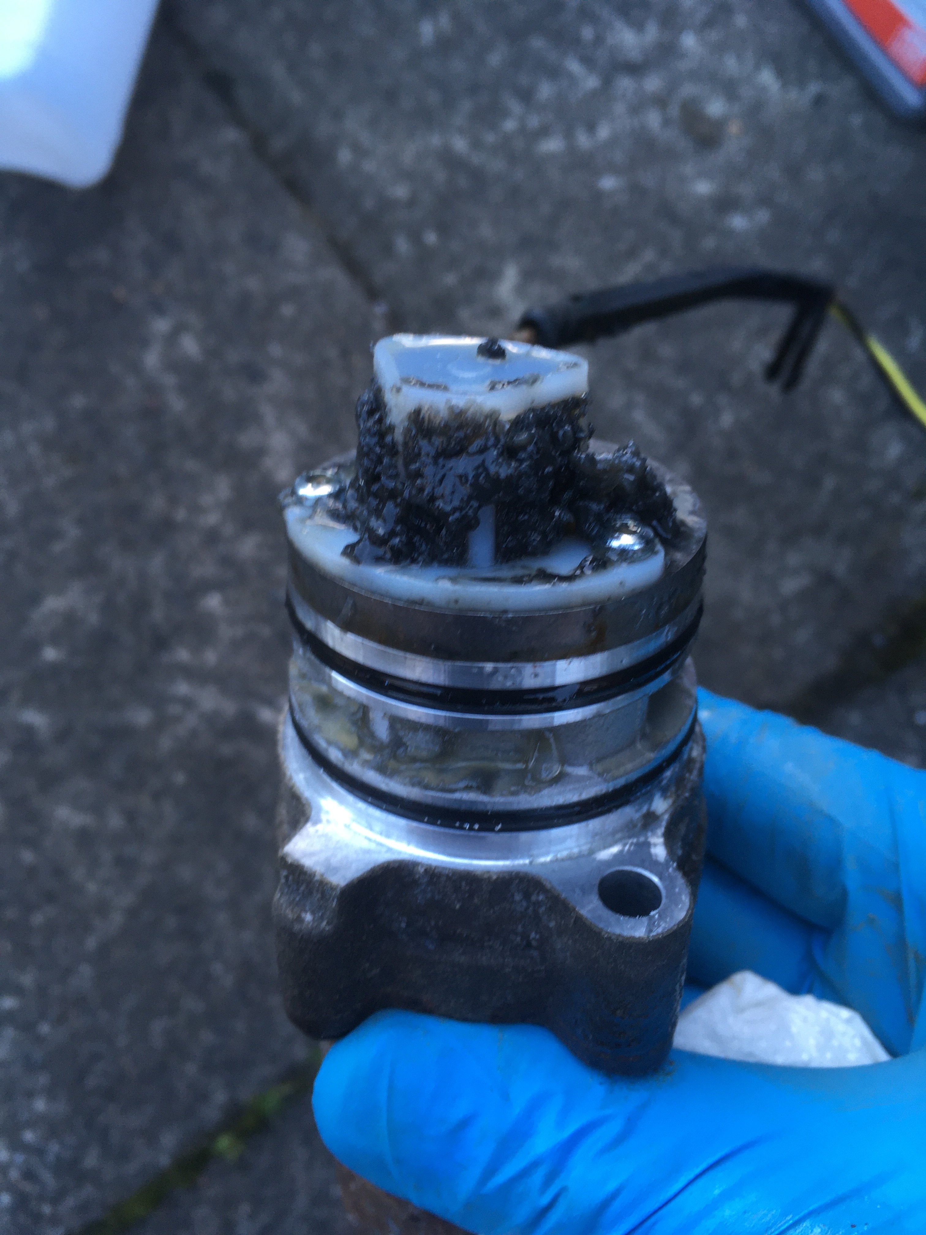

I’ve been off this week and plucked up the courage to do my rear discs and pads, and the Haldex drain and clean. I found this guys video really helpful, along with the other info on this thread.
https://youtu.be/CqvRLbwT7yY
My cars now on 64000 miles. The Haldex was done by the dealer once, I think about 40000miles but obviously the screen in the pump was never changed.
I had the car up on axle stands at the back, and access was awkward but not too bad (unlike the rear calliper carrier bolts🤬).
Like the previous poster, the harness connector was tight but came off ok with perseverance. As the tech in the video I’ve linked says, it helps to push the clip in first and then you can ping it off with your finger. If you have a look under your bonnet you might see the same style of connector on the back of your headlights that you can practice on.
Thanks for the link to the video. Turns out you have to push the whole connector in first and then use the clip to release. I've had my car serviced and oil changed now (mainly for the service history) so will wait a while before attempting it again.
