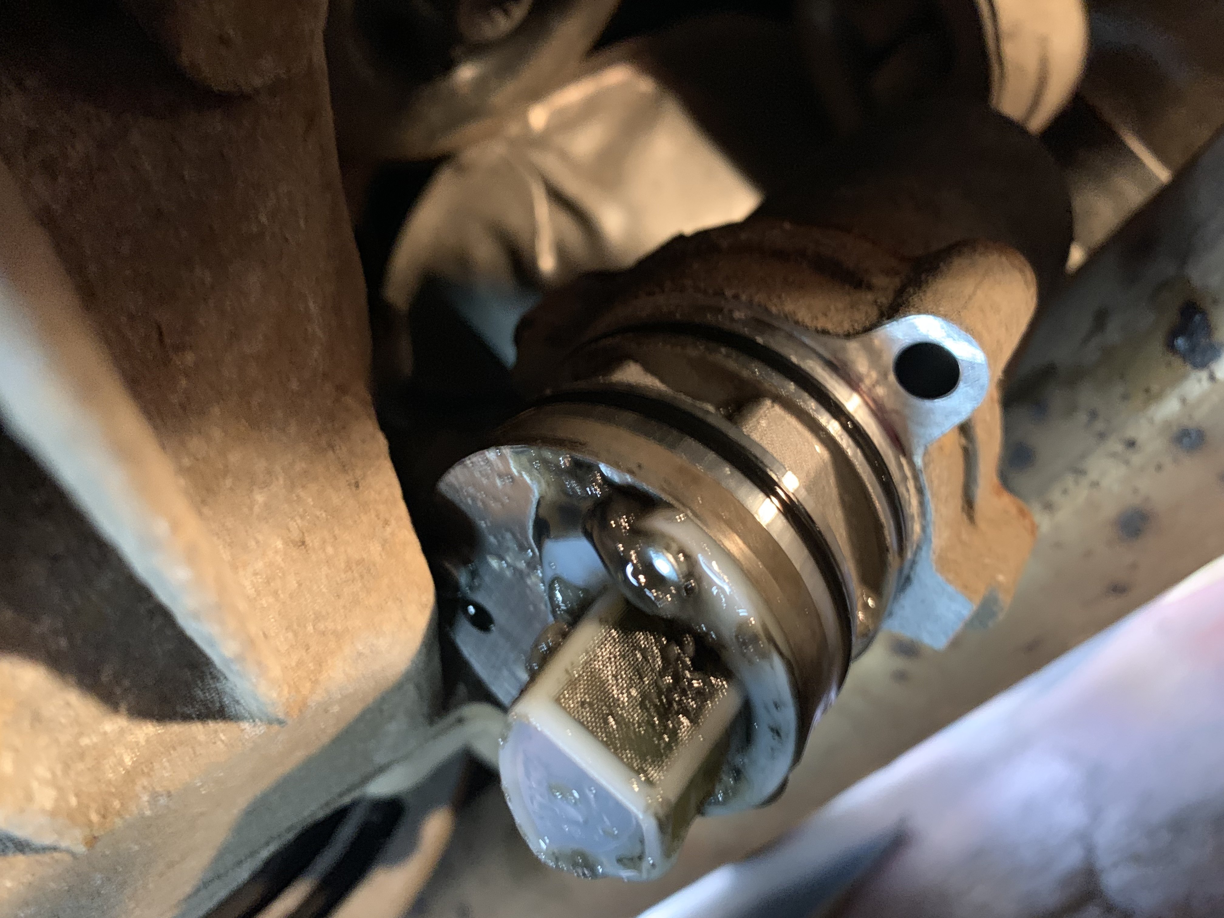

Well after doing my oil change and pump clean out I’m suspecting I need the thing resetting with vcds- I’m getting the traction control light flashing away, yes when giving it some in damp corners.

    Recently had a Haldex fault on my 2013 Yeti at 38K miles. I'd suspected it for a couple of months but it was confirmed with a diagnostic during a service. The pump was intermittently open circuit.
  • Yeah, that's Gen 5. If your close to me then pop in and I'll reset it.
  • I have a new pump and fluid sitting here right now ready to do it myself if needs be, but as I have warranty on this I'm inclined to let someone else pay for it. If the warranty fails I'll use consume

I kinda think you might have a Gen 4 Haldex. Does yours have a filter in the side of the Haldex unit?
Did your pump have a gauze filter like the pic I posted or the one Steve Humphreys posted?
Mine’s Gen 5 without the separate filter.
Its got the smaller ‘hat’ type gauze on the pump.

On 29/03/2019 at 18:58, Rustynuts said:
If your version of VCDS doesn't have the required drop down options then maybe update your VCDS?
Ah, of course.  Yours is a gen 5 haldex, right?  Mines a gen 4, so the list of options will be different....   doh!
