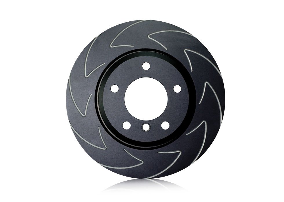

Kinder liking these discs

1 minute ago, themanwithnoaim said:
Anybody know ATE or TRW calipers ?
All the MQB calipers I have seen are TRW. ATE tended to be used MK5/6 Golf era. Have not seen actual 245/MK7.5 calipers in the flesh but I don't think they will have changed from the Pre-FL/Mk7.  Should make no difference to the disk choice though as they are interchangeable. I have had both ATE and TRW calipers on the same spec disk. Pads are different though
If you must, better than ones with holes in I will give you that, not as good as plain ones IMHO. Good if you like dust and noise
