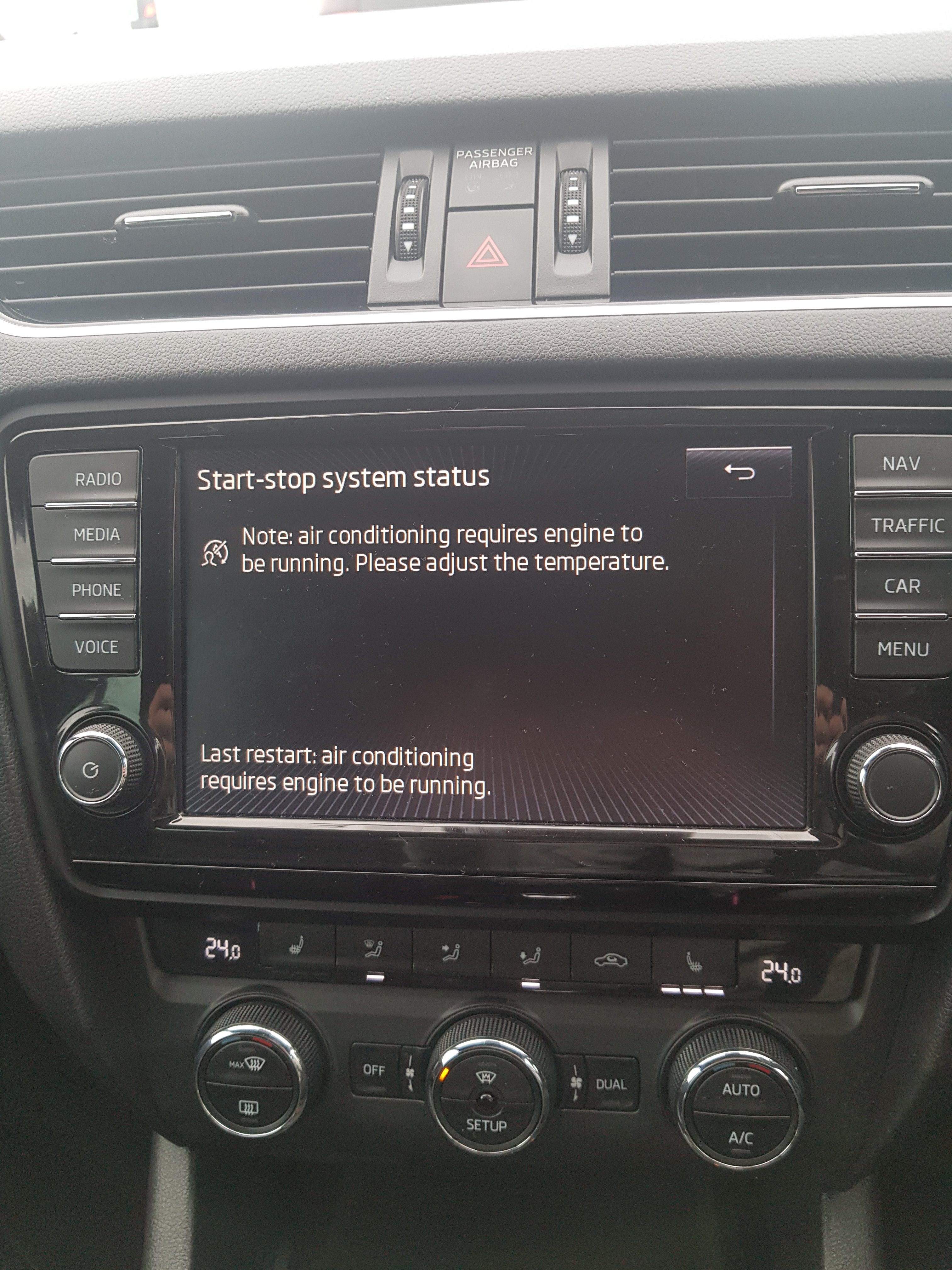

Pic attached of my unit.
Not in the car atm but pretty sure there is no. Postcode button
I think I’ve commented on your post about this on Facebook. The detailed answer is there, my build thread with some great info and contact details for Pawel (pab567) who is the authority on all things MIB :)
