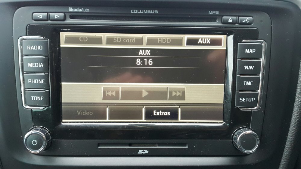

I have a Columbus Sat Nav unit, but there is no Skoda SD card with the car to update.  I'm not going to pay £200 for an SD card with maps or £50 for a card as the Sat Nav on my phone is fine, but it would be nice to have the car one working for a modest cost.
It sounds like my plan of downloading the files from one of the links above and then copying onto an ordinary SD card isn't going to work.  If that fails, should I try the SEAT Forum CID workaround next?
Failing that do I buy a secondhand Skoda SD card off Ebay for £20-30 (probably where mine ended up!) or will that SD card be linked to a specific VIN and not useable in my car?
Columbus doesn't use a card in use, the maps are held in the unit once uploaded. The CID business doesn't apply. You download the maps onto your hard drive, use 7zip if a PC and copy onto a 32gb sd card, class 10, then import them in checking the manual on whick option. Will be update, if it blows a raspberry then you wont have Mapcare but I think all recent Skodas do. The VW site provides a good pdf on importing into the Discovery Pro which is what your is.

I am sorry but I don't know what an MIB1 or 2 High look like.  I pushed the Media button and nothing says juke box, this is what the screen looks like (and the whole unit) after doing that. When I push the navigation button I don't get an option for version information - I have tried this every way possible in Unit menus, in the car menus and reading both the car manual and the Columbus unit manual - there seems no way of finding out the year/version installed.
4 hours ago, Tell said:
If it's a really old Skoda....
It's registered 26/11/2010.
Hopefully the photo will help?
Reckon that isn't a mib1 and it's not a mib2.
Think your hardware is on this thread.
My knowledge goes to mib 1and 2. Any further back and I pass without research. There are units that are kept going by a user community. It may be one of them. Certainly Wi-Fi link updates isn't one for that. Since it says HDD the maps are going to be on a hard disk drive if there is no CD / DVD and not on the SD. I'm sure there will be experts on Briskoda that can place the model and update options. Your dealer ought to be able to help.  It's not a Karoq unit which is the thread.

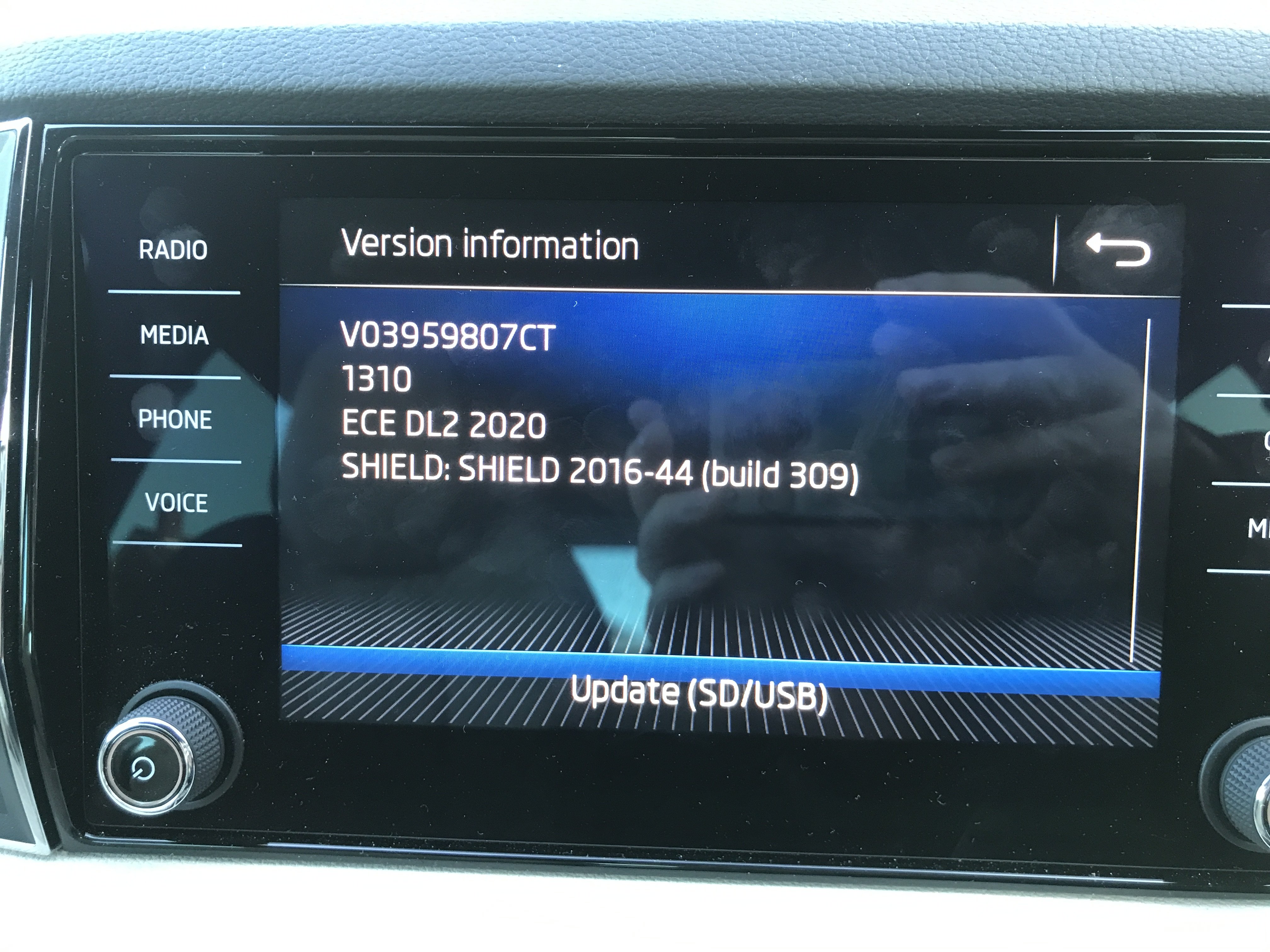

From Skoda Portal or VW? And what is the version of the maps? 1310?
skoda update portal ece1 2020 there are some different versions depends where you like to travel
Edited by skoda1982
Just now, skoda1982 said:
ece1 2020
Yes, but if it is the same from 2 weeks ago (same name!) it is ver 1310. And that version is published by VW in June, and maps are from beginning of this year!
So that is why I ask. If it is really new maps or just VW 1 year old maps presented by Skoda as 'new'.
BTW on VW site there are truly new maps.
As far as I'm concerned they are the latest from Skoda. I'm not all that bothered when VW published their version, I have a Skoda. I updated from the Skoda portal.
I posted to let other Karoq owners know the update is available.
ECE 1 2020
Andorra, Belgium, Faroe Islands, France, Gibraltar, Iceland, Ireland, Ireland, Luxembourg, Monaco, Netherlands, Portugal, Spain, United Kingdom
ECE 1 2020
5,00GB
Important is the version number of the map.
1420 (or1430) is the newest from the VW-portal, 1310 the old one before from June.
Skoda offers new maps a half year later than VW.
