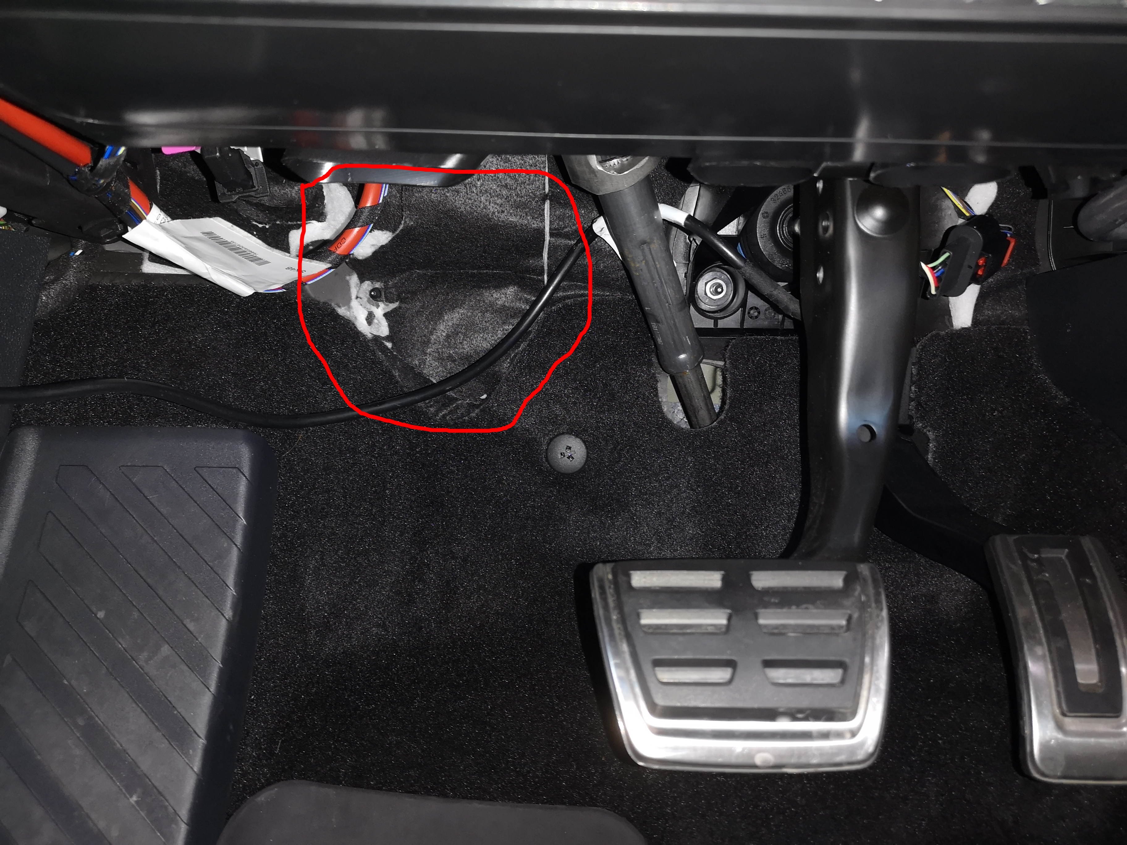

Mine is a RHD car too (Sweden). You need to remove the insulation (with the black felt on) which is stuck on the firewall, close to where the steering column goes through, then you'll find the grommet behind it. The insulation is pre-cut in the area so you can unstuck only the small bit that is in the way and not the whole thing. This is where you should be looking at:

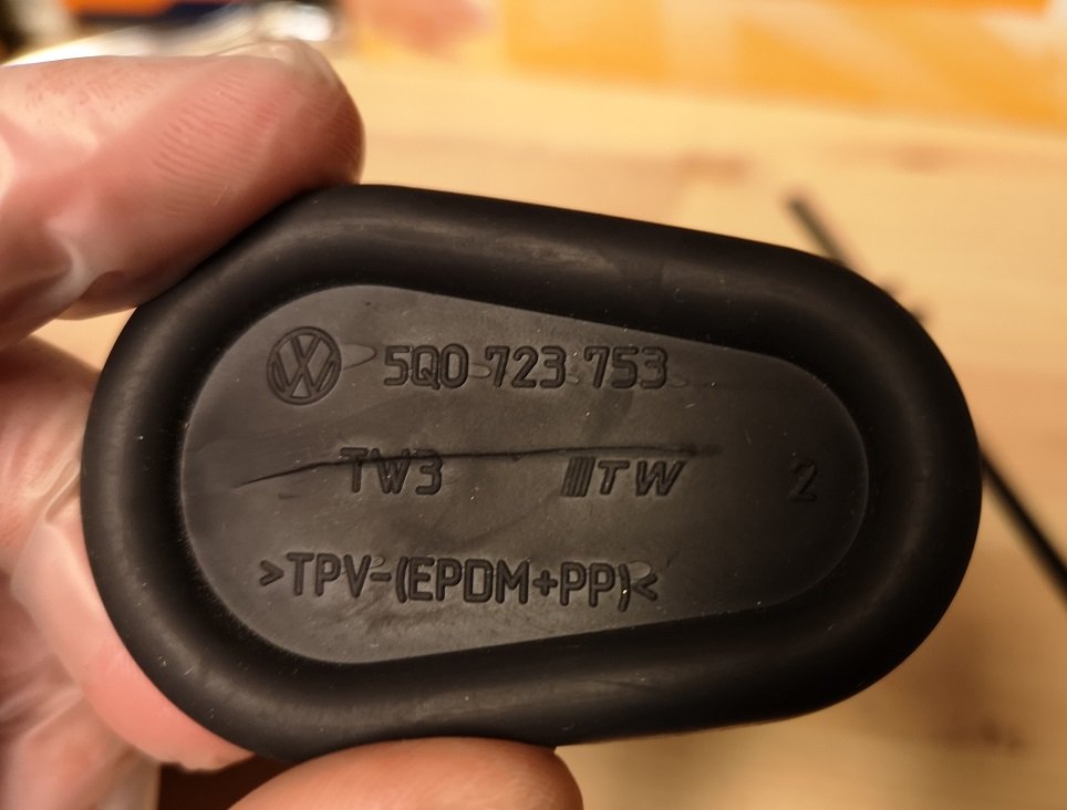

There are actually two grommets that go through there, don't mistake them as there's a small round one which is impossible to route cables through and will give you a hard time.
This is the grommet to remove:
That’s really helpful.  The “official” instructions  suggest that for RHD you need to run the cable behind the centre console and go through the firewall on the left hand side to come out behind the battery box - so completely different!!!

I figured!  That's why I wrote Sweden in the first post, to clarify the car i'm talking about has the steering wheel on the left, in the correct position that is :tongueout:
So yeah, you should be looking to the side behind of the battery, passenger side in your case.
