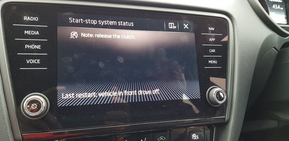

    Over time I have trained a lot of drivers in their vehicles, with quite a few vehicles having the stop start system. At the time I owned a 2011 Octavia VRS that did not have this tech, but I did wonde

Over time I have trained a lot of drivers in their vehicles, with quite a few vehicles having the stop start system. At the time I owned a 2011 Octavia VRS that did not have this tech, but I did wonder whether I would like it on my car? Now I have a motor with the stop start, I find it really quite good. My car is a manual and it certainly fires up the motor in a split second when you put the clutch down, so no delay in setting off. Automatic cars with this system can take that little bit longer, which can be frustrating when you want to take that small space entering a roundabout. Usually though, you get round that by easing off a bit of brake pressure just before you want to move, which can fire up the engine. Or with some cars, mine being one of them, move the steering wheel and the engine fires up ready to go. This system does in a small way of course, help your fuel economy. I know, rather a long post on a small subject, but personally,  now I have it, I know I like it.
