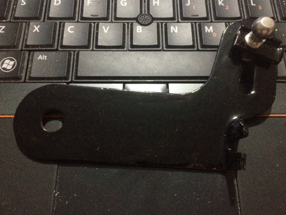

On the Octy the bracket for the front sensor has a slot in it
And with VCDS in the headlight module measuring blocks you set the position of the ball joint in the bracket, and then to correctly adjust the beam setting, you again need VCDS to set the neutral position and then you manually adjust the internal headlight adjusters
