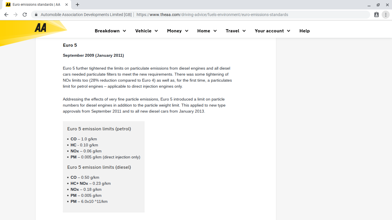

If your car is orig. sold in Europe, it should certanly have dpf in 2009.
Actually what happened is not as clear as Euro 5 after September 2009.
The cars were not 'New' Type approvals & then there are the 'Derogation Rules.
Edited by Skoffski
I should have added it is a pd I don't believe any of the 105 bhp pd cars sold in the uk had dpfs fitted.
This was the time when the pd engine was phased out and common rail came in but there was a period of time when both common rail and pd were both sold which leads to confusion re dpfs.
