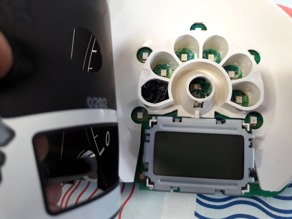

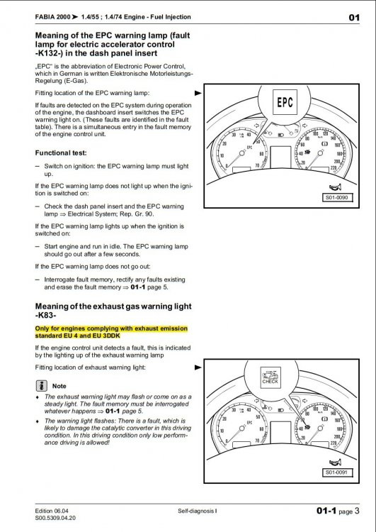

    At least they didn't feck with the LED itself and make it harder to fix... Now things are 'as expected' with emissions light on. Thanks to this thread I've found a fault with my car that I d

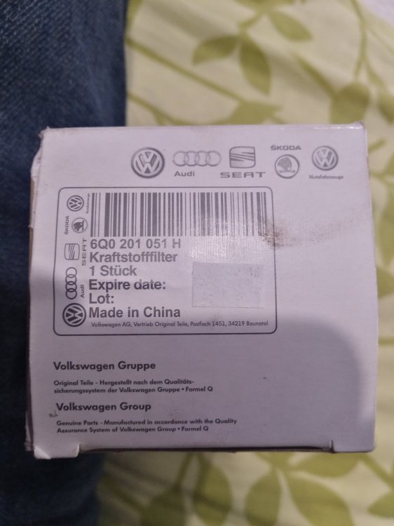

  • Yes. When warranty was over, I made maintenance by myself > and old=OE filter was 6Q0201051B (3 bar, with integrated pressure regulator). Made in PRC- just like Knecht filter, which I used aft
