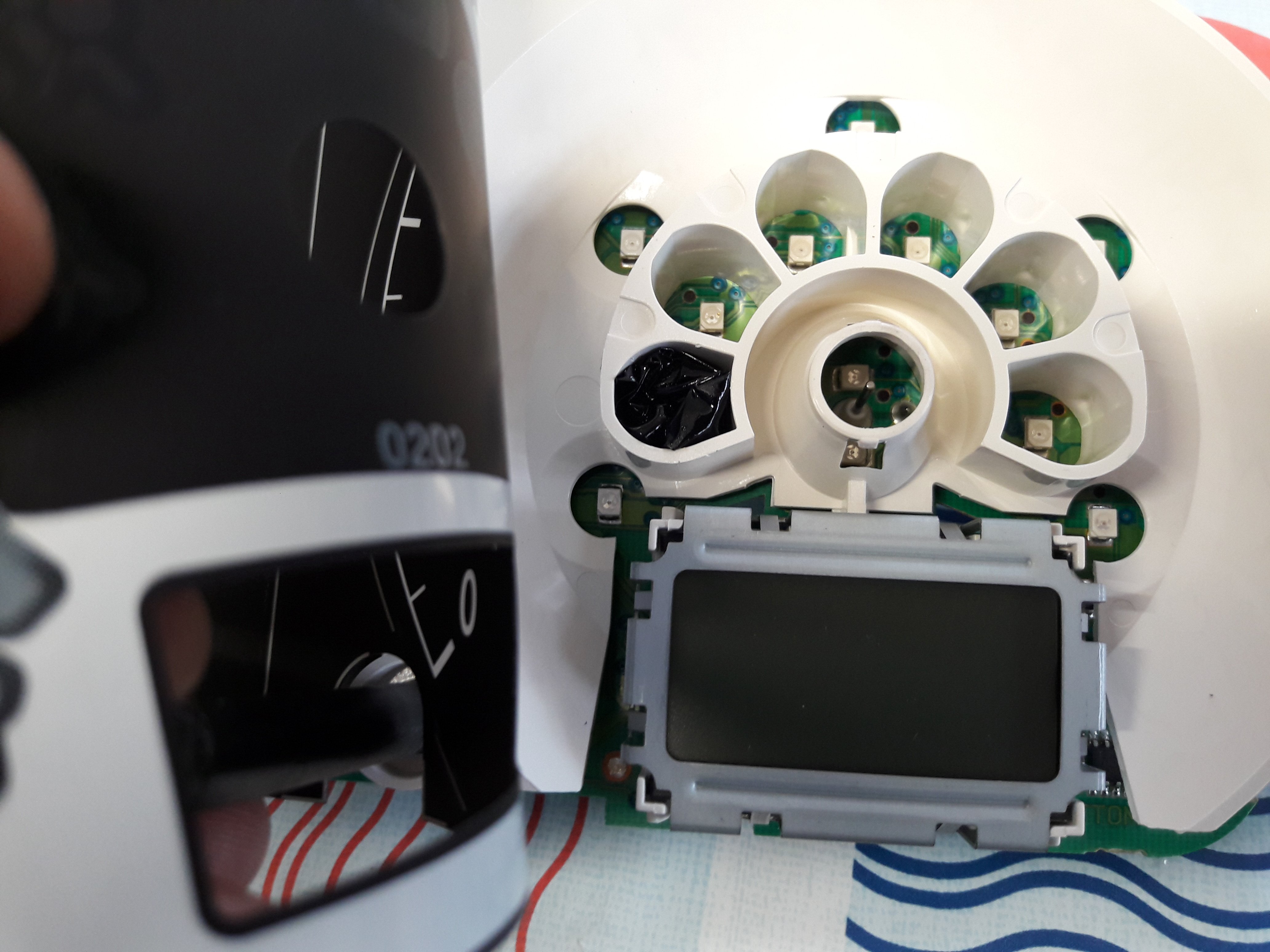

I love experiments...
About 16 journeys into my current one, and it occurred to me at lunchtime to wonder if I'd ever seen the emissions warning light on the Polo, and to look for it at ignition on.
I think you may be able to guess the result?
May explain why I didn't get a fault light when I had a dead rear lambda sensor; and why I don't have one now.
Gonna just check that it comes on at ignition on on a workmate's Fabia with same engine, then maybe rip out my cluster and see what sort of fkery has been perpetrated on it by a previous owner! :D
Have you got a fault light by now @juanse_2691?
  • Sponsor
:D
At least they didn't feck with the LED itself and make it harder to fix...
Now things are 'as expected' with emissions light on.
Thanks to this thread I've found a fault with my car that I didn't know I had.  :cool:

Love how your experiment has unearthed this bodgery. Wonder how long it would have been before you found out about the light if you'd never done it.
  • Sponsor
Luckily, I have scanned the car reasonably regularly since purchase. Should have failed all 4 mots I've put it through, I think; shouldn't the tester be looking for absent warning lights at ignition on?

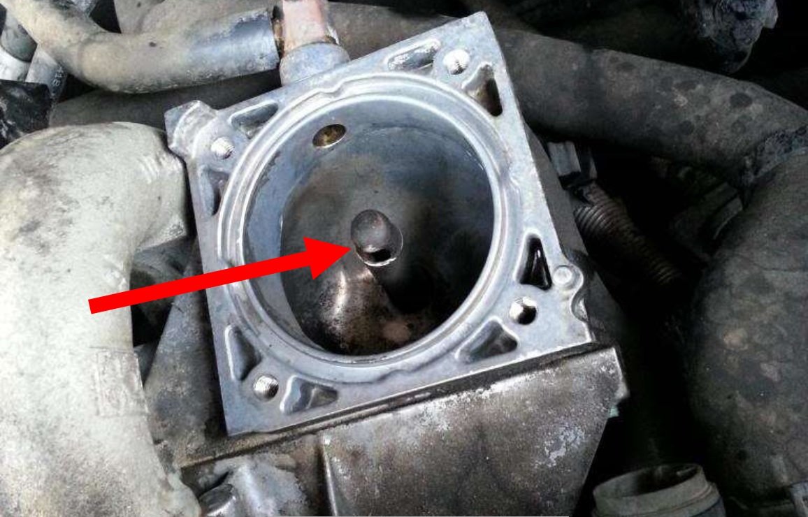

Is the intake end of the EGR pipe different between AUB and BBZ engines? The AUB seems to have a little "cap" with two exits just under the throttle valve, mine does not, it's just an open end. I don't know if it makes any difference. I know for certain that the EGR valve was replaced by a PO while the car was still in warranty.
Yeah they got rid of the cap because they used to block up. Think I wrote a guide on it somewhere on here.
Yes, I used the Taylor93's guide for EGR cleaning for AUB engines and you're mentioned in it. Thank you very much, I thought the cap was missing.
