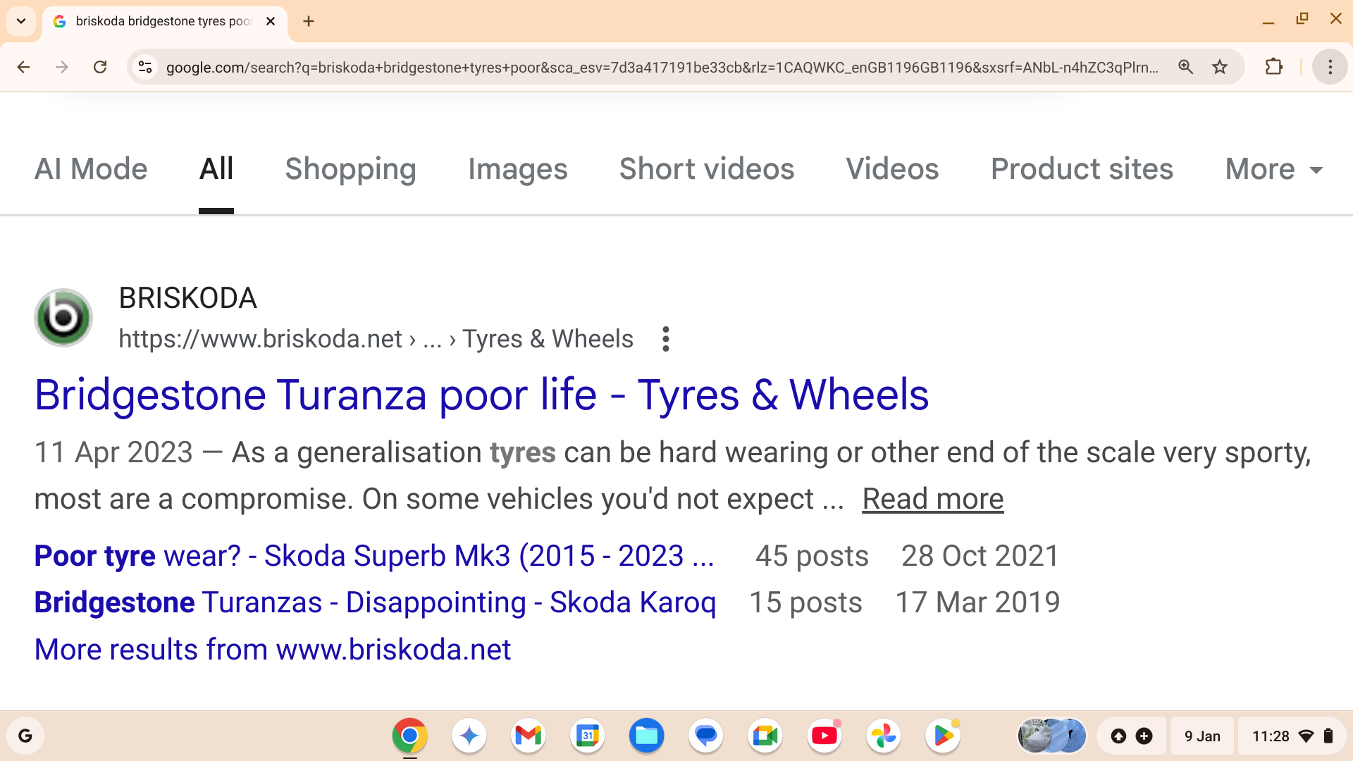

Was just thinking out loud as to why the tyres fitted may be different. The fact both of our Karoqs had the same make & model of tyre suggests supplied with them. Possible both 'owners' changed to the Bridgestones but would be a helluva coincidence if they did.
Suzuki fiitted Bridgestone Duellers for decades and still do, even to the Jimny,s. Totally crap tyres. VW Group really seem to just fit whatever is cheap to them from whoever for the UK. Even to proper 4x4,s not just Softroaders.

Had Bridgestone Ecopia EP 150 on the Swift when it came and couldn't wait for them to wear out...
