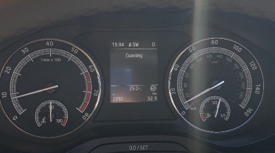

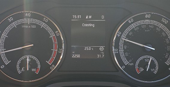

On ours, if I recall it displays the Eco logo on the display when coasting, and only displays the word “coasting” if you have the instantaneous fuel economy displayed. Rather than show “- - -“ it says “coasting”.

Makes sense. The screen grab above showing my car in "2-cylinder mode" only shows the wording when on instantaneous mpg.

On 05/07/2019 at 15:57, AndyMorris said:
What screen were you on before the word 'Coasting' appeared?
