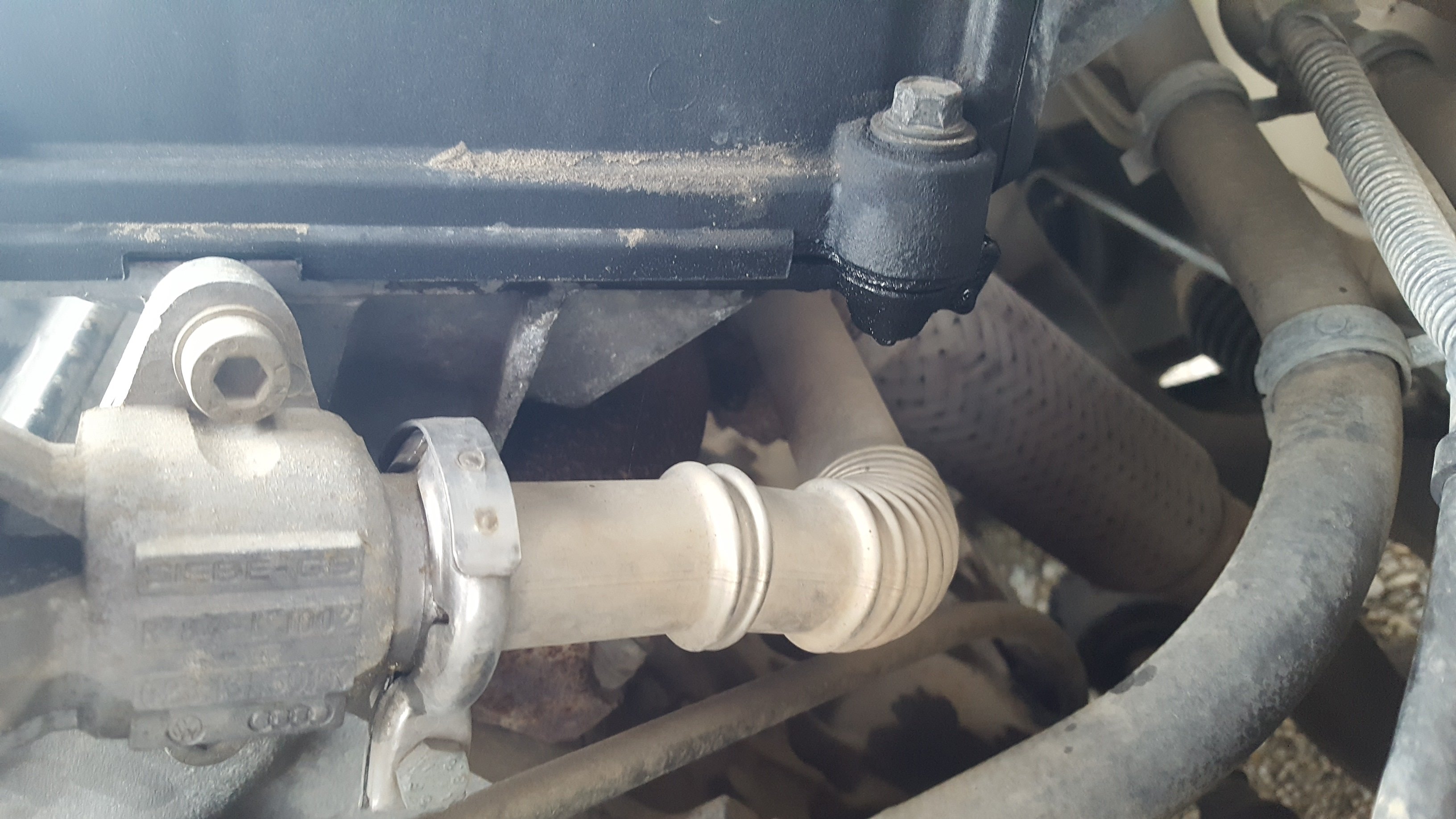

could it be the clogged vent pipe a reason of bogging?
Yes. No promises, but the point of the vent pipe is to stop the fuel pump having to depressurise the tank to supply the engine.

  • I my opinion there is nothing more you can do at this moment. There are too many things that can be attributed to as the cause for bogging down at that particular phase of driving. It seems to me that
  • Yes. Probably letting air in too. The illustration below from the workshop manual might help. Of course. It was next on my list but I didn't know how good DIY mechanic are you. Cle

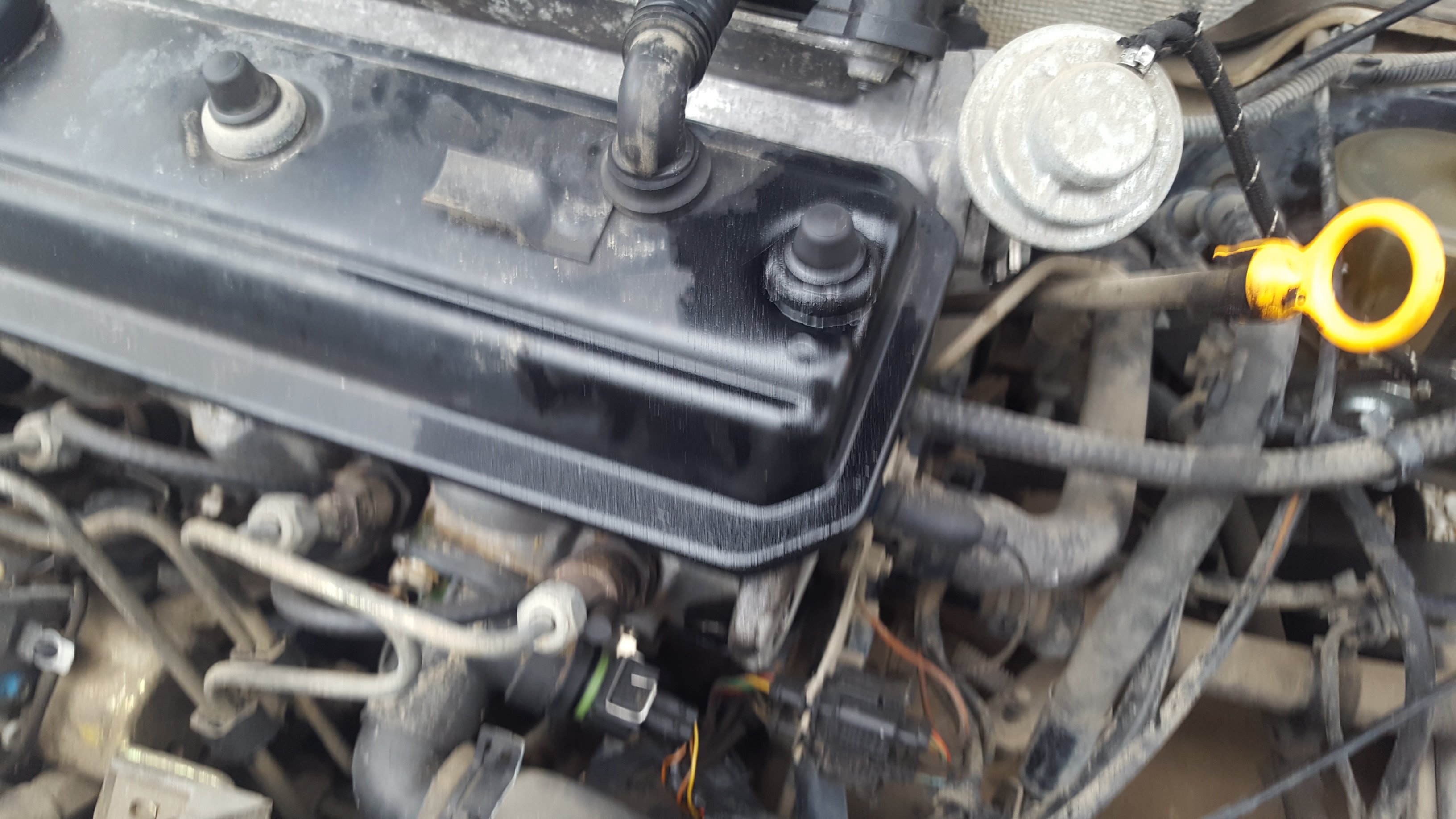

I add also this....black oil leaks ....are u thinking this can influence hot start problems or something? 😅😅

-So could the black oil laeks from the air box means loose piston compression?
No. You should investigate where it comes from and proceed accordingly. A leak is not always something that kills the engine but can make it run bad.
Ok any suggestion where start , waiting the obd cable to arrive?
