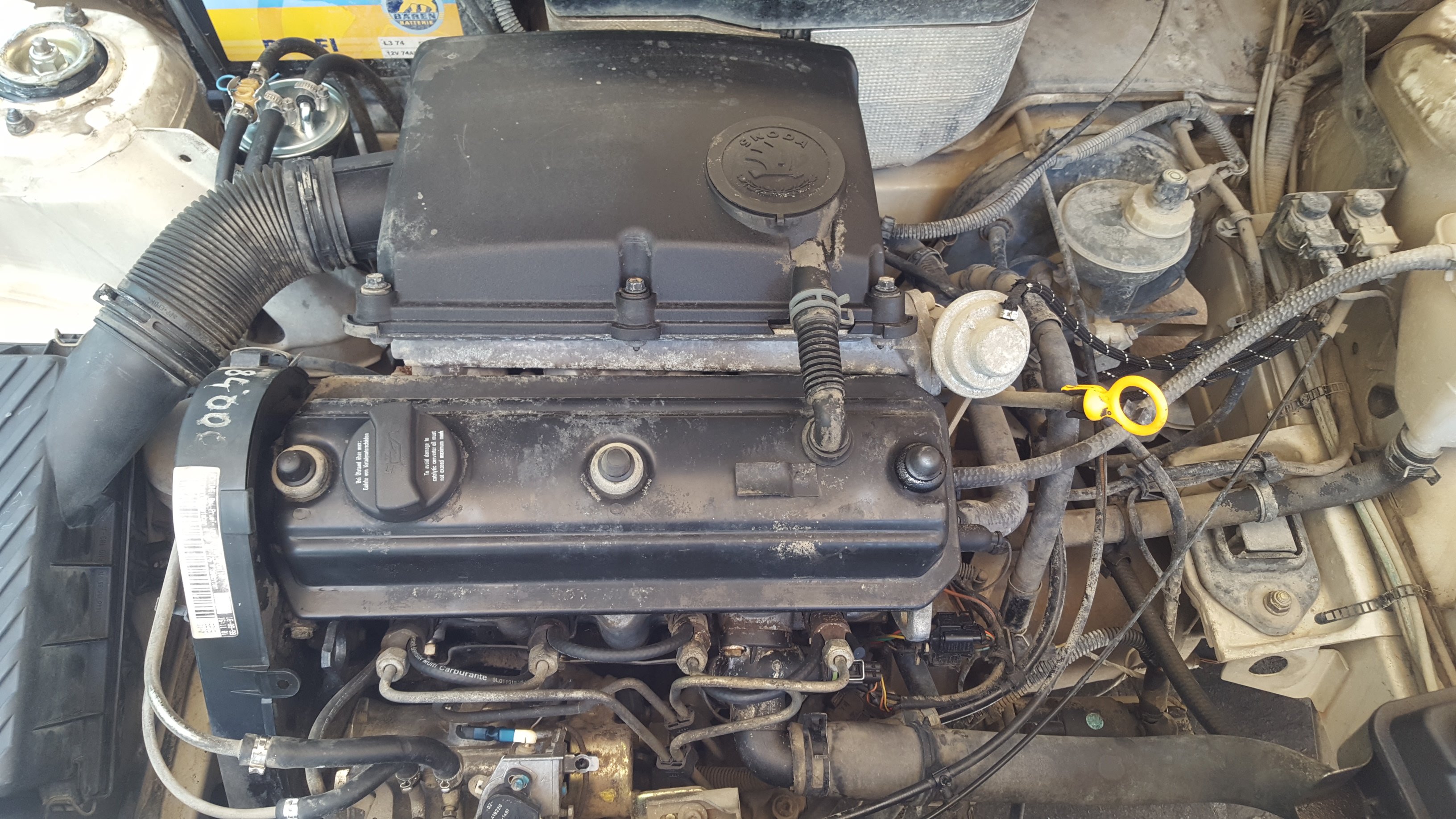

Pickup lx1.9D rough running when not under load
Hi guys
As the title my pickup seems to missfire when proceeding with low load on the throttle pedal. The case is like when driving , for example, 60km/h and you find in front of you another veicle going at 50 km/h : so  you have to leave the throttle pedal for a moment and came back steady to procede at 50. So it starts to pull back and forth. If you load more it goes well . On load or heavy load seems to run fine, it doesnt smoke. I do 25km/L.
The pick up has 15500km , timing belt (as write on it from the last owner) at 89000.
I already change the fuel filter (as well the air filter)and the rubber hoses coming back from the injectors. This last because seems that the 2 injectors( in the "center of the car" side) seems to leak.
Water thermostat on my way to be change because water temp stay low (around 70° but in this crazy hot days stay up) but the fan work and it doesn't rise above 95° i think.  Classic hot start problems(ordered a new temp sender too)but nothing other than that hahhaah
Where i have to look at?
Many thanks

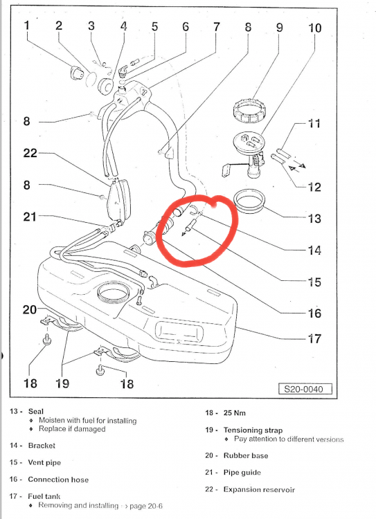

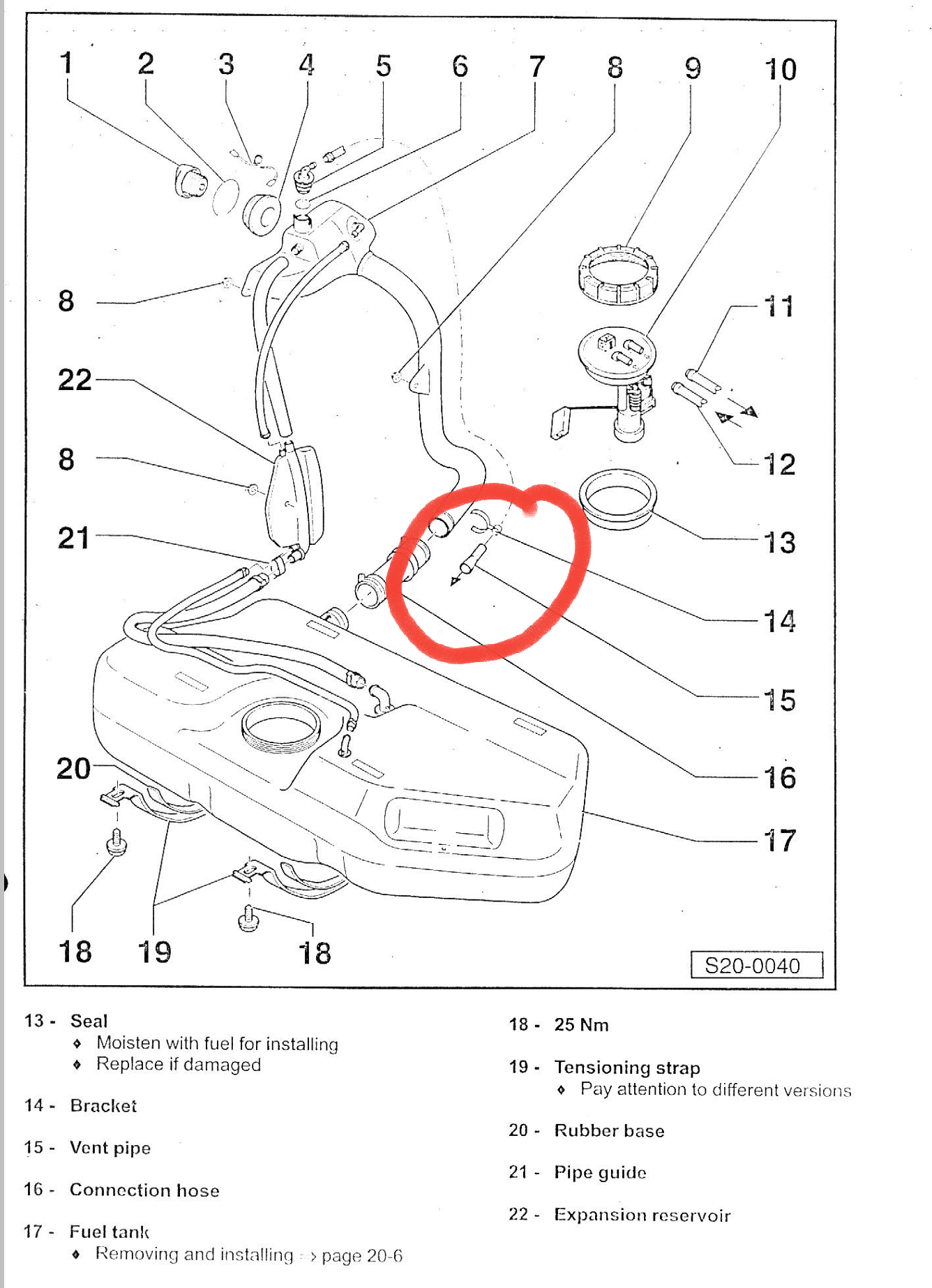

  • Yes. Probably letting air in too. The illustration below from the workshop manual might help. Of course. It was next on my list but I didn't know how good DIY mechanic are you. Cle

Many thanks for the pic!
So first do i have to drain air that would be stuck in? How? Craking inkectors? Bleeding nozzle?  After this i'll drain water from filter(bleeding the air from the nozzle on the hose).

Thanks Ricardo only re-reading your last i saw the quote from the other thread! So now i will ceck fuel lines! ( do you understood which line refers the guy in your quote?)
Many thanks
You'll have to check all fuel lines.

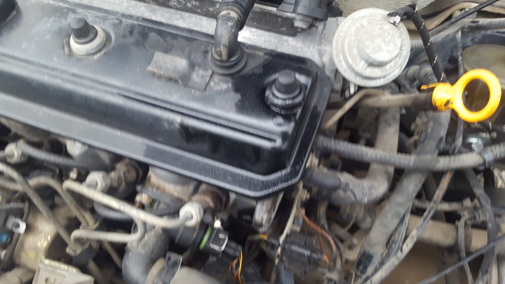

Little update
New thermostat and temp sender(green band) arrive, i miss only the coolant liquid and i can change them. which will be the right color? I have pink(or mybe red) is it right?

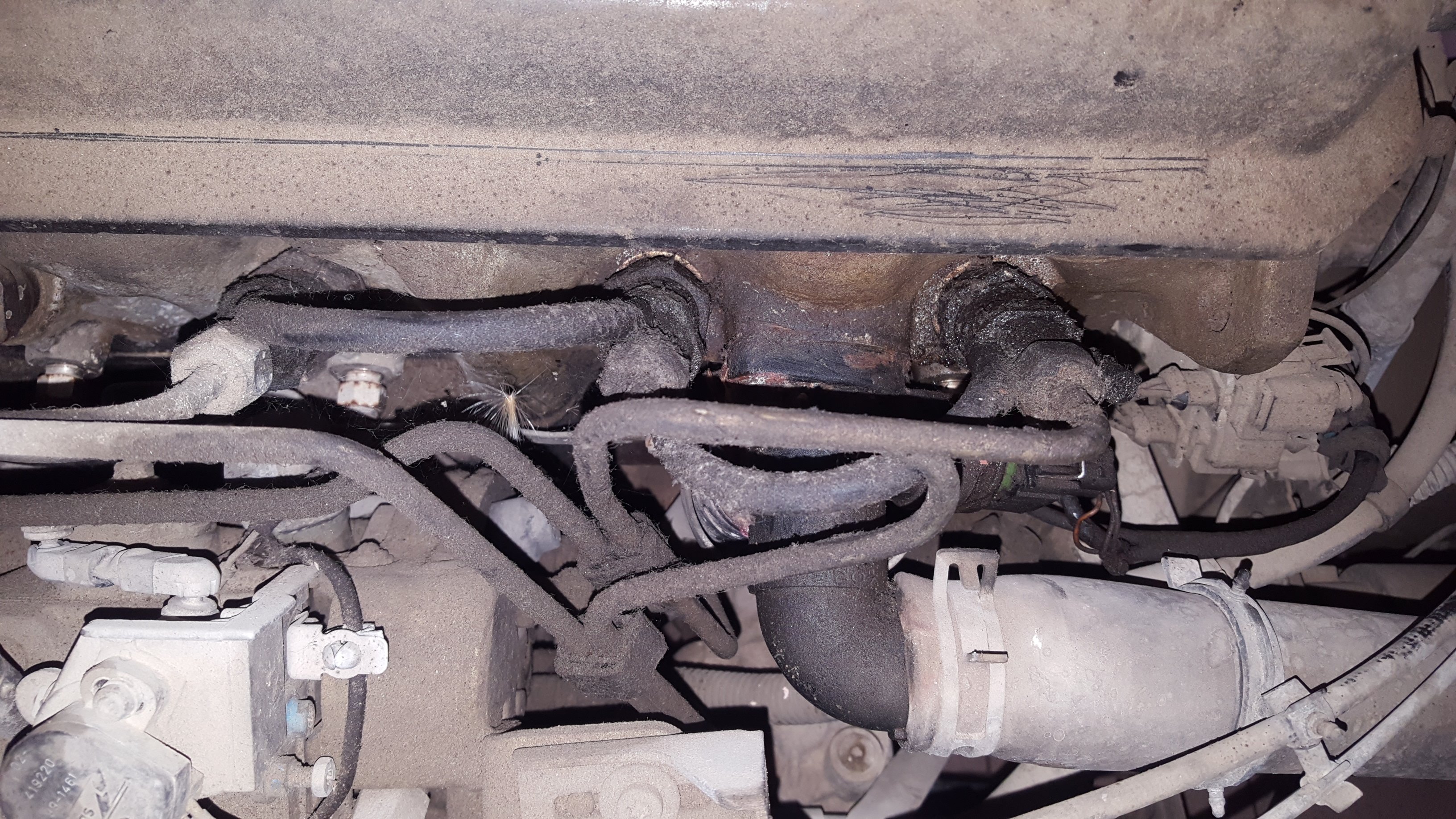

Working on jack for the frontend , i have checked the underbody diesel tubing and seems ok.
But fuel consumption seems increase so maybe the Egr valve is not working correctly? I have bought a egr cleaner and i want to check the actuator tubing.... hopefully.....

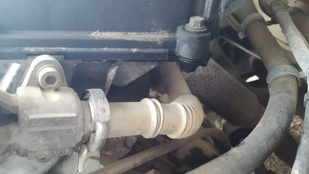

I have also bleed the fuel filter(200ml that i left in clear can to see if there was water) and i notice that the bleeding nipple is very "strange": unscrew a quart of a turn with the vacuum pump connected the nipple has a play and i have to push it up to let the fuel flow out and it has a lot of air bubble( like foam) . I drained about 400/500 ml of fuel and engine fire up quite easily( i have to fire it 2 times becuse at first it starts than cut off and then fire and stay on) . So this means it can be other air stuck in the circuit? May be i have to replace the nipple?
More over, 2 or 3 weeks ago i washed the engine and since then only 1 injector seems to be coming back very very little oily on its body .
Until this morning driving to work the engine still bogs , but something seems to be slightly changed...
Now i will try to clean the egr valve and change the temp sender.....
Opinions!?
Regards

OK on EGR valve. Not yet on CTS as it is VERY dependent on two things: air pockets and correct level of coolant in reservoir. Other things that may influence the readings are: debris in front of the radiator, radiator air deflector missing, old radiator hence poor cooling, and debris inside cooling system. I think the CTS is good.
It is your call but from your description it looks you are onto something.

Do you think i have to change the nipple?
I don't know where it is (needs physical access to vehicle) but I'm sure you have an air leak into the fuel feed somewhere.

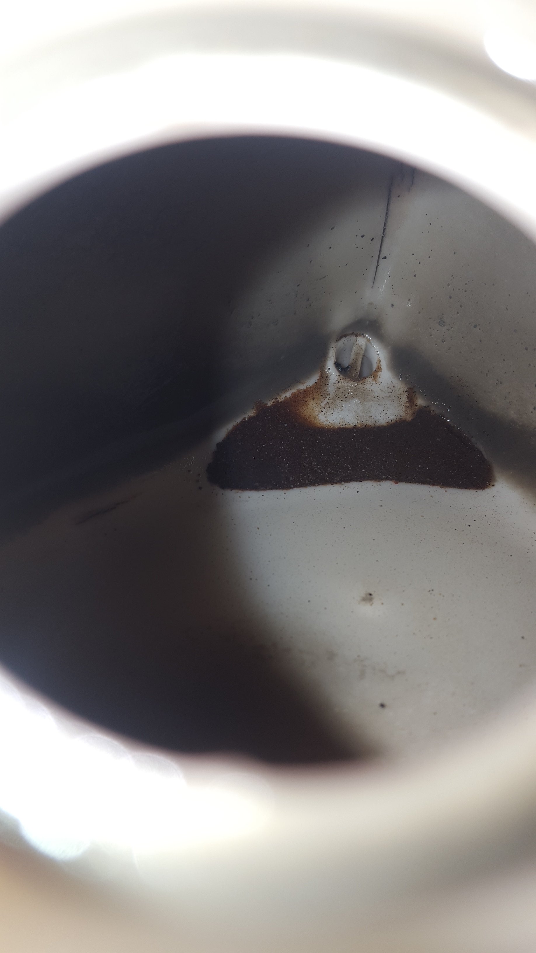

Yes the picture is of the expansion reservior. Seems like there was debris dark gray that i washed before refill with new coolant
May be is the bleeding nipple...

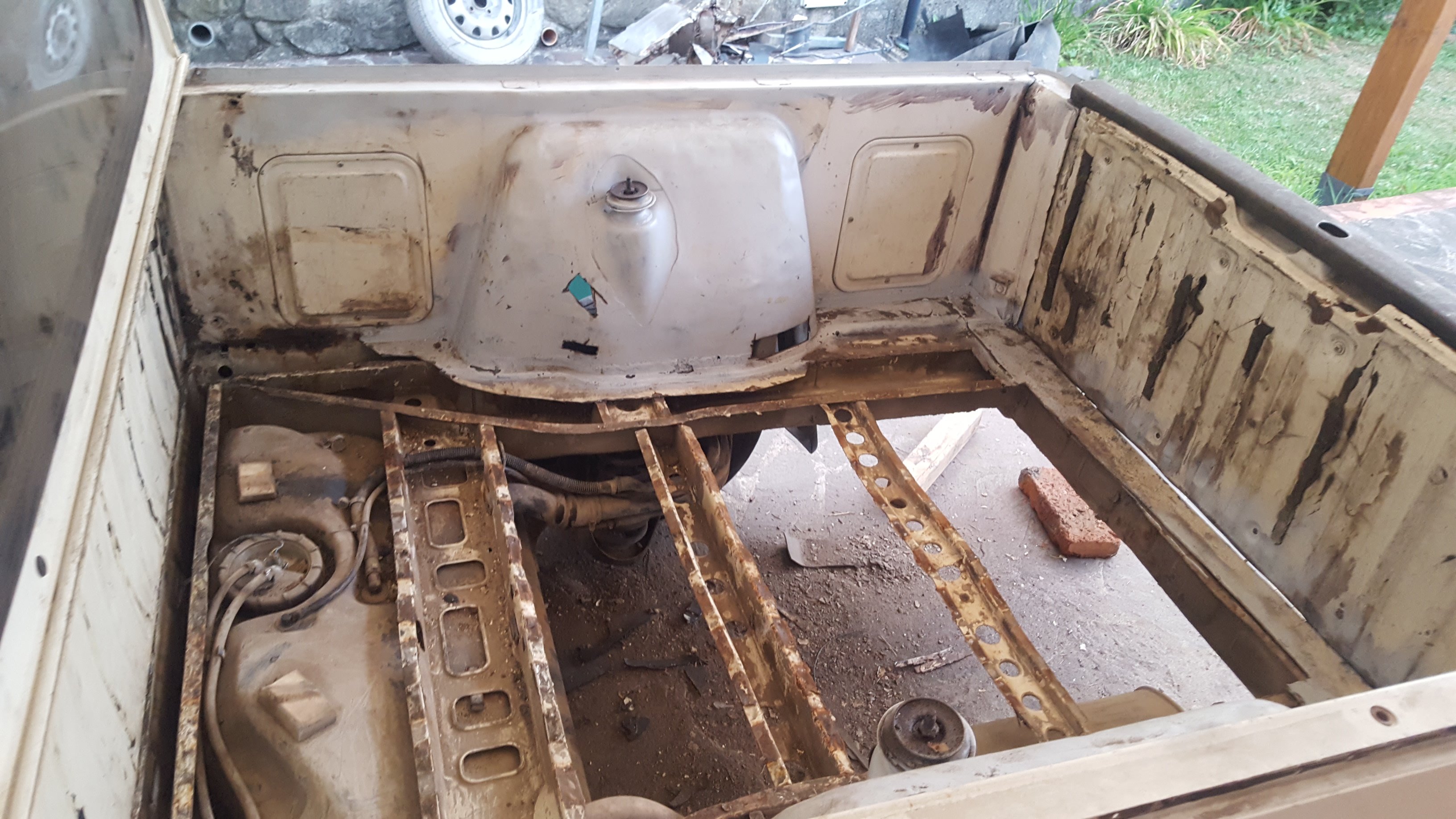

Hello everybody! I didn't have give up on the felly , but i'm working on the bed becuse of the weather that allow me to work outside....
Referring to the main reason of the topic ,during the work on the bed i found the fuel tank vent pipe to be clogged by mud so cleaned up but i 'm not able to take a test drive due to bed needing to be welded.... could it be the clogged vent pipe a reason of bogging?! The restoration continue!....
