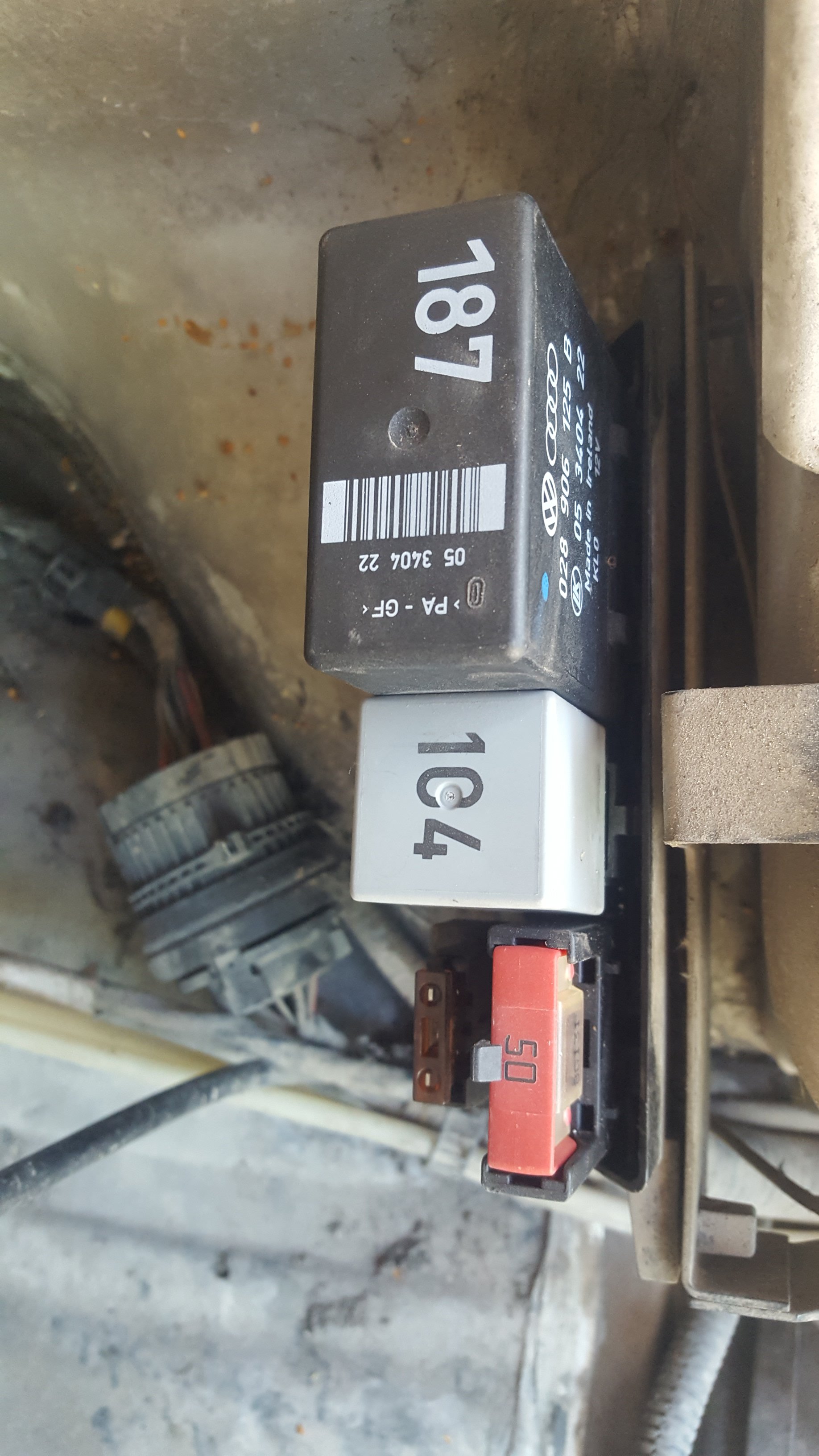

Ok so today i have a quick look in the fuse box under the hood and in the picture they are. The red 50 one and the one in its back, according to user's manual, should be for the pre-heating. The other 2 are supposed for the cooling fan. Is it right?
Then thanks to my girl , i try to figure out the noise i defined "meow". Seem to be much easy to hear from under the car than over . So it could be the water pump? If i will change the pump , auxiliary belt , is best to change even the tensioner pulley? Any suggestion for a brand of spare parts to buy?

Hi, I just tried to look at how the fan is controlled on a Pick-Up, and found something else that I wasn't expecting.  According to this page the resistor for the low speed operation of the fan (item 17) appears to already be external, unlike the version I talk about repairing in my guide that you linked.  It could still be a problem with this resistor, or the wiring to it, or any of fuse/relay/thermoswitch etc. but my guide will not be as relevant as I expected.
I don't have any wiring info about the Pick Up model, so not sure how the fan is controlled.  Do you have an owner's manual with fuse and relay information?

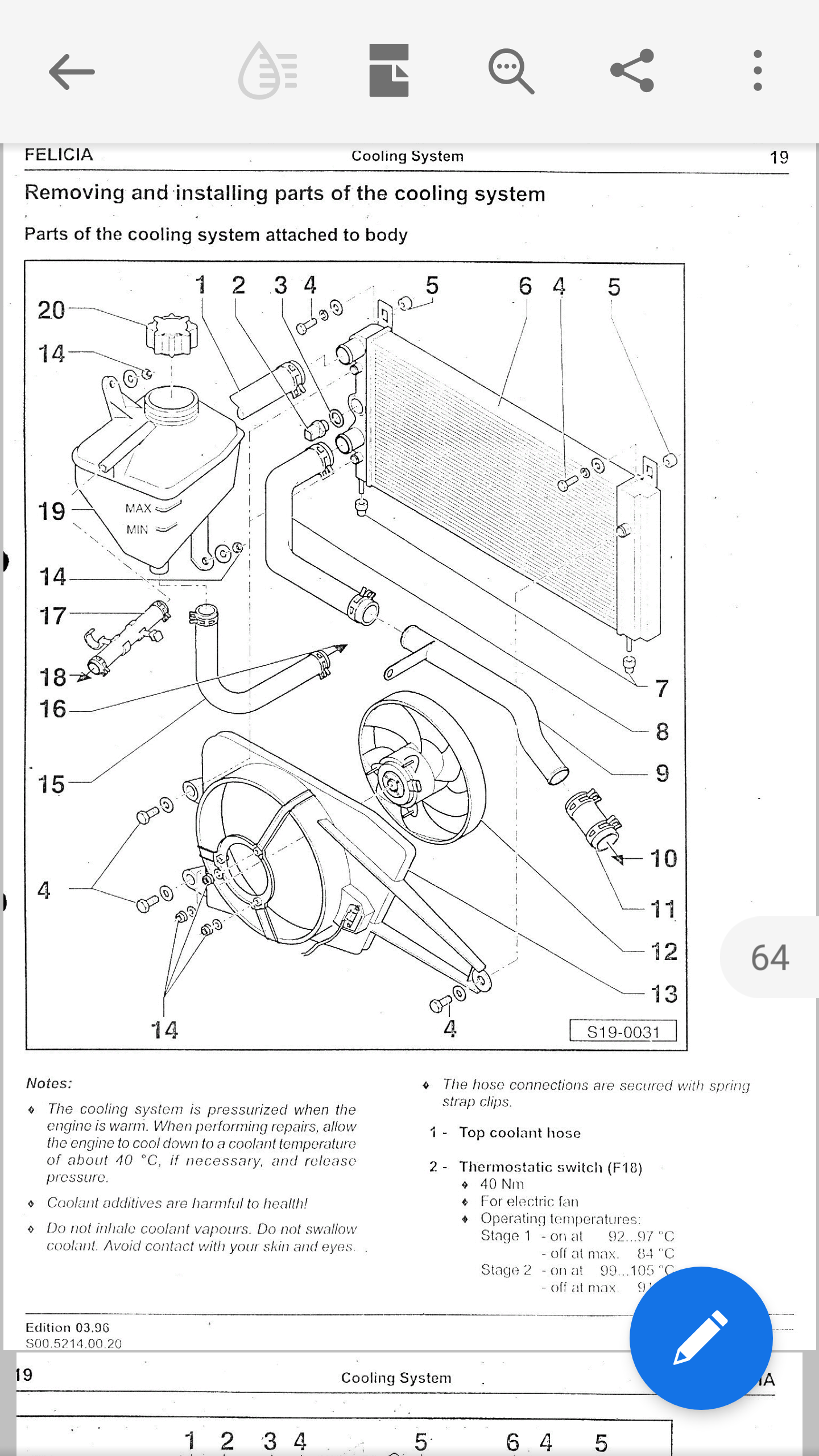

Having a deeper (targeted) look at the cooling system of the engine, it shows that could be the thermo switch that operate the 2 speed fan. Could it be?
It show 2 speed operating values.
Than i have some pdf from the shop manual , if you mp your mail i will send to you

Yes, if the car doesn't have air conditioning, it could be as simple as direct control of the fan by the dual thermoswitch.
You can probably test whether everything in the system except the thermoswitch first stage is working OK by unplugging the wiring connector from there, and linking pairs of contacts in the wiring connector with a short length of thick wire.  Keep hands clear of the fan if you try this, and expect a spark when you make the connections, the fan will pull a big current as it starts up.
If you get both speeds working by linking all combinations like this, the thermoswitch must be the problem, I think.  If you still can't get the low speed working, examine the 'series resistor' and the wiring to it.
