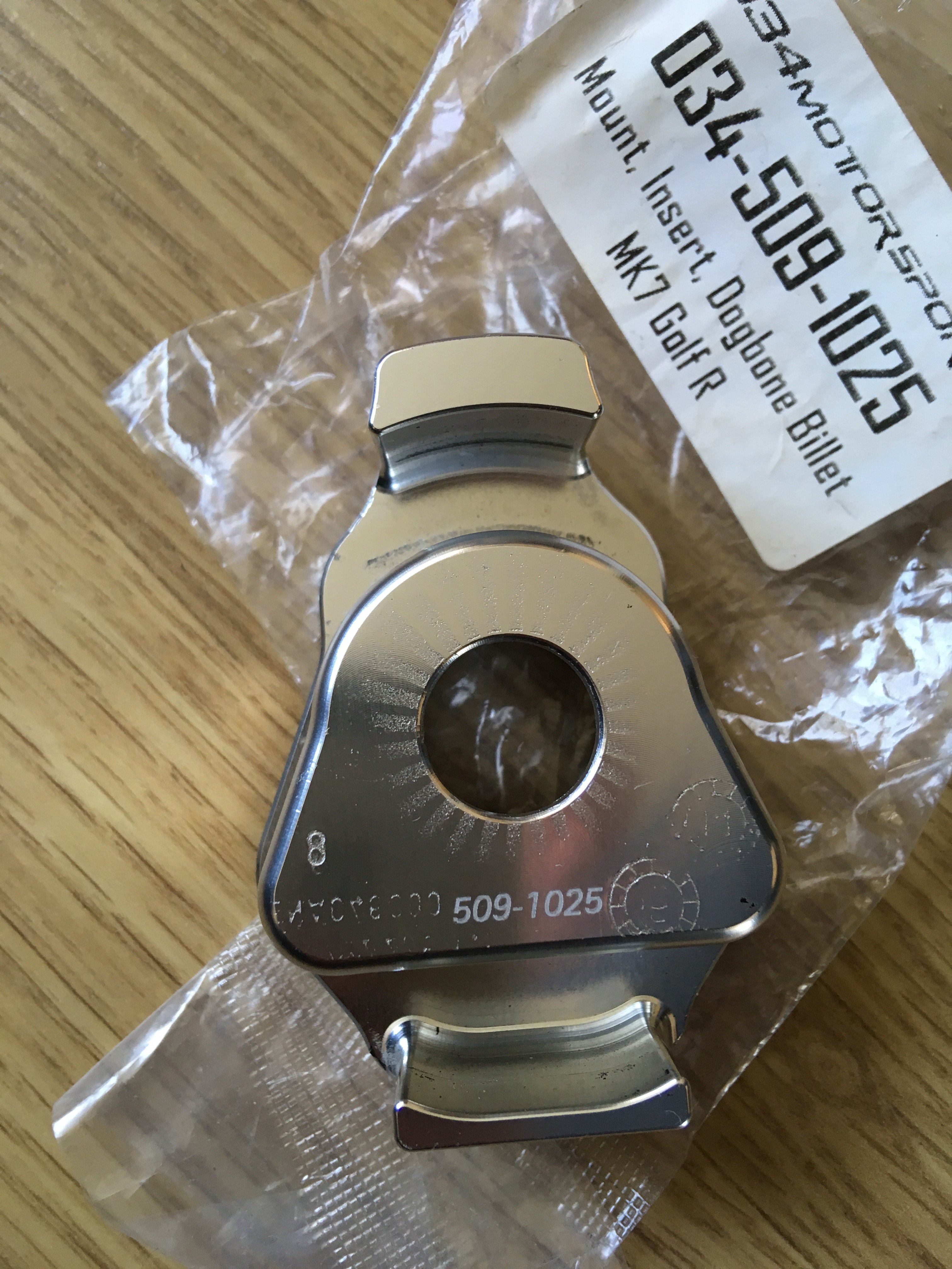

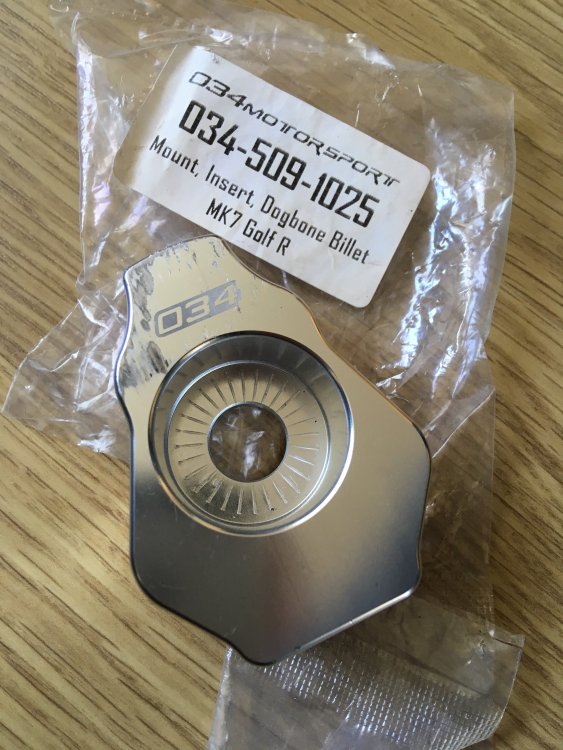

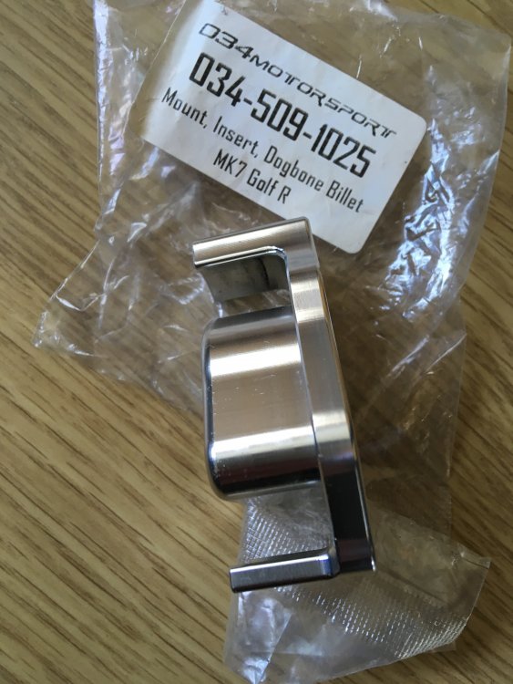

One point to note is that you will need to select 1 of 2 types of 034 Motorsport mount (Version 1 or Version 2)  for your vehicle, depending what is currently in place. I was asked by the guys prior to the service to take a photo of the OEM mount, so that they could identify which one - you can use this guide to check
I've noticed also that since I bought mine, they've added the upper mount as an optional extra - ("The MQB Upper Dogbone Mount prevents the puck assembly from rotating in the subframe housing, which can bend the lower insert and cause premature wearing of the factory rubber in the mount.") - so this may be since complaints from other users.

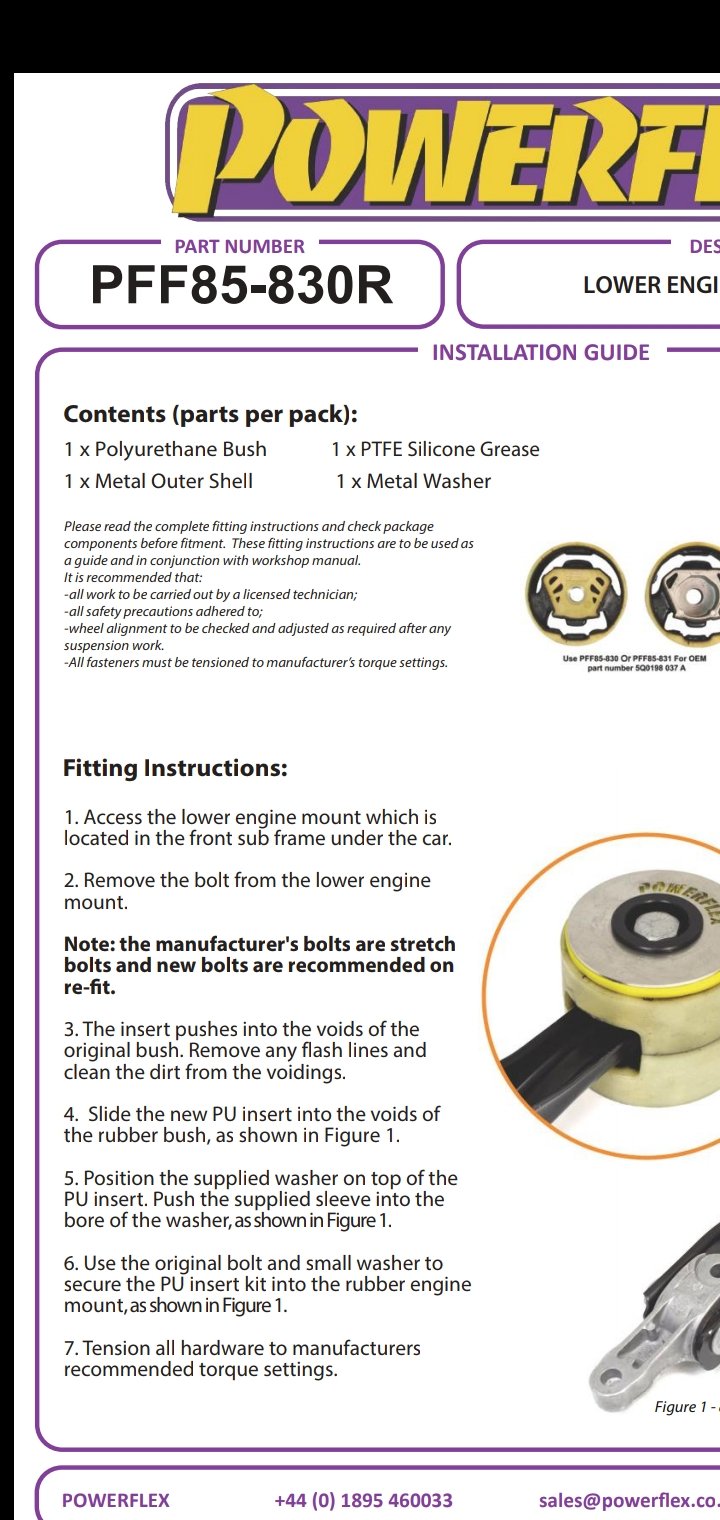

and contrary to what people say, make sure you get a new bolt. It's a stretch bolt, so reusing it could lead to it snapping. They're only a few quid, but if doing then it's worth doing well. I can't place the part number for it. Someone on here will know it.
@tunedude do you have anything saying it's a stretch bolt? I'm not saying you're wrong I just can't understand why they would use such a part in that position.
It's on powerflexs' instructions. The below one is for a diesel. See in bold under point 2.
& point 6. says "use the original bolt"
