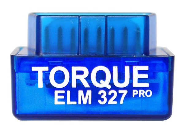

I got the Torque OBD2 reader below in the post - just tested it and it's too wide to fit into the hole size available, so it doesn't fir the Mk2 Superb 🤬 I've ordered the Carista one now which is due next week so can report back when I get to run a scan to see if anything gets flagged up.
