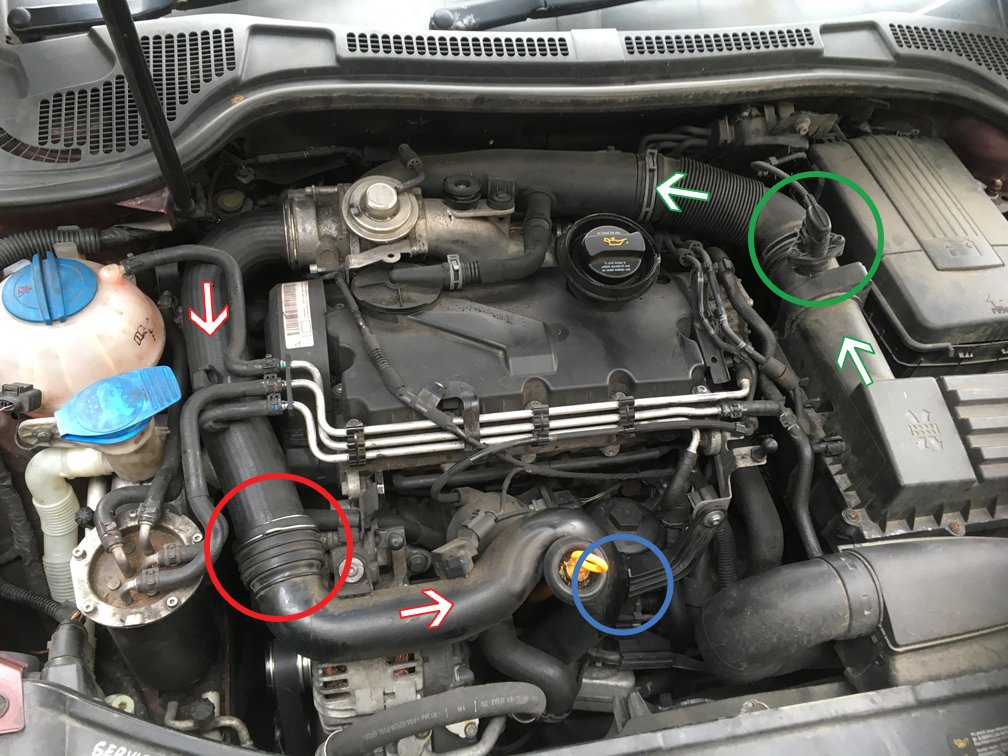

I checked the pipes from the top as best I could before I start looking from below and noticed the pipe connection in the red circle below wasn't fully in place - in the second picture you can see a silver ring that is sticking out, I undid the clip and when I pushed the pipe further into the connection it 'clicked' and you can't see the silver ring anymore so I think it's now properly connected. I wish I'd recorded the whoosh noise to compare as I can't tell if it's reduced or not, but I think it's reduced but is still there somewhat.
I took it for a quick spin on a nearby motorway (M3) and it read 5.5 l/100km average over a 7km run just on the motorway, but the stretch I was on I think is mostly slightly downhill. I'll try a longer drive and see.
I've read that a whistling tends to indicate a pipe leak after the turbo, whereas a whoosh indicates a pipe leak before the turbo - but I've also read that a whooshing can be normal and is just a recirculation valve unloading extra boost when gears are changed but the YouTube videos I've found of the recirc noise don't sound like the dump valve type noise I'm hearing. Just to help me identify things in case I need to go looking for other possible leaks, am I correct with the below (based on the first photo):
  • The green circle is the MAF
  • The green arrows show the pipes for the air INTAKE
  • The red arrows show the pipes coming from the turbo / EGR
I have noticed some oil at the connection where the blue circle is and am wondering if there is a possible break in the pipe there. Given this position is after the turbo/EGR would I be right in thinking oil here would indicate a leak?

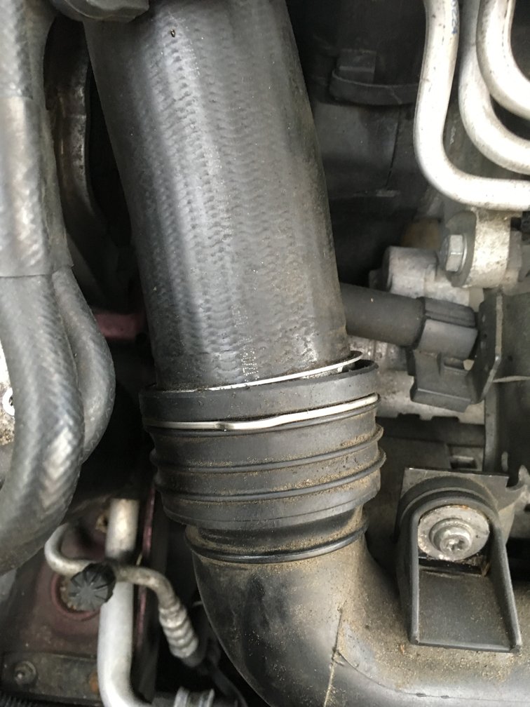

That red connection is the one that I inadvertently did not reconnect properly, for some reason the internal O ring had jumped outside of the joint preventing the clip from engaging.
 Any degree of leak there will dramatically affect your performance and fuel economy, if it was worked on by someone else then I recommend that you remove the pipe spigot and make sure that the O ring is present and undamaged, check any others too that may have been disturbed.
99% certain that you have found your problem.
PS, I believe that some of your arrows are facing the wrong direction.

I think that pipe might have sorted it as a 25 minute run on the motorway gave an average of 5.5 l/100km going one direction and the 25 minute run back gave 6.5 l/100km going the other direction, though if that's optimistic like most MFDs I'm thinking there might still be something impacting. The tyres are 95% new but their rating is E for fuel efficiency - they were on it when I bought it - so they are probably playing a part too.
