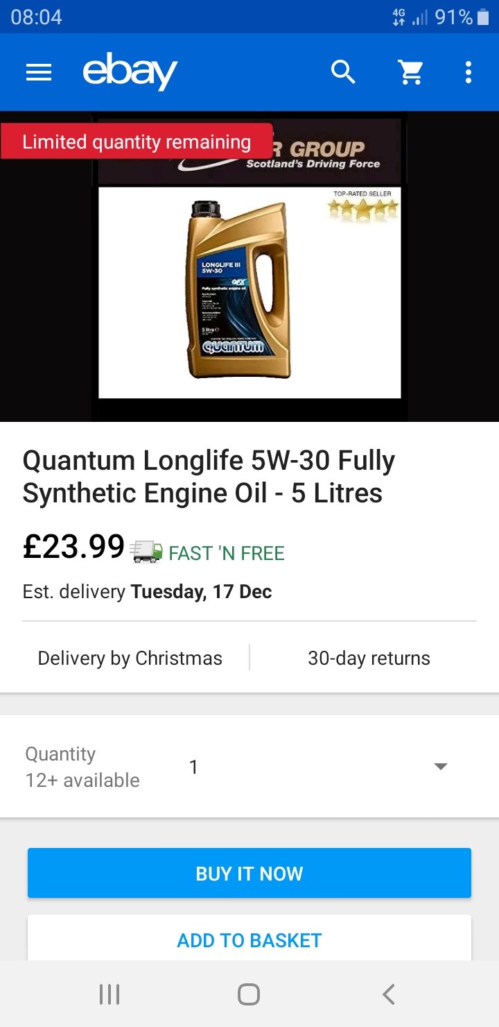

Be careful for future oil changes, the Coma oil you used doesn't appear to meet VAG's required VW 507.00 specification.
You can buy 5 litres of genuine VAG oil (Quantum Longlife III) online for the same price you paid.
This is from a franchised Skoda main dealer in Scotland...
