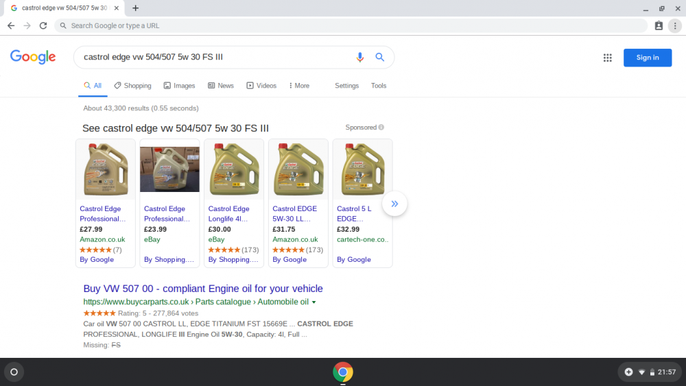

£20 a litre,  where do you pay that?
Even Simpson Skoda would not charge that a litre per Service or in bottles.
Nobody else in the UK seems to be gets any interest from Skoda over a 8 year old car with a lemon of an engine,
good luck with any help or goodwill.
Edited by Roottootemoot
For some bizarre reason, it hadn't occurred to me to go online to buy engine oil! Duhhh - I go online to buy most other things. Thank you Roottootemoot!
