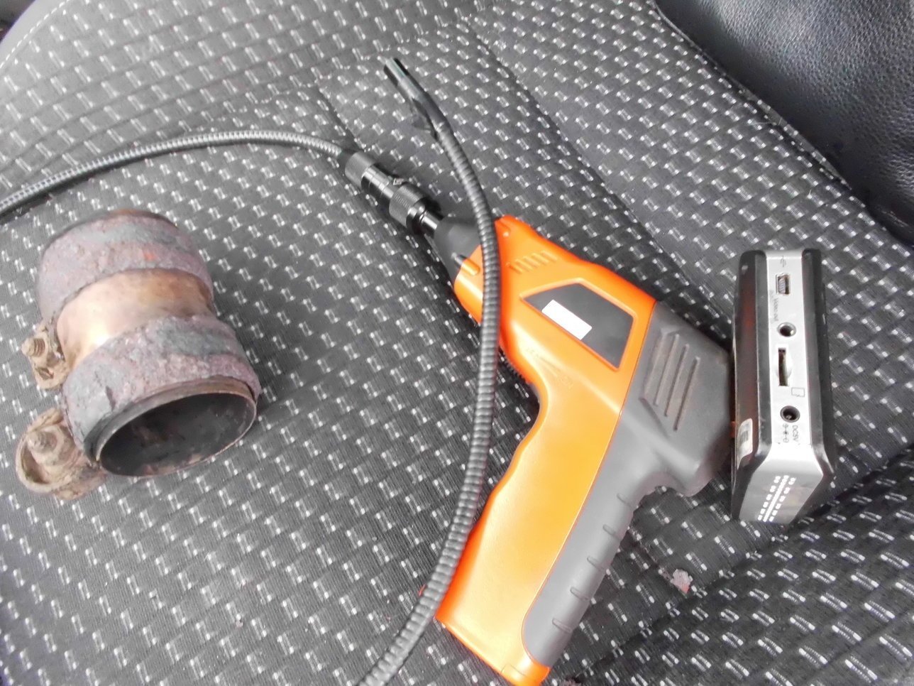

The front down pipe bracket can break, you can get a slight leak, the joint under the passengers seat can leak, these can have the Engine Light come on.
Bottom pick.
This is on the exhaust under the passengers seat. Check no blowing there.

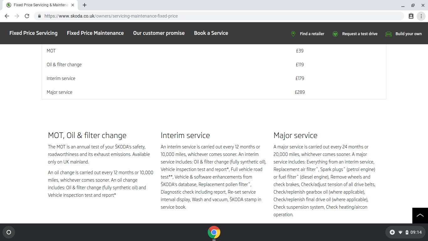

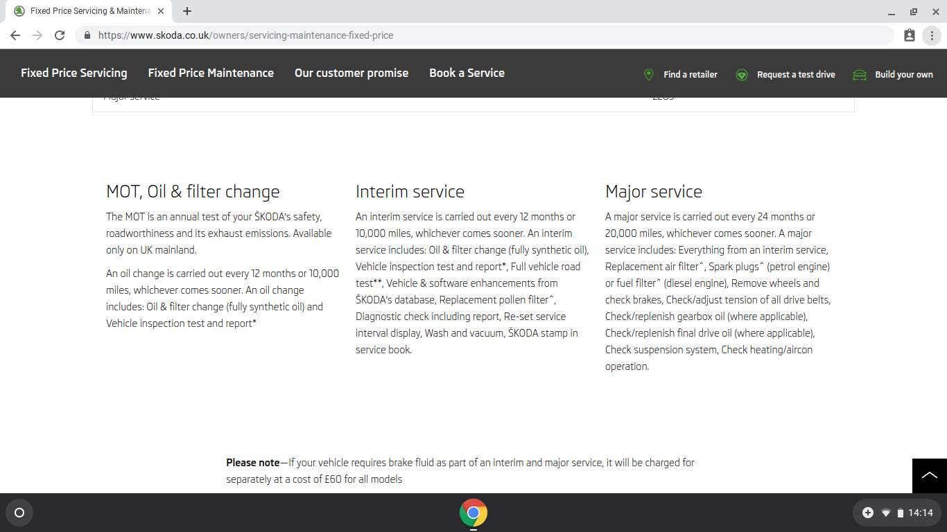

Skoda UK has Fixed Price Servicing at Participating Dealerships on cars 3-10 years old on fixed servicing.
The Brake Fluid change is £60 at a Service.
Never gets Discs replaced by them.
A set of 4 Discs & Pads in around £140.  Get them fitted at an Independent.  Maybe they will take £100-£150 to fit and then the £140 parts.
Doubt you need the AC Serviced.
Sometime Skoda DEalerships have a Brake Fluid and A/C service for arounf £99.
You want maybe to change the Pollen Filter, check the Air Filter and change if needed.
The Oil & Filter change and health check is an Offer at £119.
Brake Service the £60.

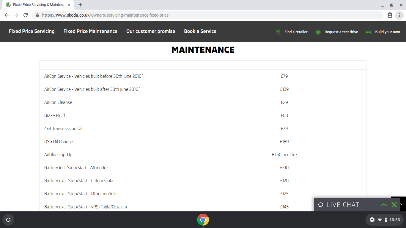

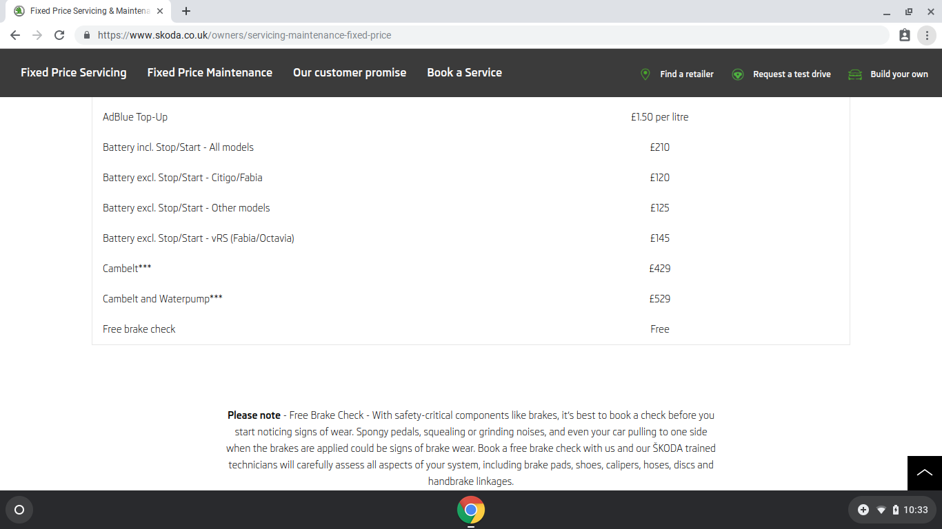

******* Note A/C Service cost on pre 2016 cars. £79 not £139.*******
Someone at the dealership is taking the pith.

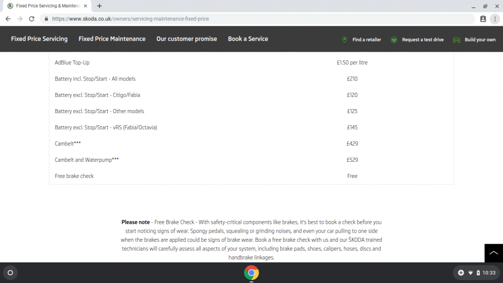

Brake Fluid change is at 3 years then each 2 years,
but then the brake fluid can be checked for H20 content.
