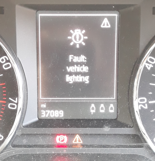

In the last week shortly after turning on the ignition I have started getting the warning "Fault : Vehicle Lighting" on the dash display and the orange triangle shows up - see photo 1.

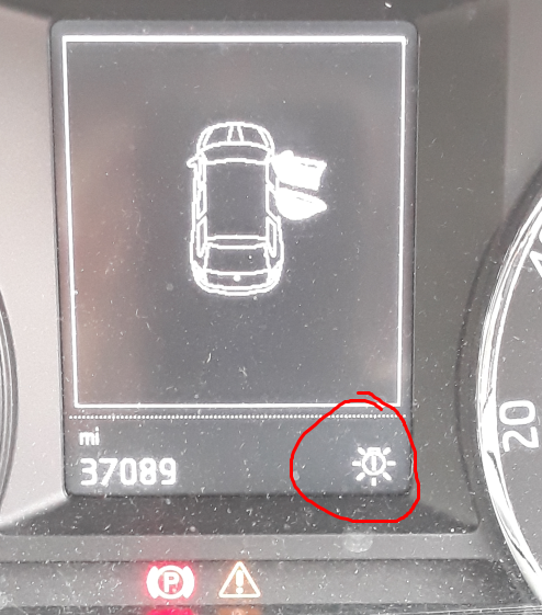

As I drive along occasionally the trip meter in the bottom right of the display will be replaced by a "bulb" symbol for a few seconds.  - see  photo 2.

  • As an experiment I disconnected one of the right hand headlamp bulbs - in this case I get a different error "Lighting Fault : Check R.H. Dipped"
    • In all cases the display on the "big display" - the one with the radio in the center -  just shows a picture of the car with the front left lights on orange, so I think it's a generic error picture.

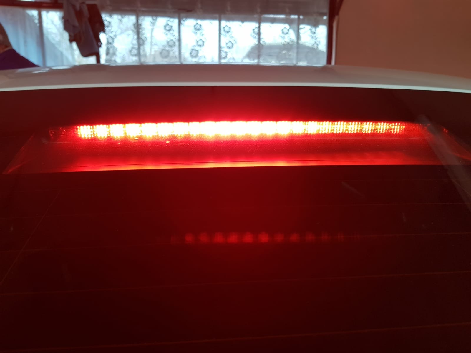

I see something on 3rd light break, the led from left and right from the edge , but i don't know how should be. I've attached a picture..I don't know if are some missing leds...
