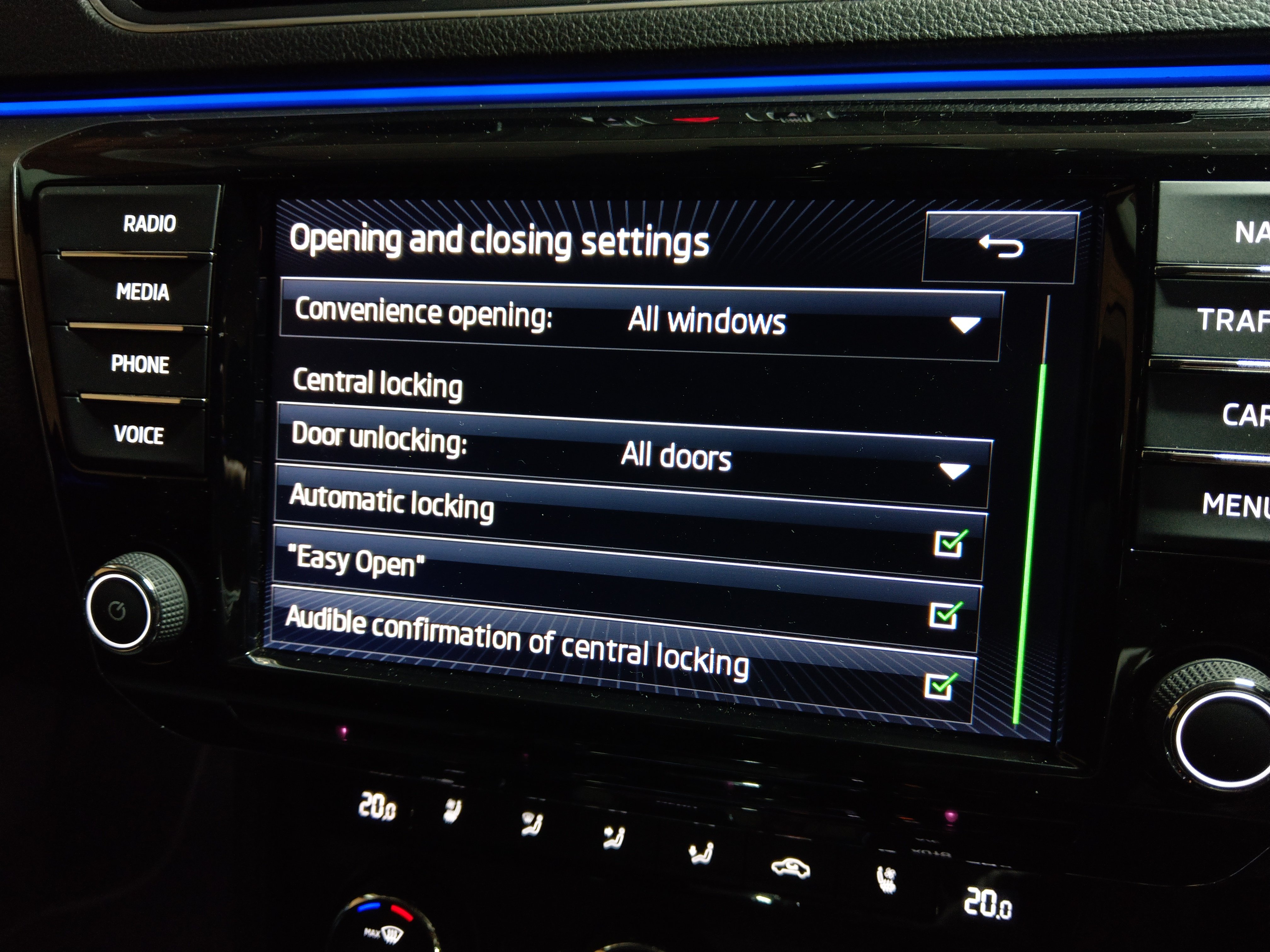

Under Car Settings -> Opening & Closing, untick the "Easy Open" feature.
That only de-activates the virtual pedal/contactless opening though, not the console button, isn't it?

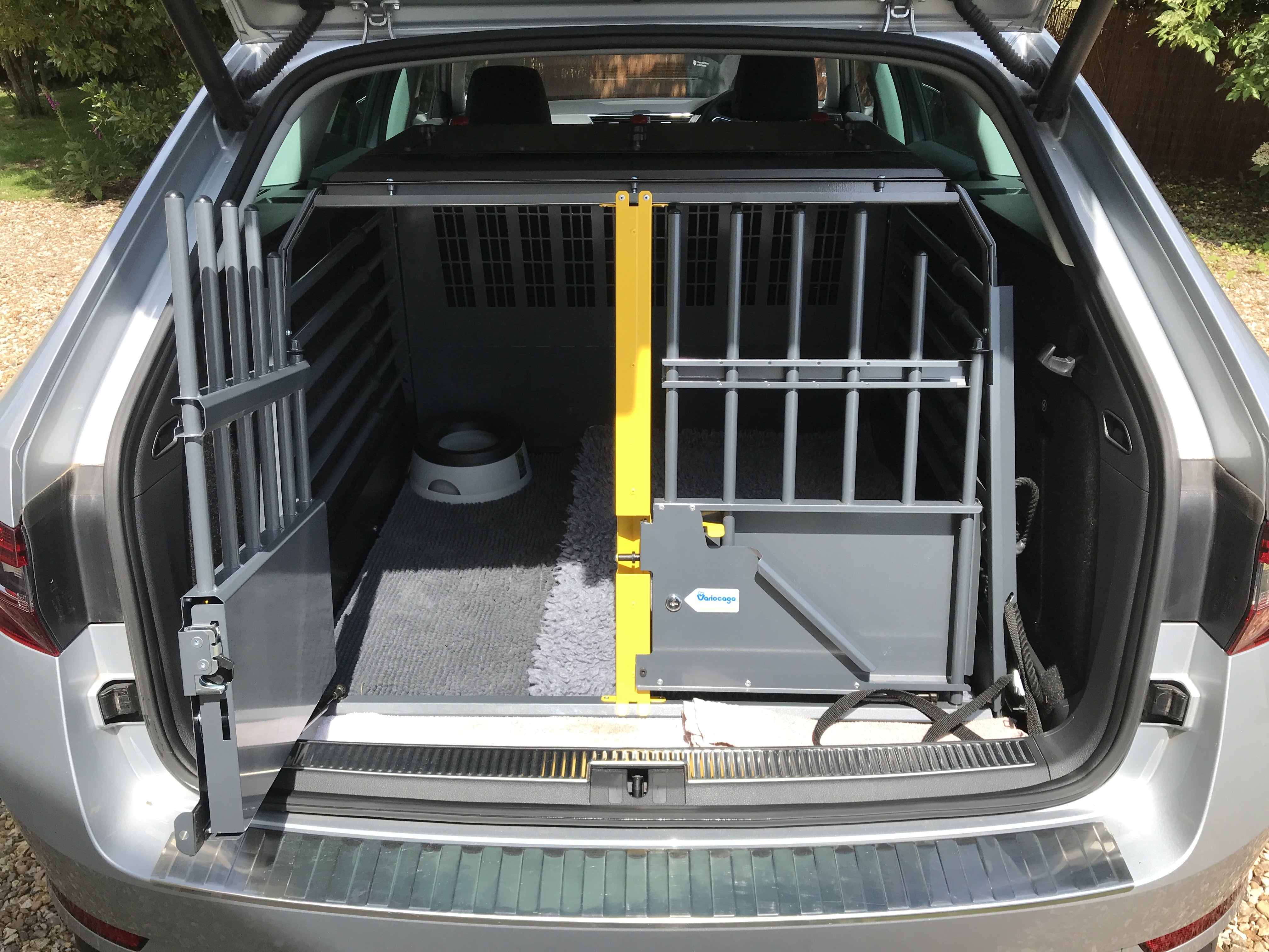

I use a crash-tested Variocage in the boot, which is perfect for our needs, albeit horribly expensive. However, my dogs are priceless to me and I'm fortunate to have had the cash at the time. If I didn't have, I'd have been trying to find one of the harnesses above.
