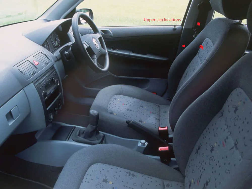

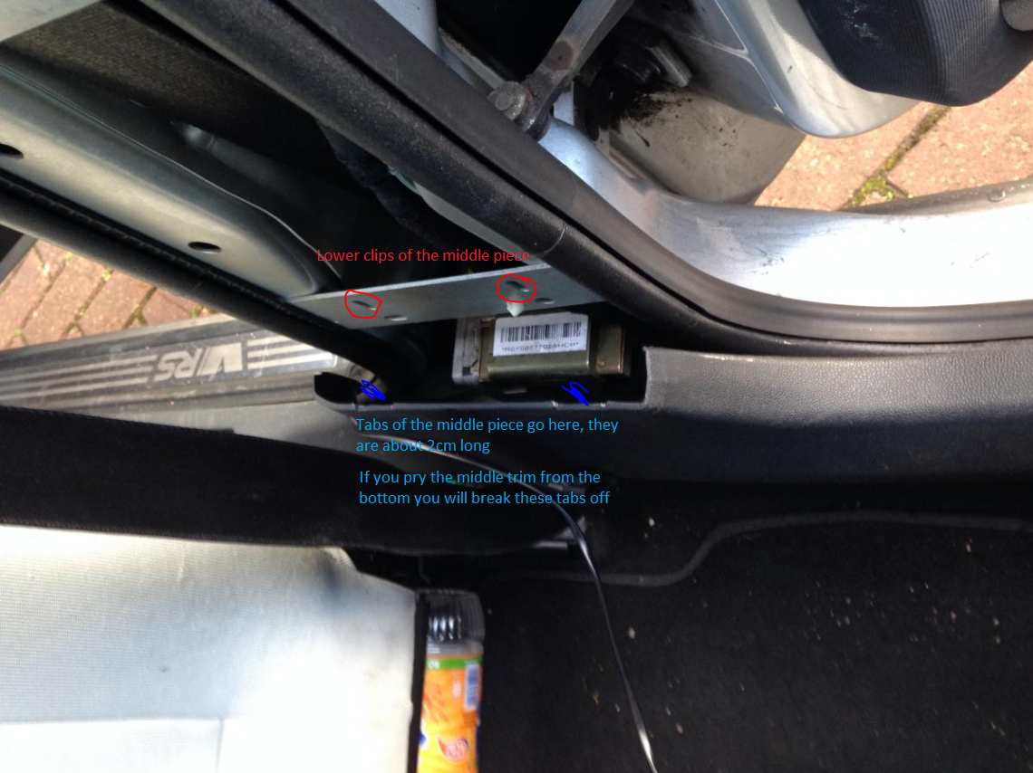

I achieved this over the weekend, for anyone in the same situation the seatbelt can be accessed as follows:
The column's trim is separated in to three sections, the top part which holds the seatbelt loop, a middle piece, and the lower piece that also runs horizontally along the doors. To access the seatbelt mech the top and bottom pieces need to be loosened, and the middle piece removed.
1. Start by prying the top piece at each side, close to the bottom so that both edges come away forward from the rubber strip. This top piece is held in place at the bottom by a single clip which is right behind the seatbelt loop in the centre, once the trim is away from the sides you can get a tool in and pry this clip out. All clips are metal, going in to the metal body of the car. The top piece is now loose.
2. The middle piece is held in place by four clips and two plastic "tabs" which slide behind the bottom piece. This means that you cannot pry the middle piece out at the bottom, you will beak these tabs. Instead start at the top along each side, using a tool pry at each side to release the two top clips. Then repeat the process for the two bottom clips. Then finally the middle piece can be slid upwards and off
3. You can then pull on the bottom piece (towards the seat) to unclip it and access the seatbelt mech.
Refitting is essentially the reverse of removal, but I struggled with getting the middle piece back in to place, I found that I had to locate the plastic tabs behind the lower piece before I refitted the lower piece back in to position. If I was to reattempt this I might try loosening this lower piece first to make it easier to remove the middle piece. It was also awkward getting the middle piece behind the top piece as the seatbelt was in the way. Removal and refitting only took about an hour, and that was working it all out.
A couple of pics attached to show locations of the tabs and clips.
