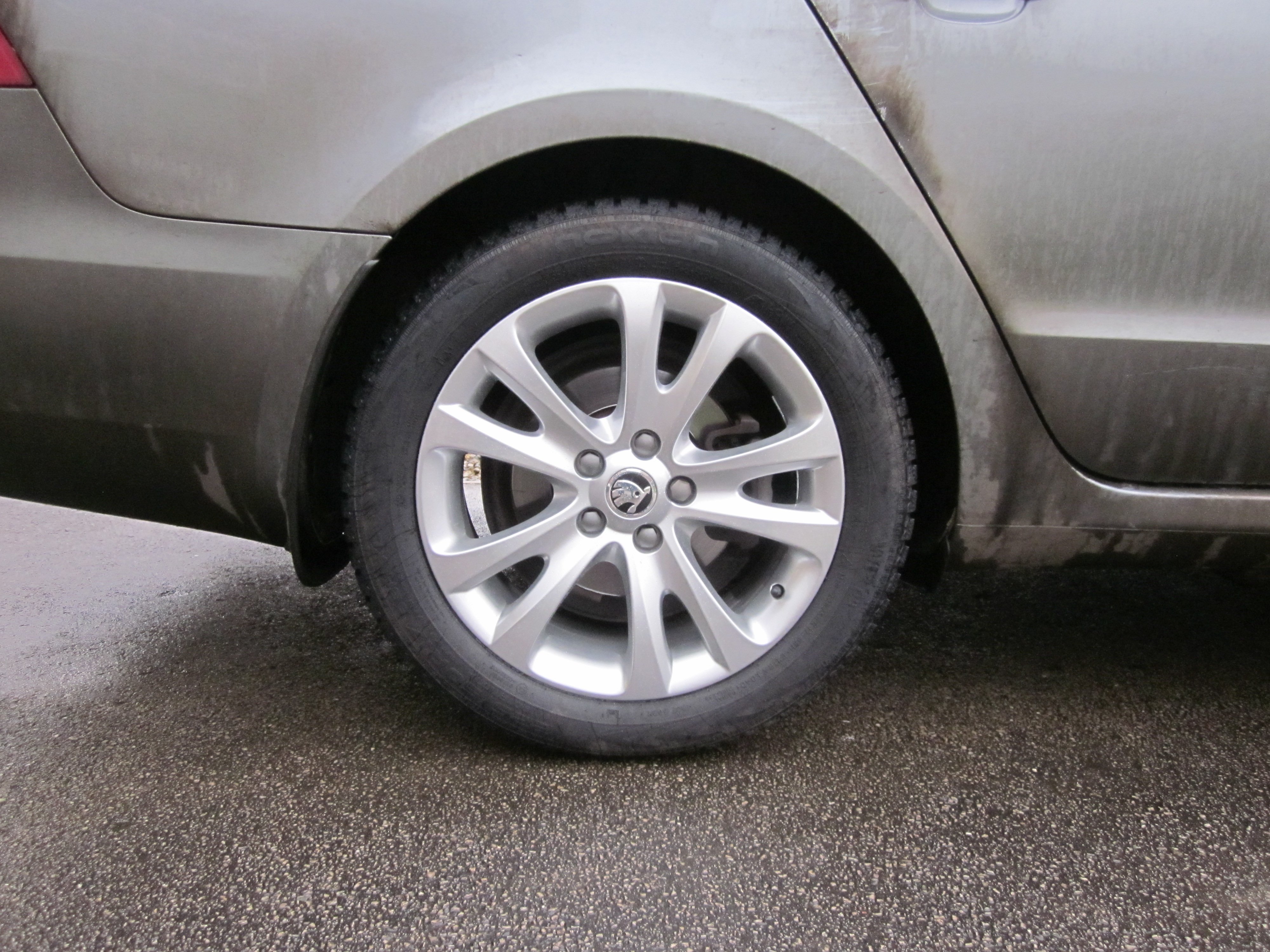

I have the same spare and set of winters 16” 7J x16 with 205/55/16 tyres fitted fine.  Even my Octy 2 Vega alloys 6.5j? X 16 fitted with same tyre size.

Mine originally had 16s (don't know why someone put them o  an Elegance spec car - probably to asset strip it) I did appreciate the comfort but thought they looked terrible, partly because they weren't very nice wheels but mainly due to size (IMHO). I swapped them out for 17s (off an Audi) and think the car looks way better. Not much difference in comfort although I could have gone up in profile on tyre size but no complaints

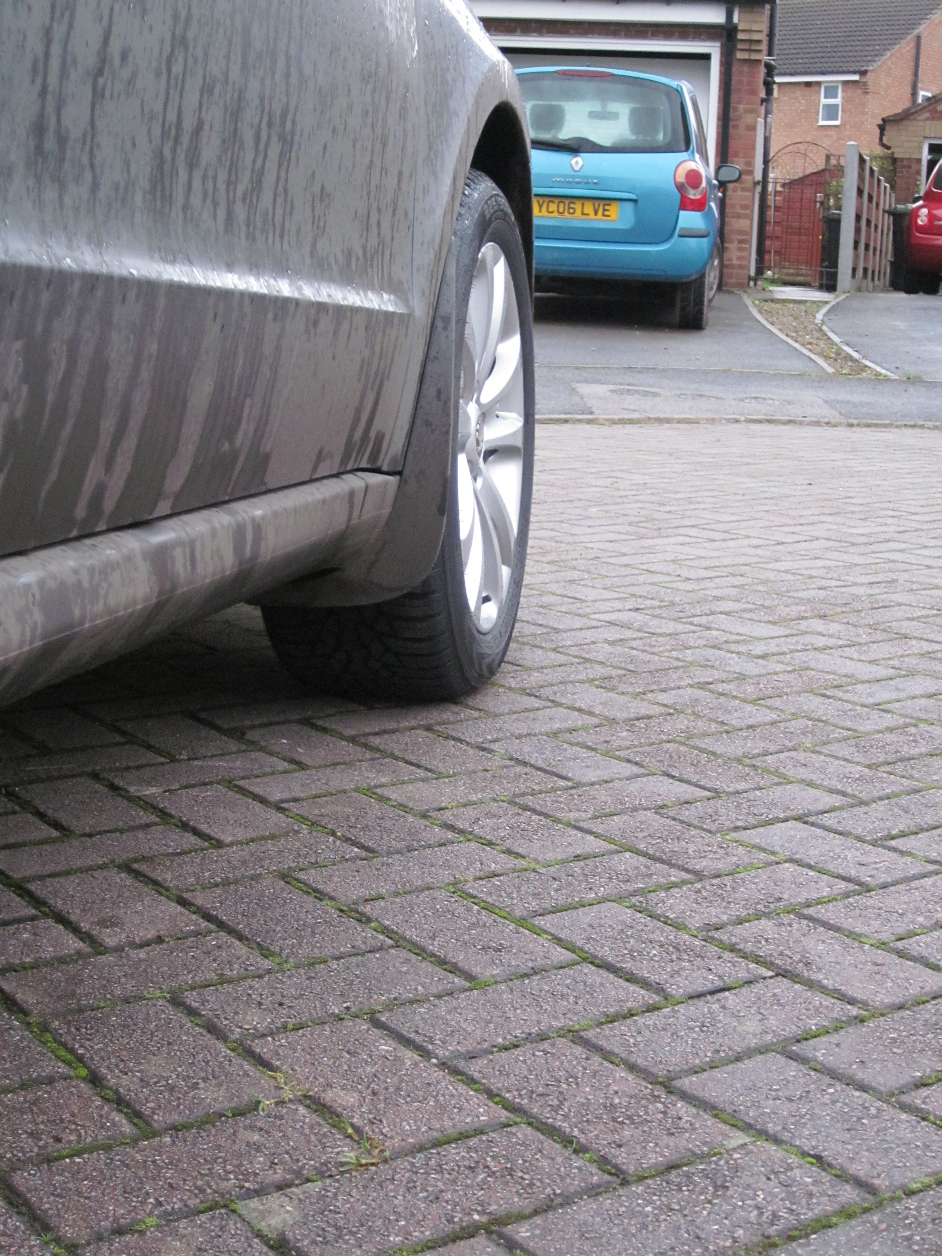

I fitted a higher profile tyre on my 17's.
Best of both worlds, improved comfort, increased pothole protection, and they help fill the arches.
The speedo reads spot-on...
