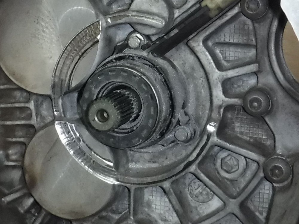

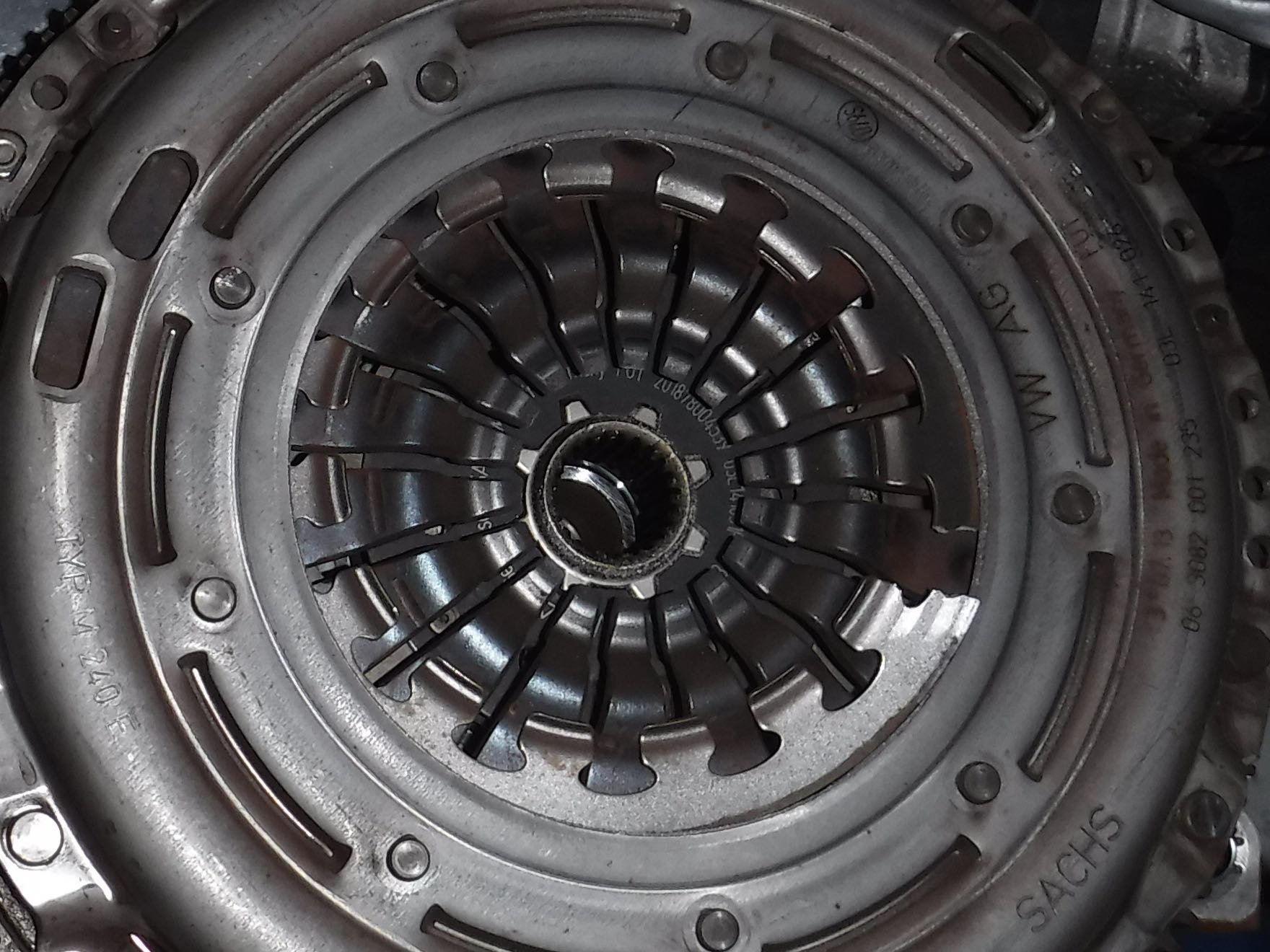

Interesting  take on the dealers / manufacturers response. The clutch failed on my Yeti at 35k miles (2.0L diesel) - the only symptom was a slight judder when pulling away from a stop and a 'scraping' noise which was not audible inside the car. I had to cover the cost of gearbox removal for the diagnosis but was invited in to inspect the damage - it was worth the visit. In my case the damage was due to parts failure Skoda paid some and the warranty company paid the rest of the few thousand pounds as the gearbox needed rebuilt. The dealer was exemplary from providing a car, covering me with their insurance and handling all the paperwork.
