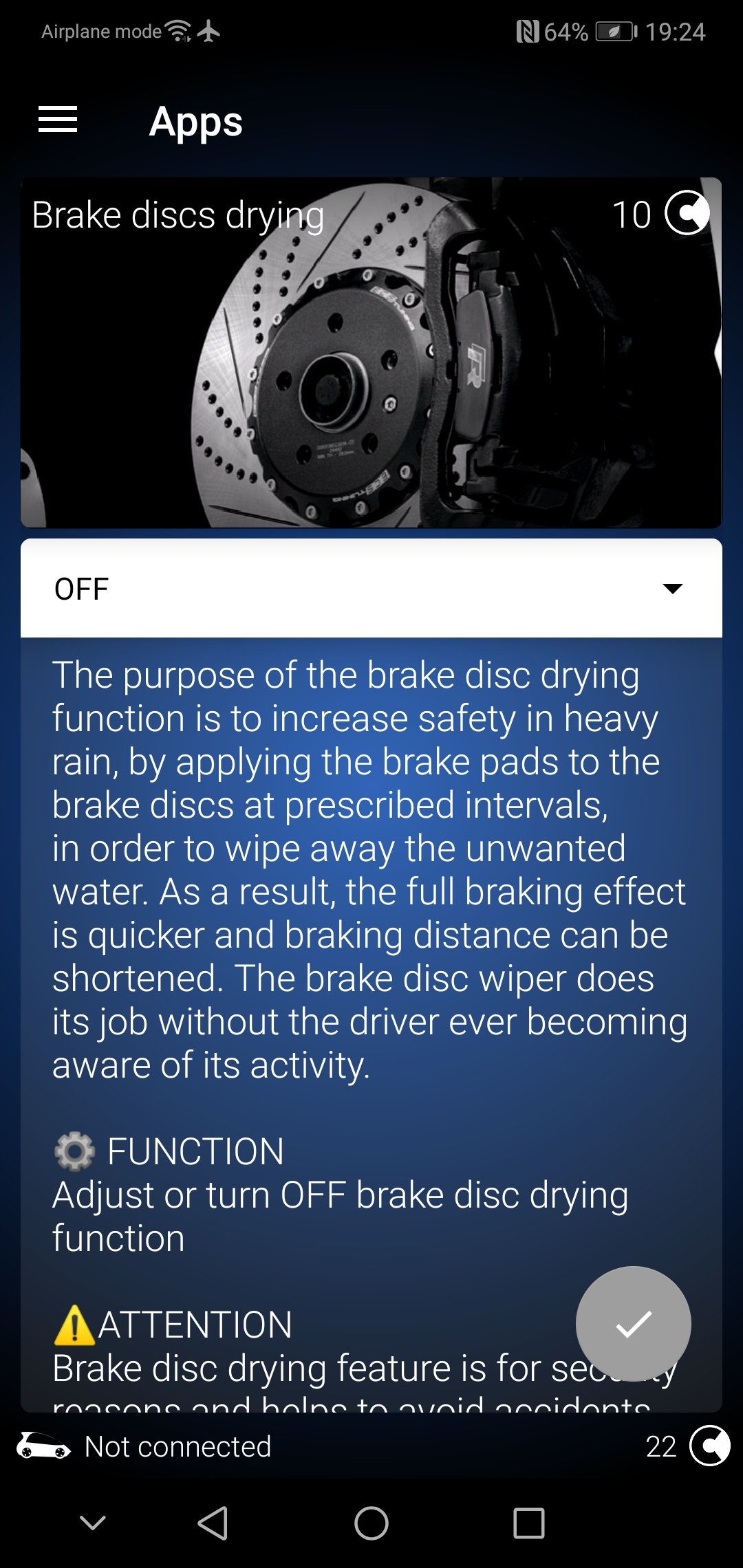

Just to compare, do you people in cold areas experiance knocking noise from brakes when you start driving, especially when hill hold activates, also wear noise until pads/discs clear? Also after parking a car after couple of hours on handbrake rear brakes lock up for a second before car moves? In garage they say it is normal, for me it is a little bit too much, during summer and after some braking it is not present. In OBDeleven there is option to activate disc brake drying, some more info?

I don't know how Obdeleven would activate the disc drying other than actuating the brakes somehow.

According OBDeleven text disc braking is normally on but it is possible to adjust intensity?
