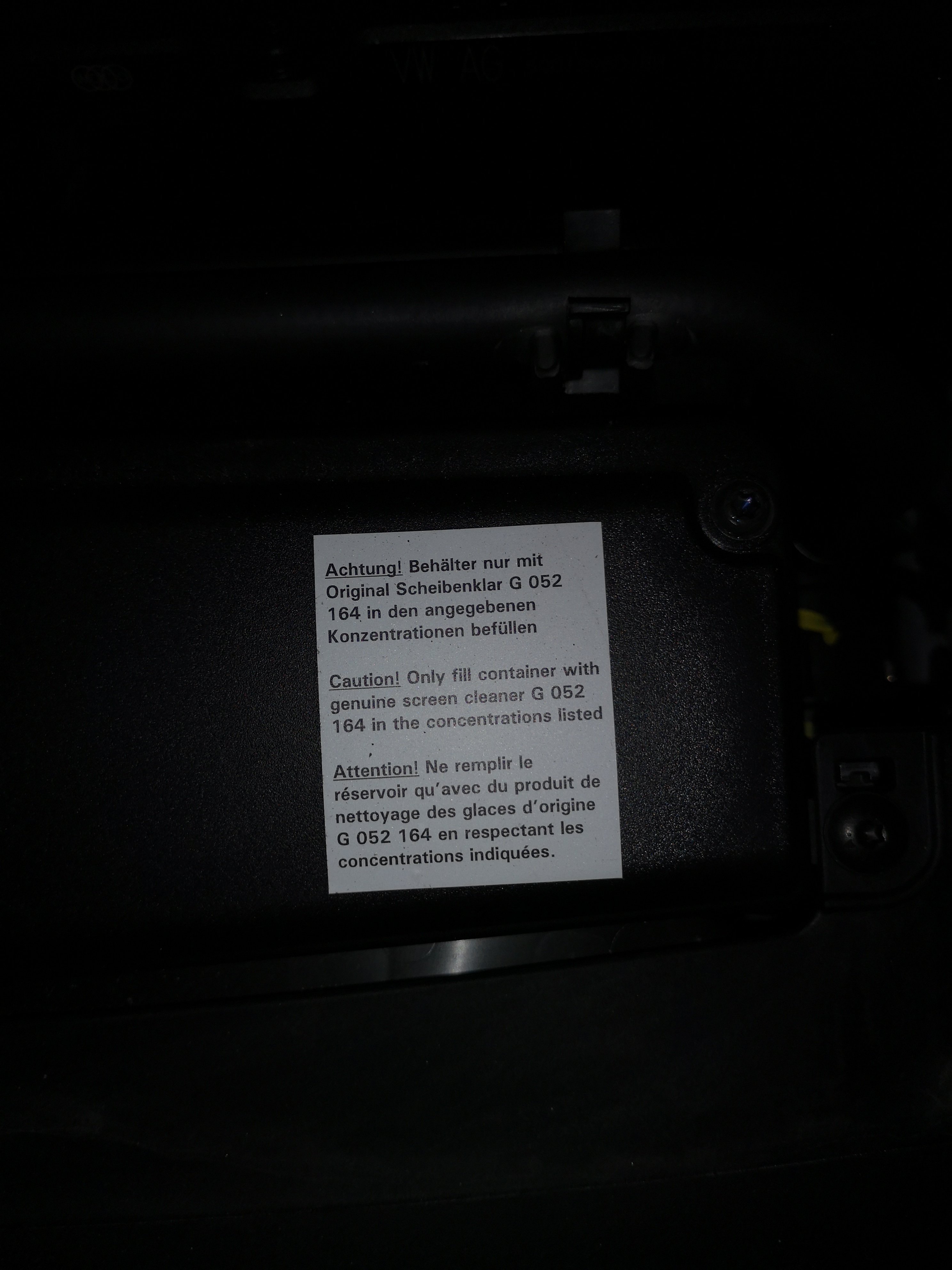

My screenwash needed refilling the other day and noticed a sticker next to the filler cap saying to only use the genuine stuff.
Any chance you could take a picture of the sticker next time you're under the bonnet please?
Took one at the time so I could check the number.

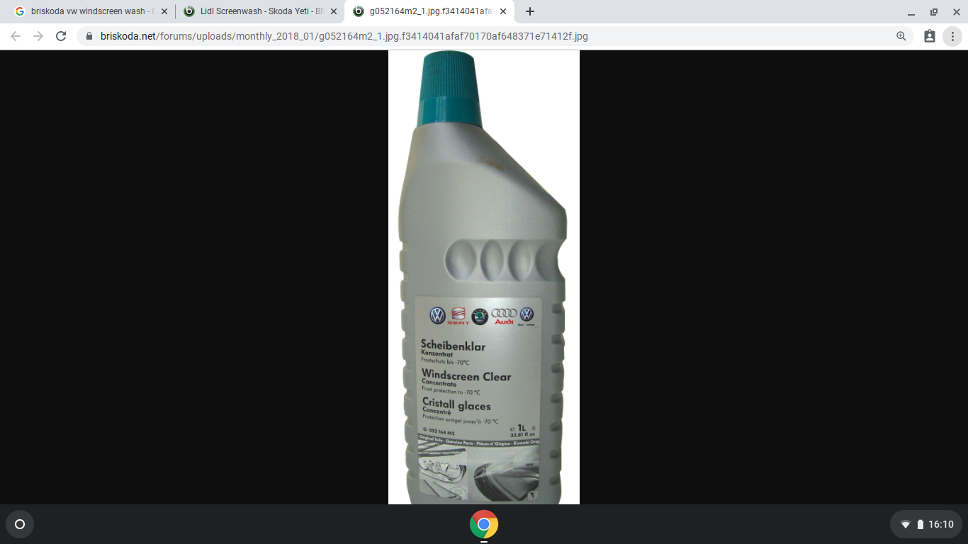

@BriskodaJeff
Nobody at a Service Desk in a Skoda Dealership suggests you use Skoda Windscreen Wash, some tell you you must use VW /Group branded but not manufactured  Audi / SEAT / Skoda / VW  Windscreen Wash or you invalidate your Manufacturers Warranty.
But then Upselling is sometimes all they are trained in.
http://briskoda.net/forums/topic/475412-best-windscreen-wash-fluid-for-removing-traffic-film
http://briskoda.net/forums/topic/474976-screenwash
1 hour ago, Roottootemblowinootsoot said:
@BriskodaJeff
Seen those posts but found it interesting that when I went to fill mine up it had that sticker. Haven't checked the manual so don't know what that says but feel I may stick to what it says rather than potentially paying for new nozzles.
