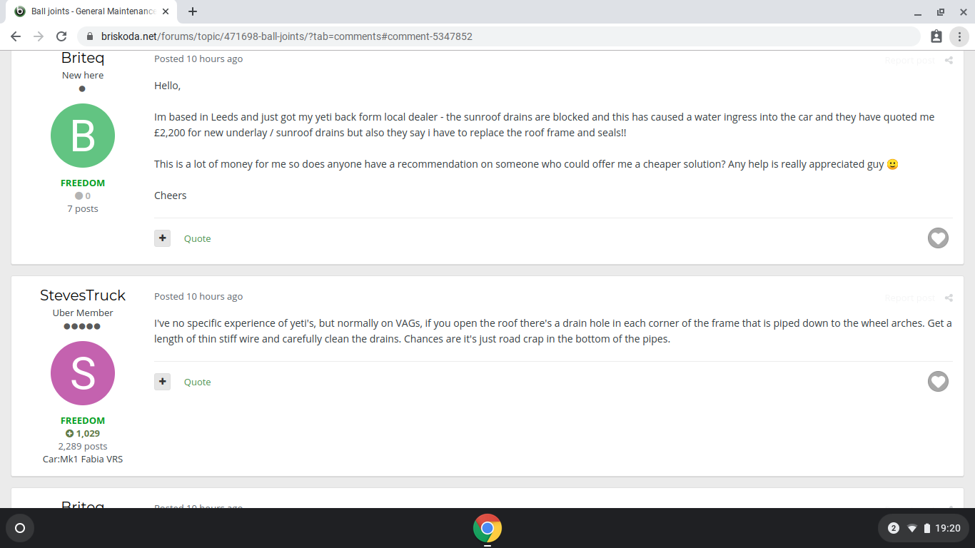

Hello again.. just found out that expensive optional extra of electronic sunroof has also failed with estimated cost of £2k. Does anyone have any Information on this happening? Thanks in advance if so.

However, he has repeated that given the age of the car – 7 years -and the fact that the water that’s pooling on the passenger side might mean we replace the sun roof – cost £2000 – may make this all not worthwhile. (he thinks the water is a problem to do with a drainage channel that runs inside the framework of the car from the roof and out of the car. It looks like this has failed and is leaking into the bottom of the car)”

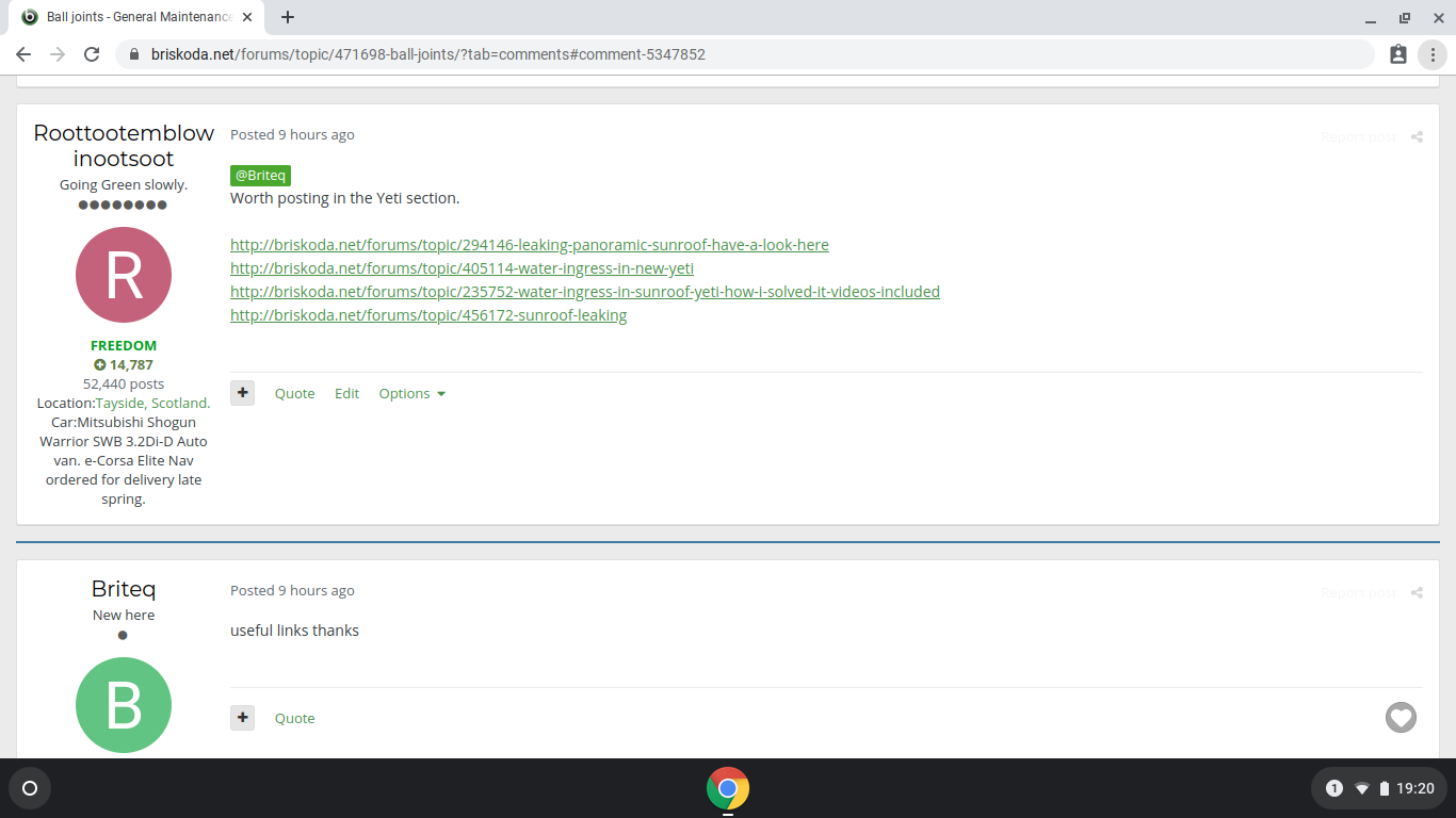

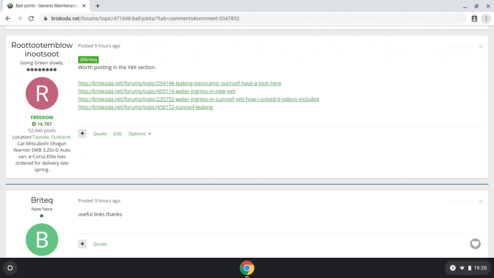

Skoda UK dealerships must be thinking leaking Yeti are the goose that laid the Golden egg.
