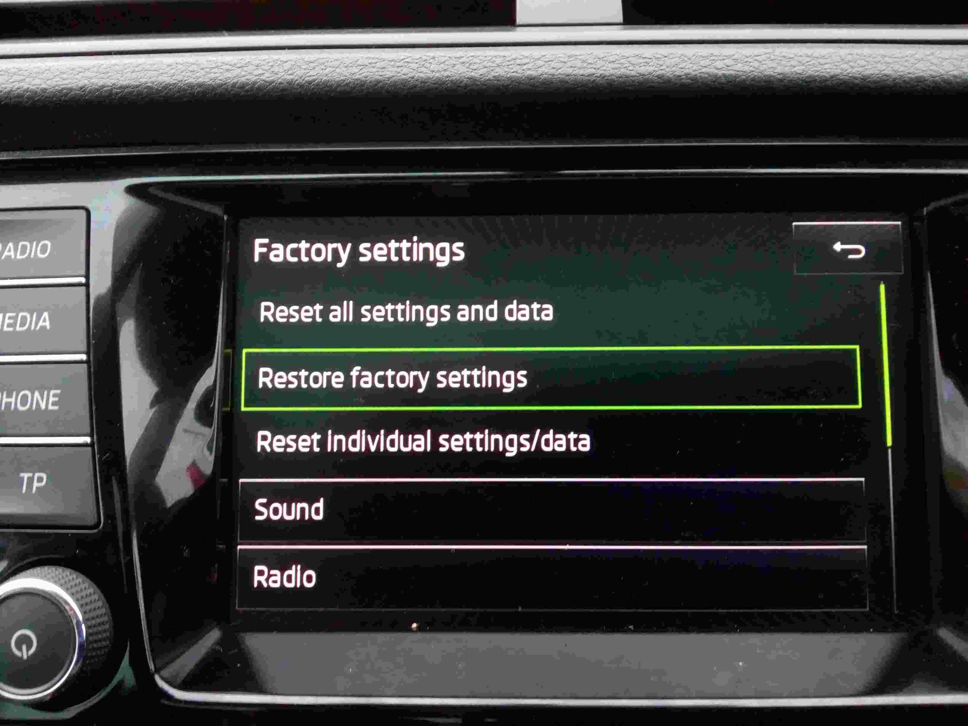

I can easily get to a screen titled "Factory Settings". See picture.
The third menu item on this screen says "Reset individual settings/data", which looks to be the place to make the change I want, but I could be totally wrong!
However, when I twiddle the knob to select this menu item and explore further, the selection frame simply skips over it. ie. it skips directly from the second menu item (Restore Factory Settings) to the fourth menu item (Sound).
There appears to be no way to select this menu item, regardless of the position of the ignition key.

But I still don't know why I can't select the menu item "Reset individual settings/data" - see above. Does anyone know?
If this menu item is not accessible to the driver, only a service person, why is it shown on the screen in the first place?
Hmm just a thought, but have you actually customised anything? maybe it only lets you if somethings changed 🤔 Have never tried.

And also by the looks of your pic your in the stereo menu, click on car and settings from that screen you will find loads of settings
If the entry isn't selectable, i.e. the cursor skips past the "Reset Individual settings/data" entry, then this feature isn't applicable / available on your car.
Individual settings usually relate to electrically adjustable memory seats or personalisation of two separate ignition key fobs etc. to suit differing seating and mirror positions of different drivers.
Thanks silver1011.
I guess my car doesn't have any of these fancy features, then!
