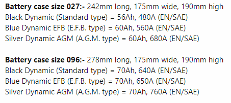

I've been getting the same warning probably once a week. Last service back in July when it was tested it was down to 232 DIN from 320 DIN capacity. The year before, 272 DIN.
Thinking it might be time to get it swapped, before it starts causing me grief. Does anyone know if this is a suitable size? https://www.tayna.co.uk/car-batteries/bosch/s5a05/ From the sites i've looked at, they all seem to suggest a 027 battery for my 1.2 TSI 110.

Well after discovering that Tayna sell the bigger Diesel version, ie size 96 £8.50 cheaper for more 76OA CCA and 70AH, I checked to see if there was scope to fit in a battery that is 36mm longer, but not in the Polo at least as doing that would require replacing the plastic battery tray, so probably not worth the extra cost and effort.

I think that I've seen a statement or table comparing normal, EFB and AGM car batteries, and the difference between EFB and AGM for expected number of engine starts before starting to degrade is quite a bit!

Pretty annoyed that the option to set the type of battery, capacity and serial are a VCDS job only. Means replacing the battery yourself at home is an annoying/expensive endeavour. It should really be doable via the car's settings imho. Phoned a local vag independent specialist and they said they'd only fit the same type of battery that is in the vehicle, wouldn't consider fitting/coding an AGM battery for me 🤦‍♂️
That is not very encouraging at all, I hope that they are wrong and just playing safe.
Now to try to find out if anyone has swopped ELB for an AGM!
Bother!!
From what I've read using an AGM battery is fine, you just need to tell the BMC that its no longer an "EFB" battery and is a "Fleece" battery along with modifying the serial so it knows its a new battery. Without that, it won't charge the battery correctly.
