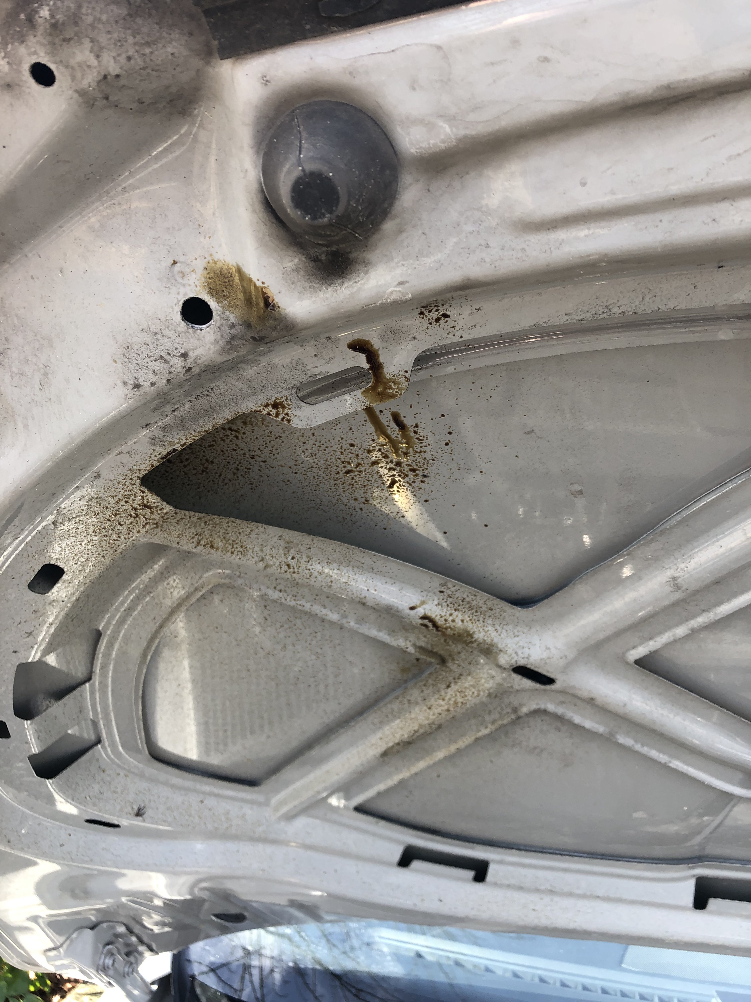

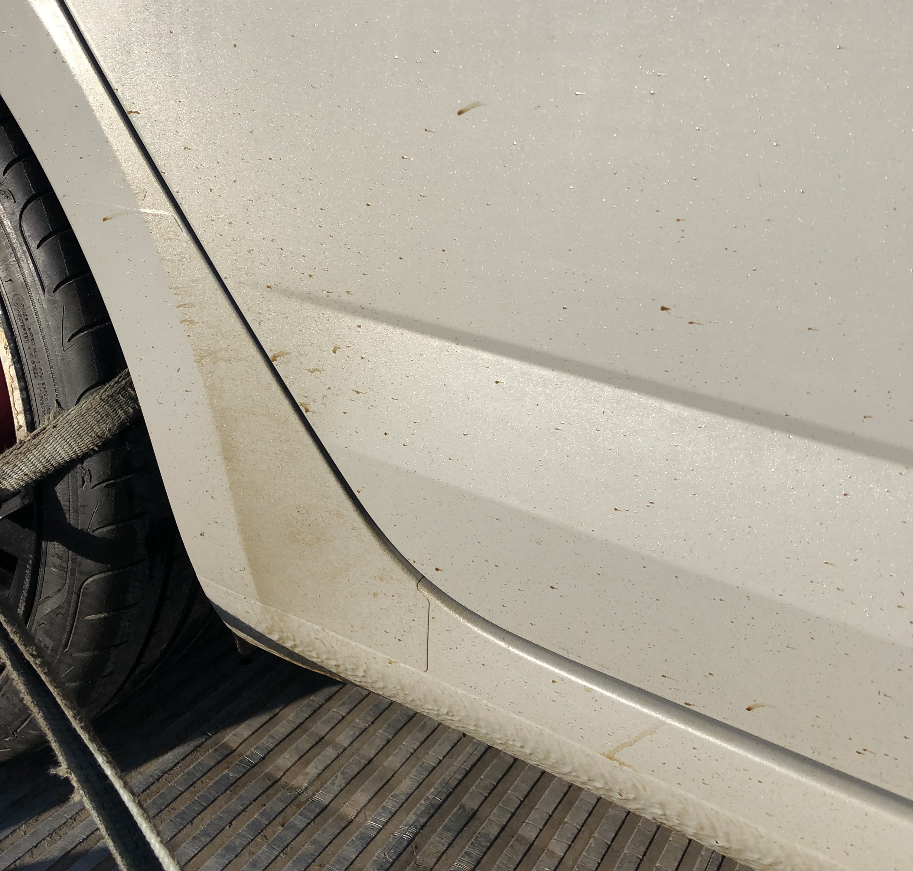

So today all the oil has left the engine and covered the car. Its a VRS230, 33K miles and 1 month out of warranty.
My question is there a known problem that causes this?

That looks more like coolant in the picture, was that what you meant?
Nope it’s oil
I'd hazard a guess and say possabily the oil filter has a problem or the dip stick or oil filler cap has started working loose.
Filler cap is tight, dip stick is clipped in.
Didn’t look like the filter was leaking.
It looked like the auxiliary belt was being leaked onto and then slinging it everywhere.
The thing is I couldn’t see an obvious place it was coming from so was wondering if there is something known to leak?

Bit of a long shot but tried using engine degreaser at all? I was thinking round a bout where there the suspect leak is. Clean it up  - might give a bit more of a clue of the leak is :)
Didn’t get a chance, broke down and had to get put on a transporter. It’s now at the Skoda dealership.
That doesn't look like all the engine oil covering the car. Very little visible mess. I've had worse leaving a filler cap off.
The breakdown sounds nasty though. If you've got a full dealer history and only one month out of warranty and the mileage is that low, then you will get help. Be polite and positive.
