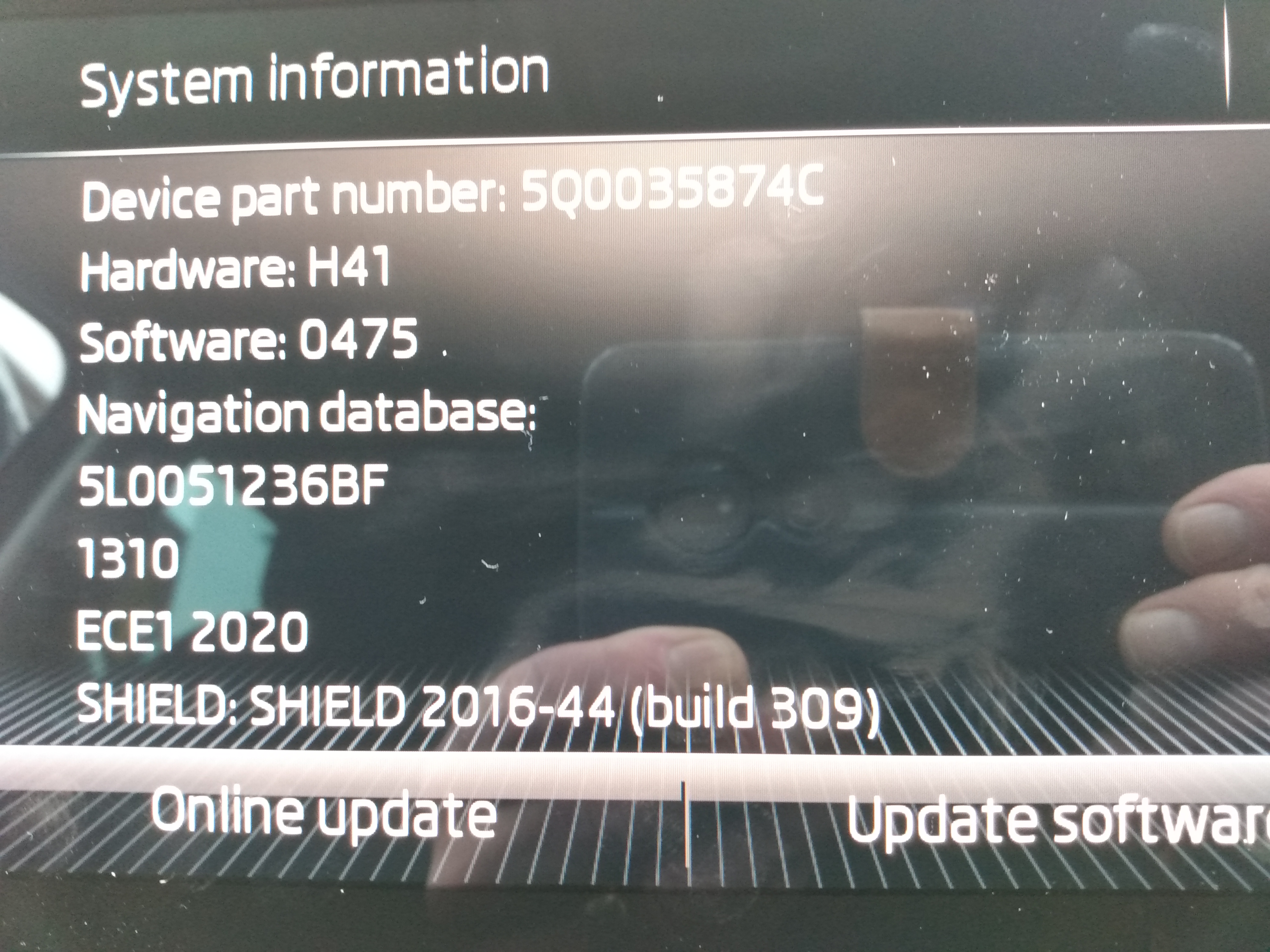

Thanks for the reply varaderoguy - it appears that I have Hardware H41 Software 0475 , so do you think it may help?
Yes; good okay - so that should be fine for the 0478 firmware.  To finally confirm. what is the part number of your MIB system?
You will need to engage with @pab567 who can hopefully help with the appropriate firmware links.
Thank you for replying so quickly 👍
