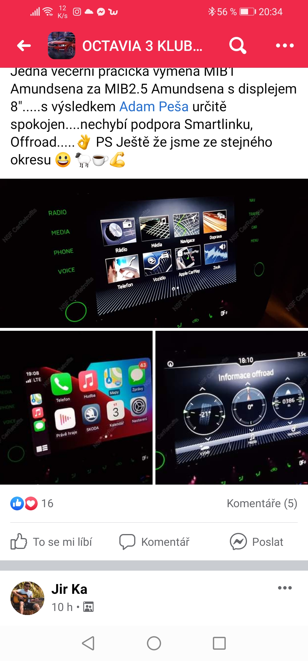

OK than you and one more if its posible put this in my rádio??
New menu (as in MY18 units) - only by hacking the unit
CarPlay - yes, as a part of SmartLink, you should either contact your local Skoda dealer for activation or unit must be hacked
Offroad info - yes, just activate adaptation channels ENG122227-ENG117566 and ENG122227-ENG117568

Whoah, can pre-18 have that off-road info if we enable those channels? Or is it only post 18?
And what is involved in "hacking" Smartlink? Is that a DIY job or do you have to send the unit off? In which case, I may as well pay Skoda (although it hurts that I should have to pay to enable a basic function that is free now) :)

Yes,  pre-18 navigation units (does not apply to units without navigation) have that off-road info if you enable those channels.

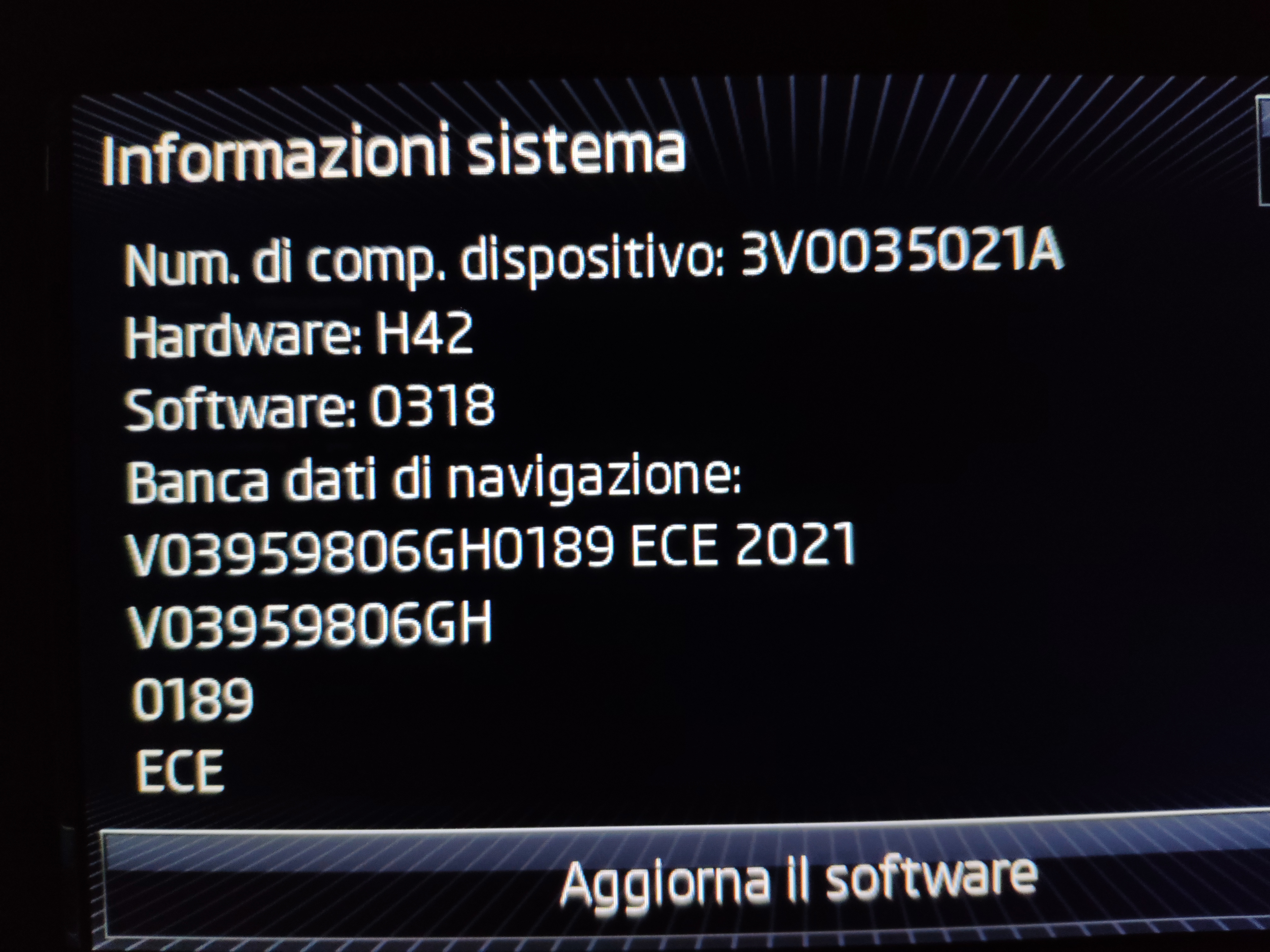

@pab567 Do you have any update available for below system
Your version is the most current I know.
