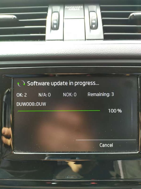

I put on a miscro sd card 128gb fat 32 formated with sd adapter in to the slot 2
and the card was locked also
Try another card, possibly max. 32GB, formatted under FAT32 with cluster size = 4096 bytes

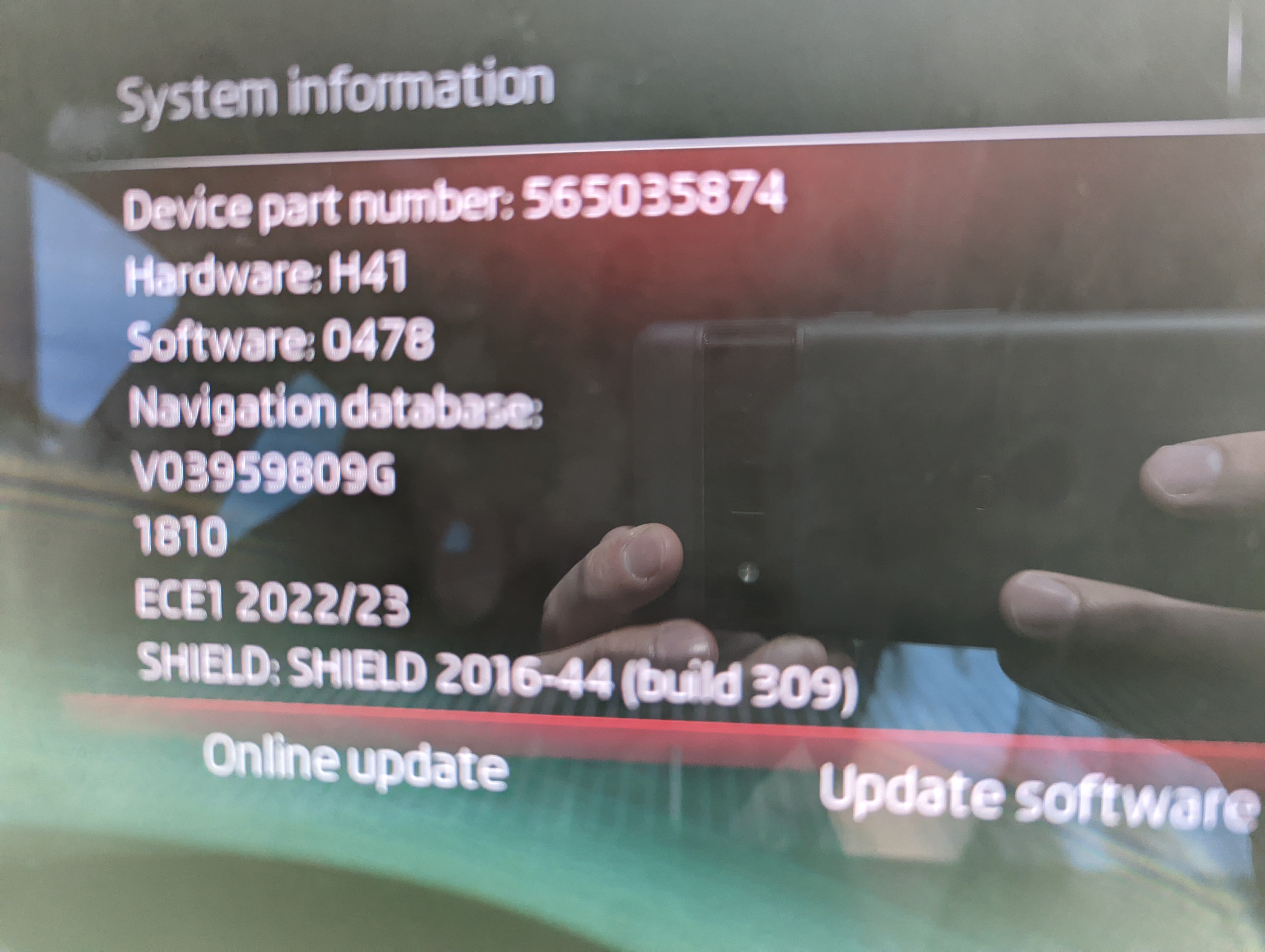

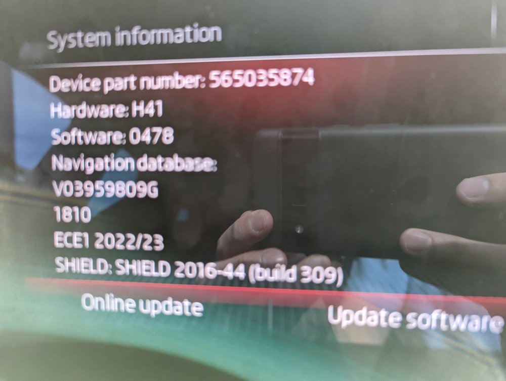

Hi @pab567
Would you be able to provide a software update for the following?
Device part number: 565035874
Hardware: H41
Software: 0478
Navigation database:
VO3959809G
1810
ECE1 2022/23
SHIELD: SHIELD 2016-44 (build 309)
Cheers
@KevSex you have download link on PM

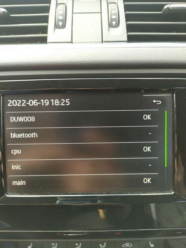

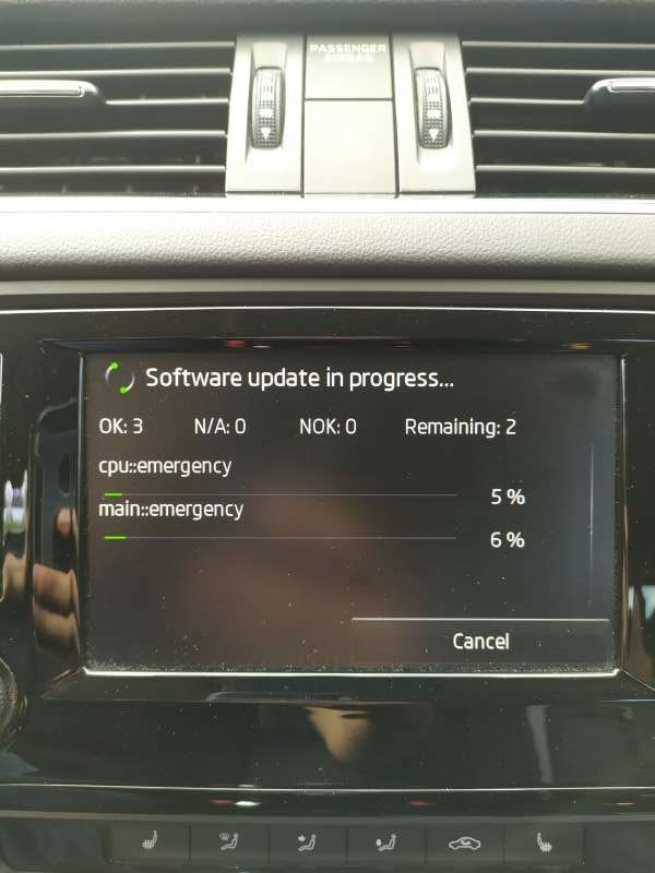

So. :) I did the following. I used an old map SD card form Skoda formatted as you told me and also I erased the  "system volume information" hidden folder that windows create not to make any confusion with the device. This time it worked out. It only updated the one that failed the first time. Many many thanks @pab567for the unselfish help and sharing the updates with us. One more short info. Any idea is its possible to activate the SmartLink . With VCDS maybe.

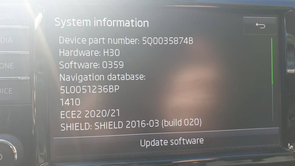

Hi @pab567
Device part number: 5Q0035874B
Hardware: H30
Software: 0359
5L0051236BP
1410
ECE2 2020/21
SHIELD: SHIELD 2016-03 (build 020)
Cheers
PM

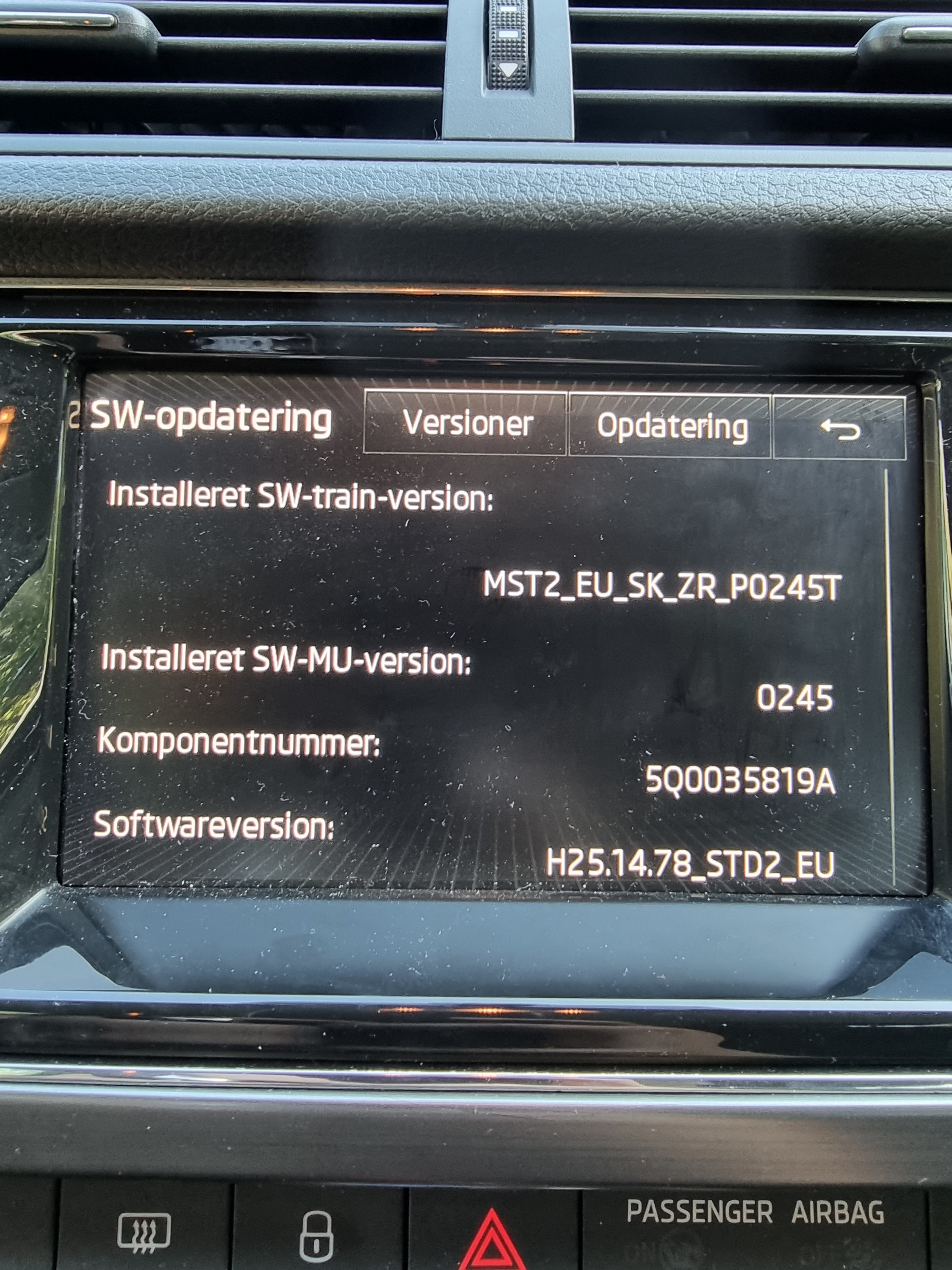

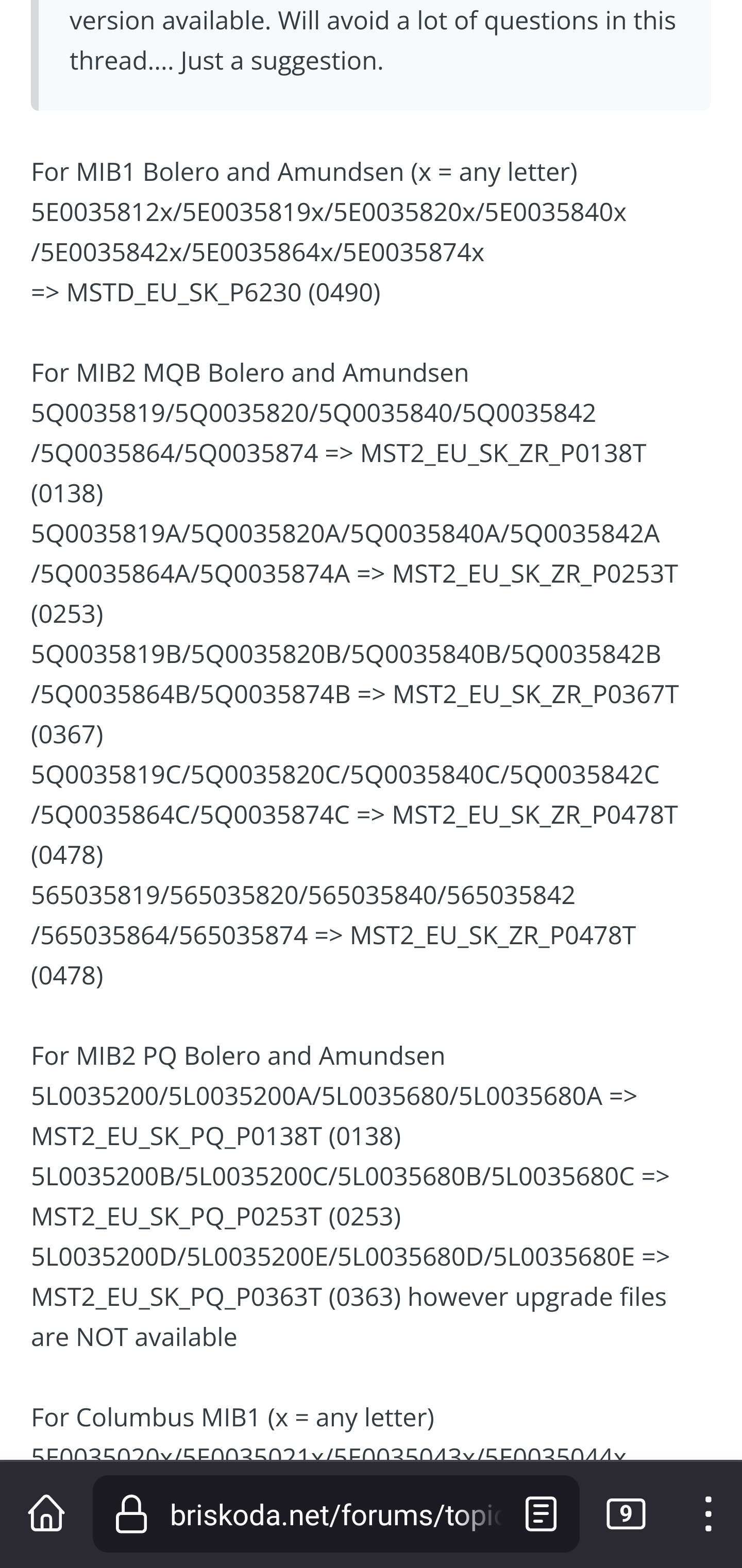

Hi @pab567 ,
According to an earlier post from you, you mention I should get the 0253 version:
Since I have component 5Q0035819A (Bolero). As far as I understand it is not possible to get either MirrorLink or SmartLink with this model. Is there any point in updating it then?
If you want to get SmartLink, rear view camera support or voice control then unit must be replaced, e.g. to 5Q0035840x (x - any letter A, B or C). If you are interested pls contact me on PM.

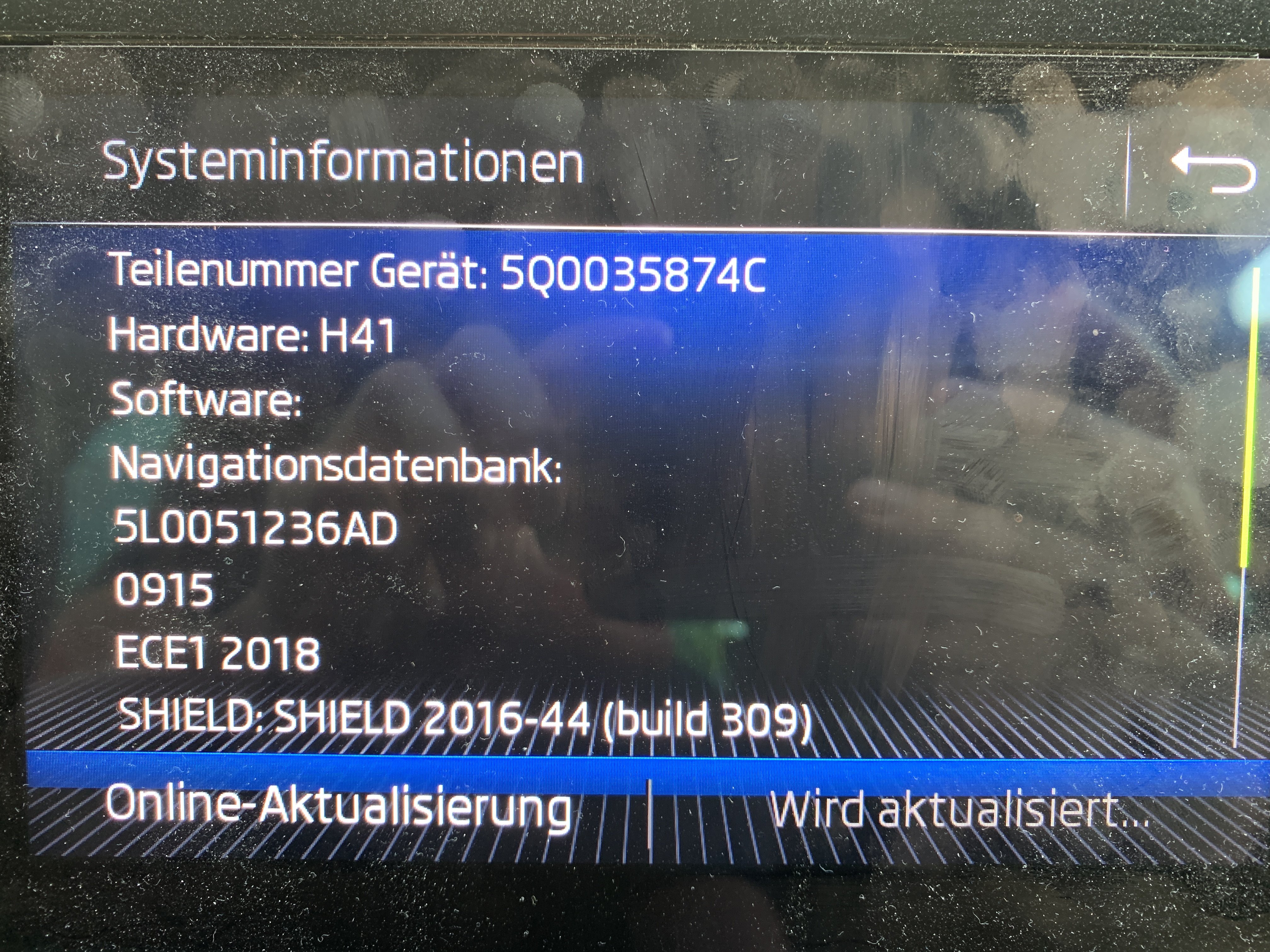

Hi @pab567
would you be able to provide a software update for the following?
Device part number: 5Q0035874c
Hardware: H41
Software:
5L0051236AD
0915
ECE1 2018
thx and cheers
Addendum: I am sure that the software version is 0478. However, it seems that this has not been displayed for some time.

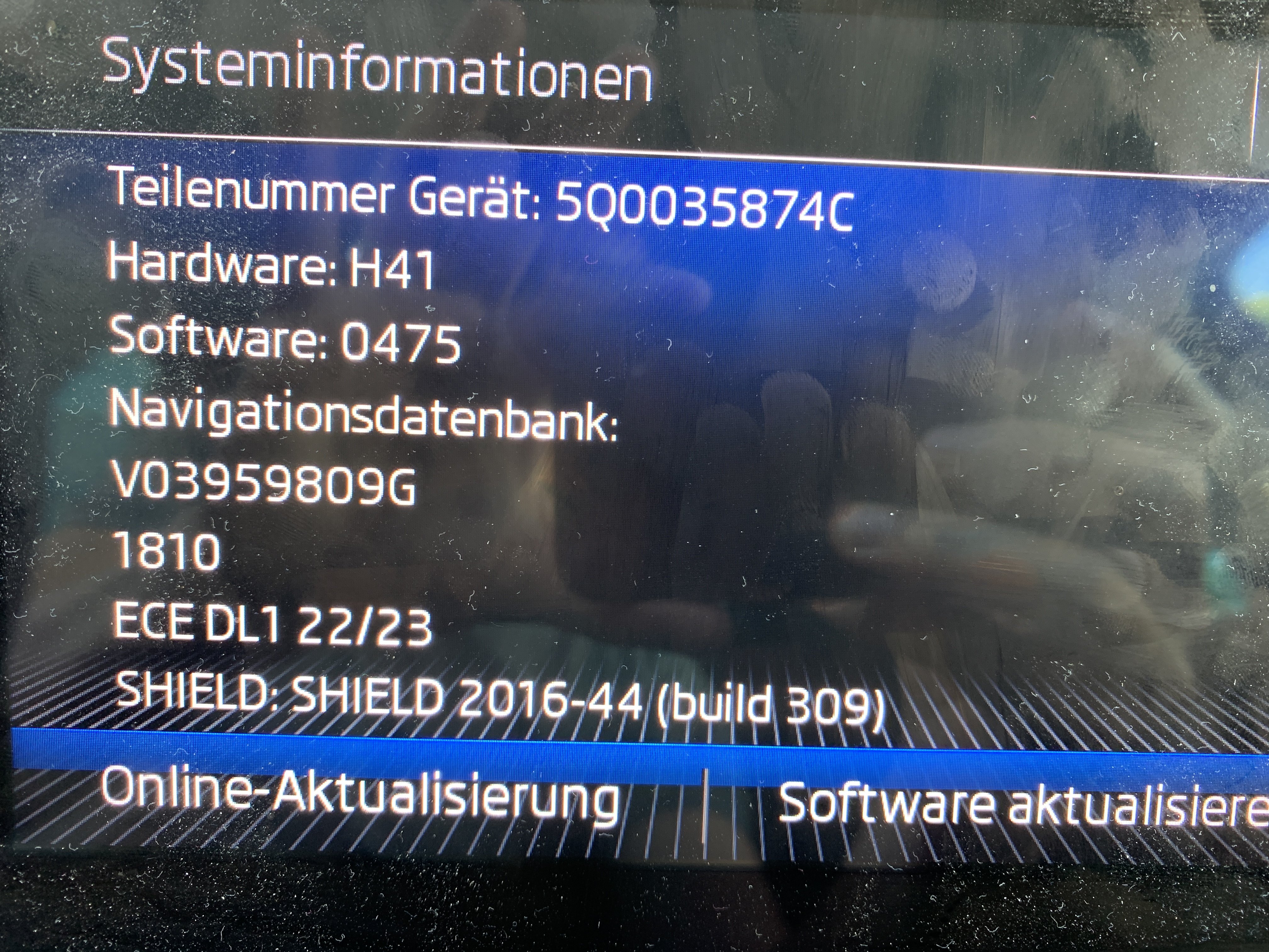

Hi @pab567
sorry for the confusion. After updating the navigation maps, the software version is now also displayed. Could you provide me with a download link to the software update for this? Thank you very much in advance.
Device part number: 5Q0035874C
Hardware: H41
Software: 0475
V03959809G
1810
ECE DL1 22/23
thx and cheers
PM
