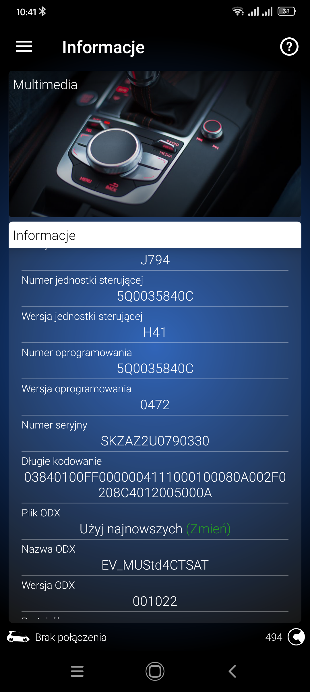

I am looking for an update to the skoda superb:
5Q0035840C
You can help ?

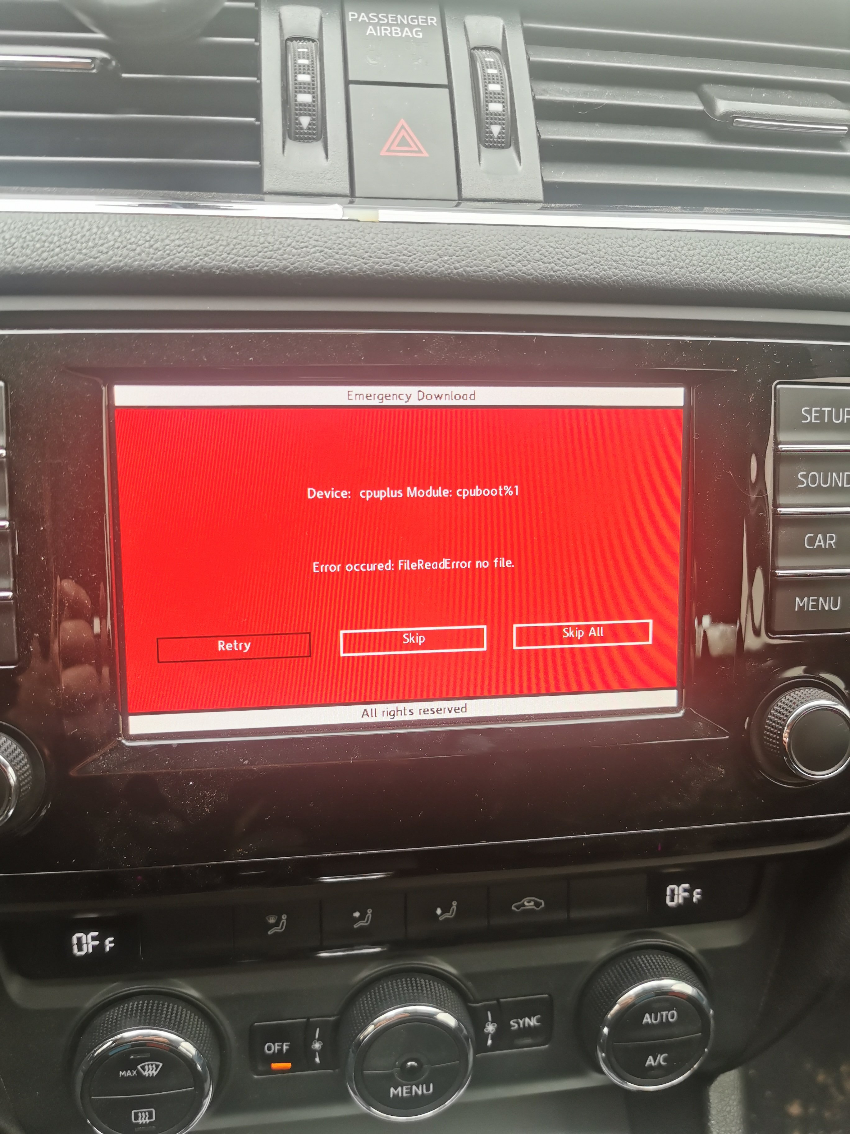

Now the tape is as seen in the picture, what should I do?
Either you have incorrectly prepared SD card with swoftware or ypour unit is broken. Try another SD card.
I think the software is not compatible.I'm attaching my device picture again, can you check?
It is compatible otherwise the update process would not start at all. As I wrote you in PM - either problem with SD card or unit itself (EMMC).
