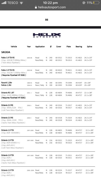

9 minutes ago, BigJase88 said:
So what one exactly is it I want for my car 1 or 2
I would go number 2 and the single mass flywheel, dual mass flywheels suck so you will need flywheel number Hf 9282
or if you want to use the dual mass flywheel you can use the top one, you will most likely need a new original flywheel though as most likely worn.
Edited by BigJase88
